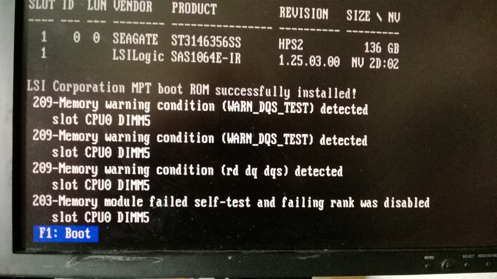

Any personal computer experts out there, who can tell me what this means? It just appeared as my machine was booting. :(

Looks as though one of your RAM modules has died. It checks them when you first turn it on, and after it's failed the test it's disabled that module. There are normally two, so until you replace it the machine will be running with half the memory. Should still work but it will be a bit slow. Easy to replace - they just clip into slots on the motherboard. if it's a laptop then there will probably be a small panel on the underside which you can remove to get at it, but if it's a desktop then you'll have to take the cover off!

Ah, thank you for that. Now, is there a clever way to tell which module has died, or do I just try swapping one and then boot up and see if the problem persists or goes?

Try by removing one
Most ram modules have a lifetime warrentee
