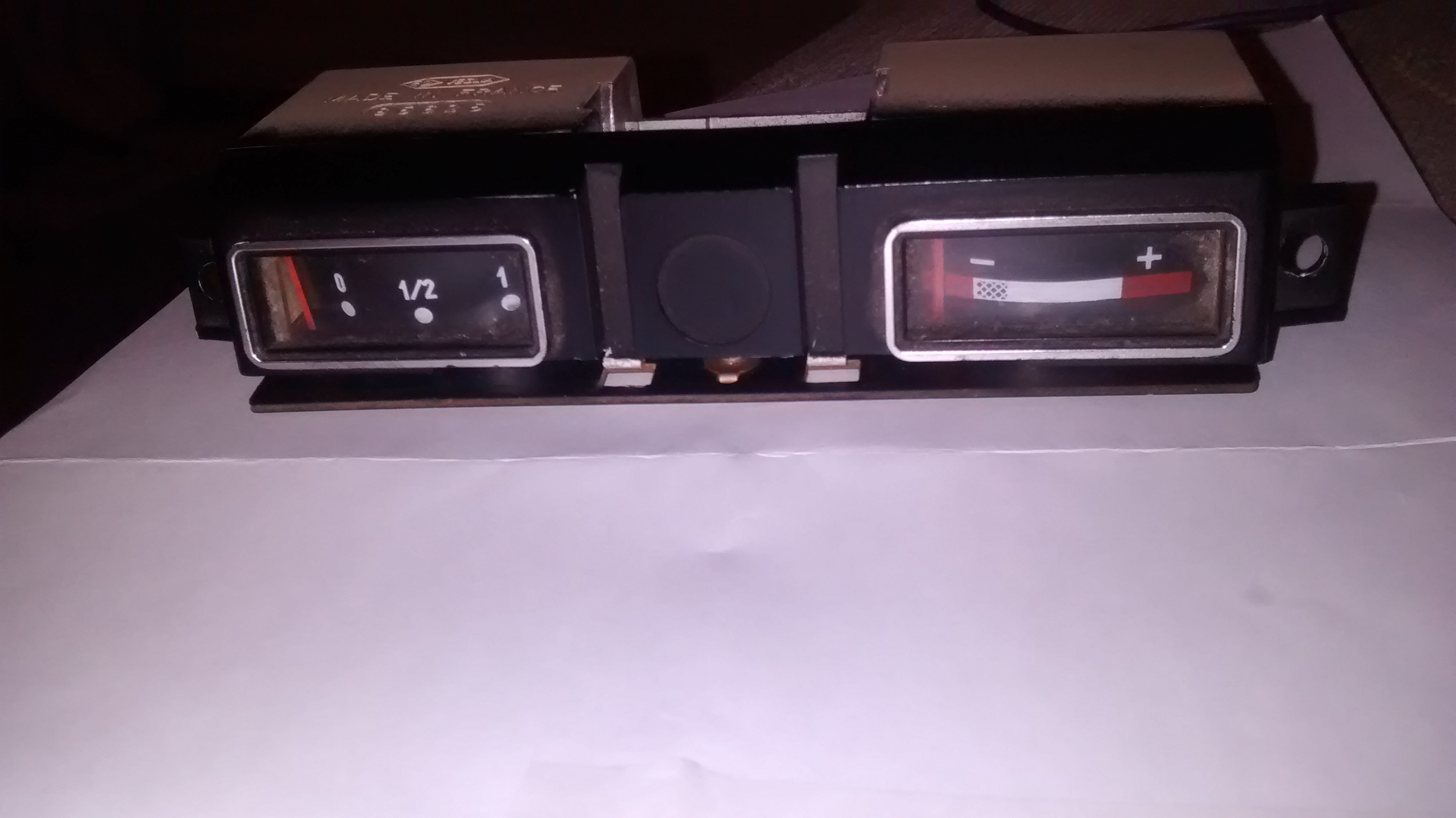

Anyone know what this fuel gauge and voltage indicator is from?
April 3rd, 2017, 11:58 pm
Doh
April 4th, 2017, 12:01 am
Definitely Dyane, m'dear. :)
April 4th, 2017, 2:27 am
Thanks Ken
Is it compatible with a 2CV senderwould anyone know where I can get the connector for it?
Cheers

Roger V wrote:
Thanks Ken
Cheers
Yes it is, and propably only way to get correct connector is from scrapped Dyane...
What I have find about senders, DS, CX, GS, SM, BX and Xantia have same type on fuel/temp gauges/senders. I have had succesful installing over 15 years on my Dyane, original fuel sender with BX gauge, and when I examined that we had plenty of scrapped cars to have gauges/senders to measure/test...

Thanks Jasu
It will save me a lot of fuses if I could get an idea of what connects to which pins. Supply, sender and negative rather than colours if possible.
