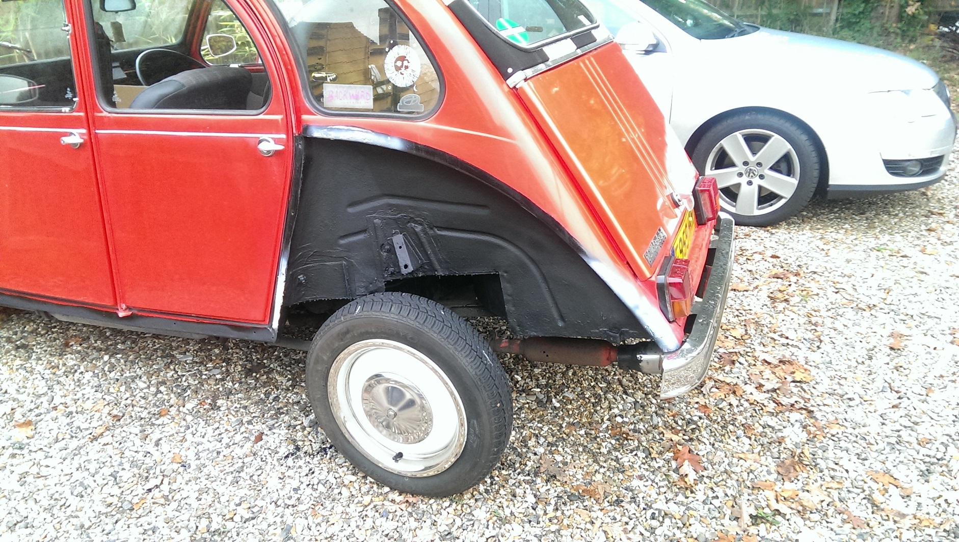

Coming on. Three coats of POR15 and now a stonechip coat. Also sprayed under the boot floor and stuff as the old coating was drying out a bit. Looking good underneath though actually.
Feeling a bit more positive about rust now! The hole under the quarter light window is preliminarily filled, and the top of the B pillar too. Quite keen to see how good I can get the finish on these - did some rattle can repairs on another car last year and they were the best yet, so I'm hoping to improve on that with what I've learnt. (Which is still very basic!)
Do wish I'd done this before though, it was direly in need, poor little thing.
