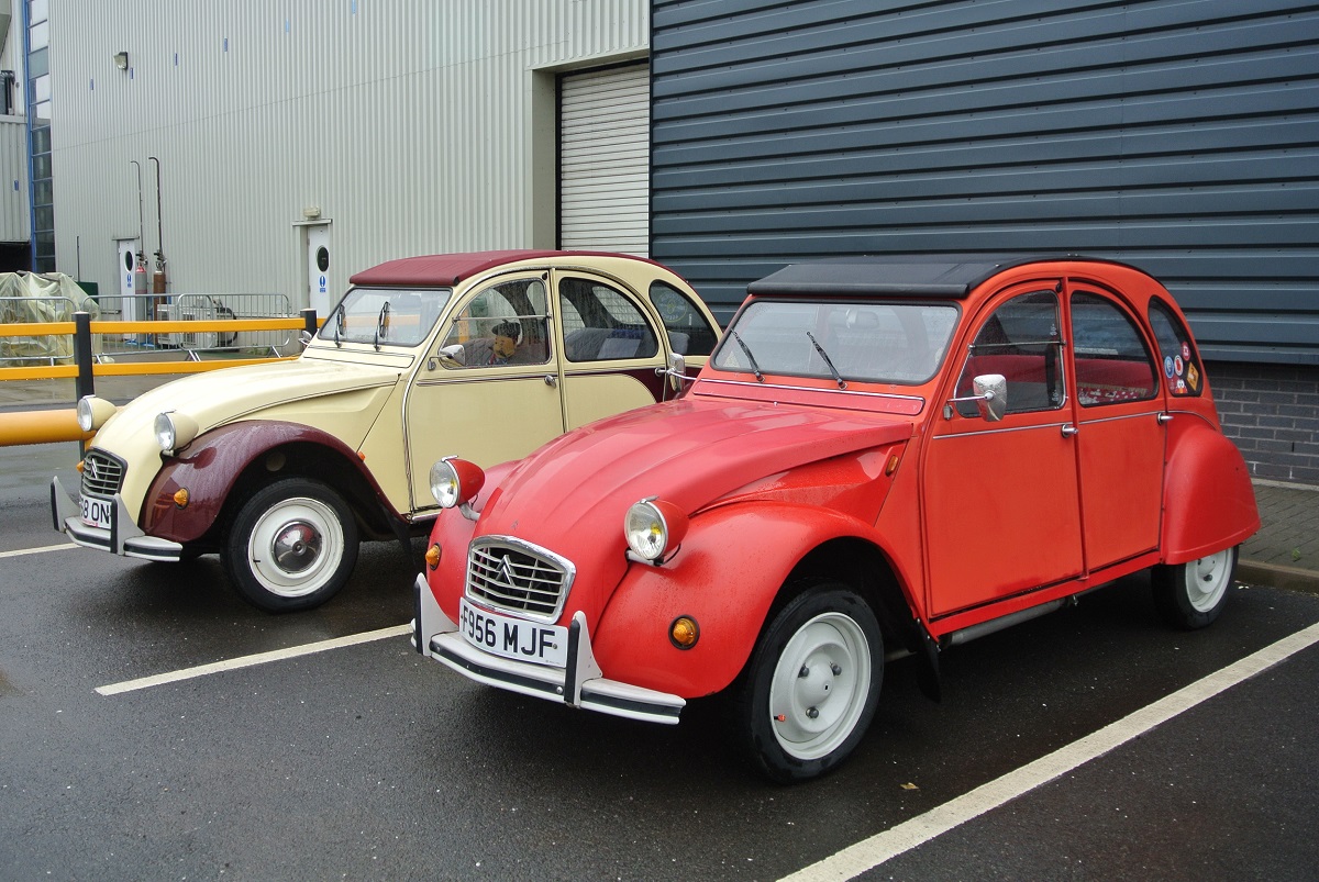

Was displaying my 2CV at the Cummins diesel engine plant in Daventry. Cosette made a friend too 8-)
