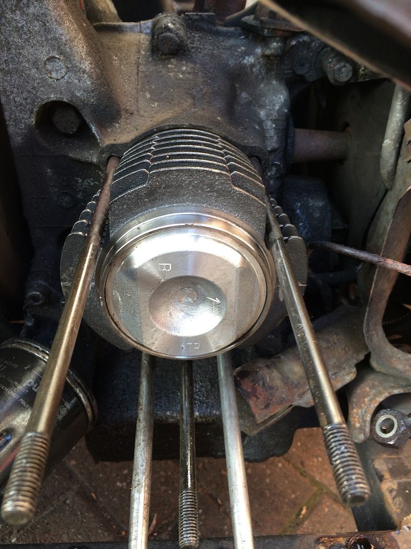

Fitted one of the big bores this evening......

Me too seeing as it's £300 or so - bastard gudgeon pin clips are real fuckers to get in as they really need circlip pliers which of course I don't have.....
