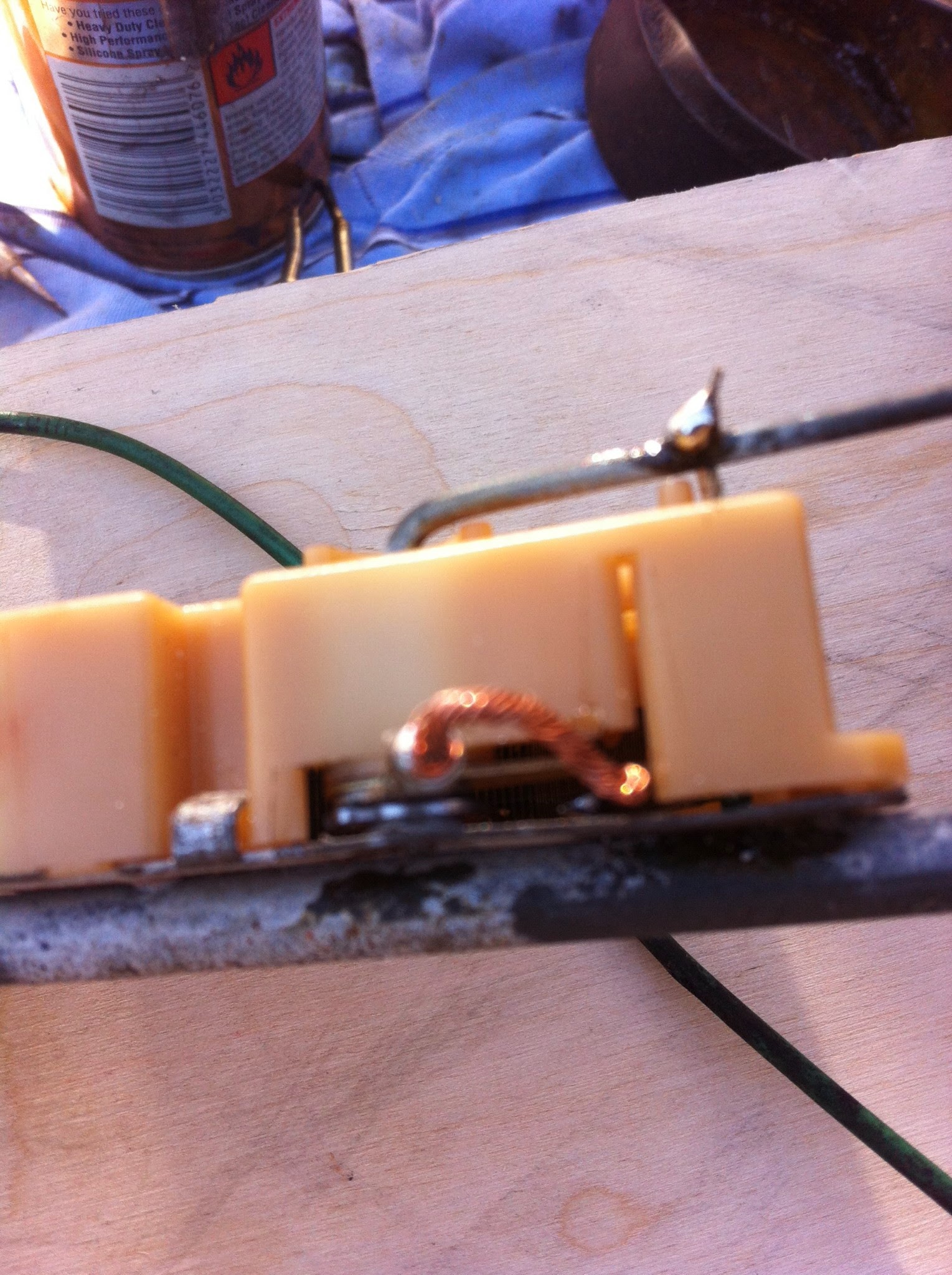

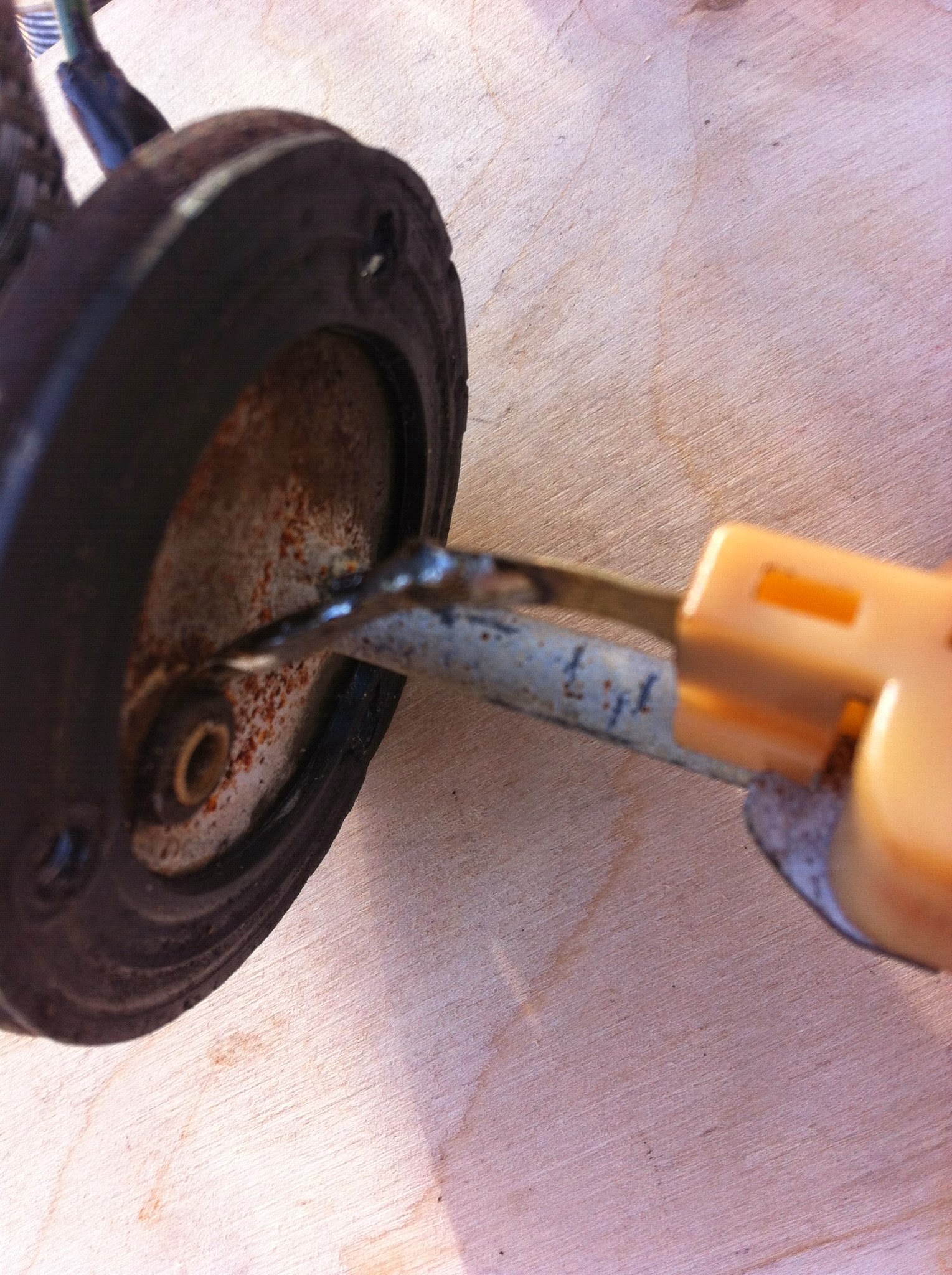

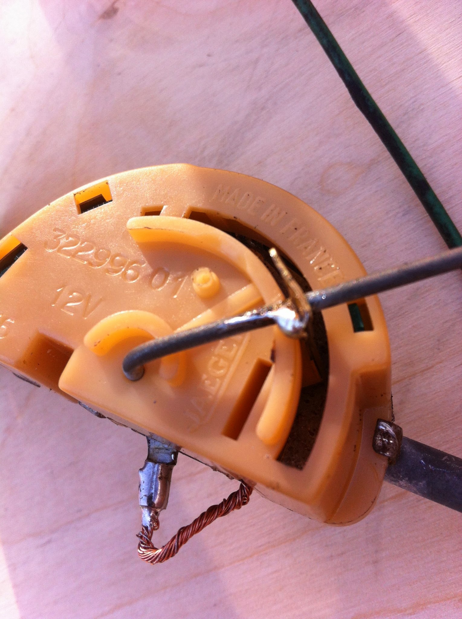

Fixed my dead fuel gauge, which has been giving random readings got sometime. The gauge responded to the short yo earth, so l knew that was OK. I dropped tank and removed the sender unit. A quick test with my multi-meter showed no response at all.
I noted the connection to earth was a crimped joint, this was iffy do l soldered in a small piece of thin copper to ensure the joint was good.
Then opened up opened up the business end of the unit, the wiper arm was worn away to s hole, another thin bit of copper was soldered in there. The resistance changed smoothly,when tested with the probes on the wiper arm and the connection to the gauge feed, but there was no continuity from the earth tag. I took a much closer look at inside the sender, where saw a small piece of brass riveted to the metal body, it was obvious gist something had broken off and due to it's location I was sure it must have completed the connection from the wiper arm to earth. l soldered a short light of stripped wire to a screw type connector and the other end to the riveted brass. The connector tag as then placed under the float pivot do making the circuit, to ensure good continuity l soldered the float arm to where it clipped on the wiper arm.
The result is now a fully working fuel gauge, which swings nicely to and fro for a short time when you stop, as the fuel sloshes about. The repair might not look pretty but it works fine. Oddly as l was clearing up l found a 'C' shaped bit of brass that had broken off from the sender.
