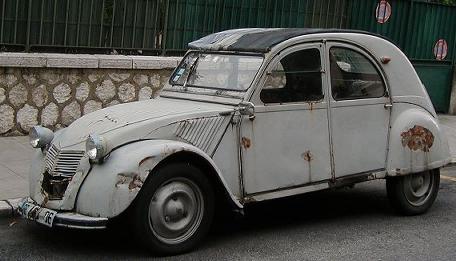

On the wheels thing, didn't very early 2cv's have four very slight slots between the centre and the rim (I guess corresponding to four welded areas on the other side)? Also I'm pretty sure that they had no centre bolt hole.

Wheels with 4 subtle slots... so it seems I didn't imagine them.
Yep, they're the 400mm wheels.
