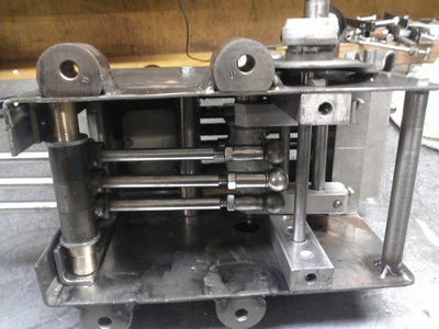

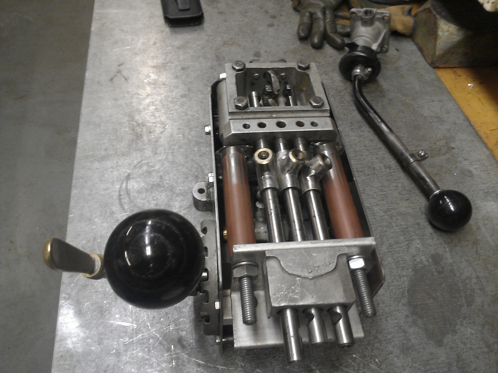

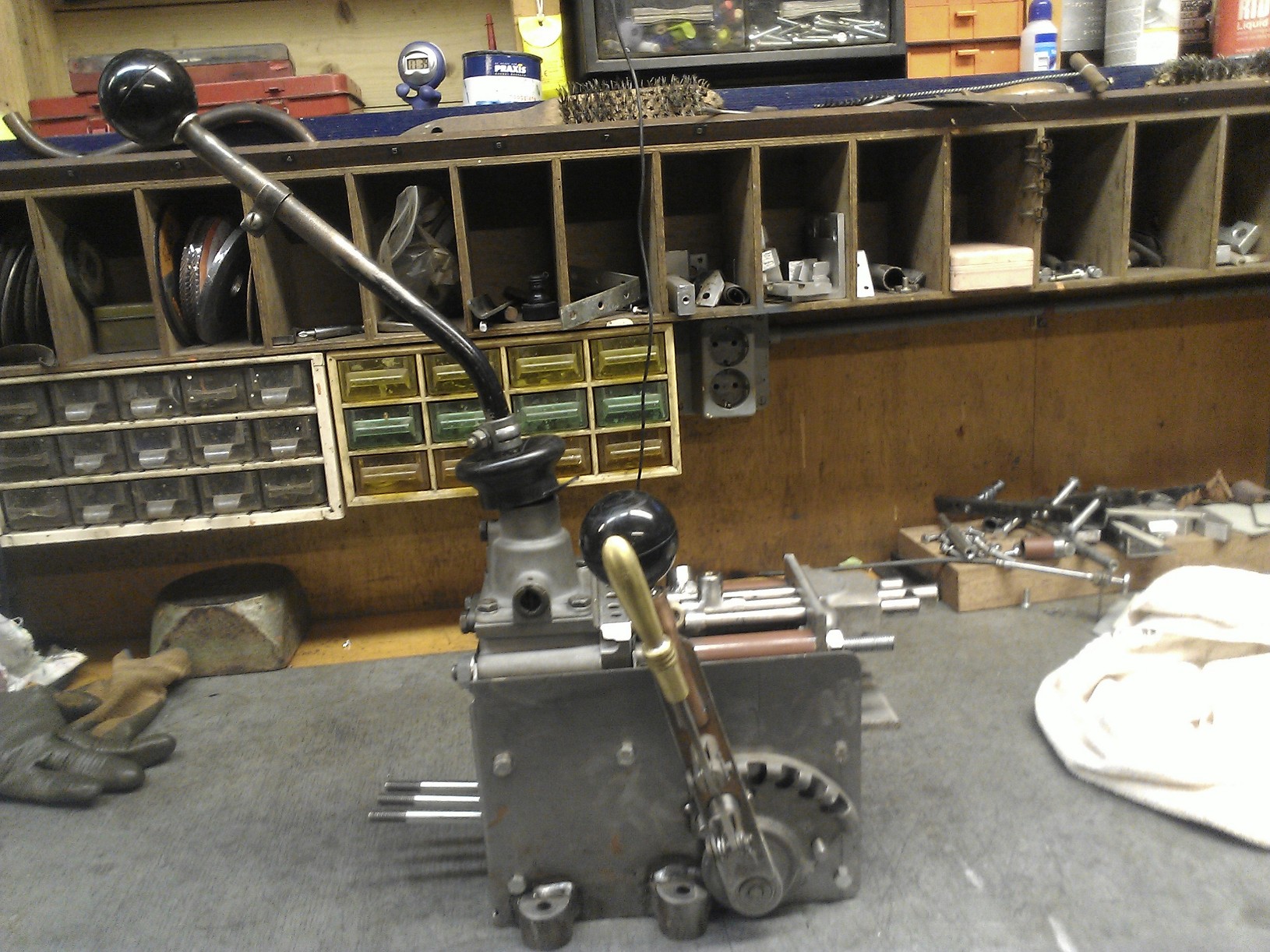

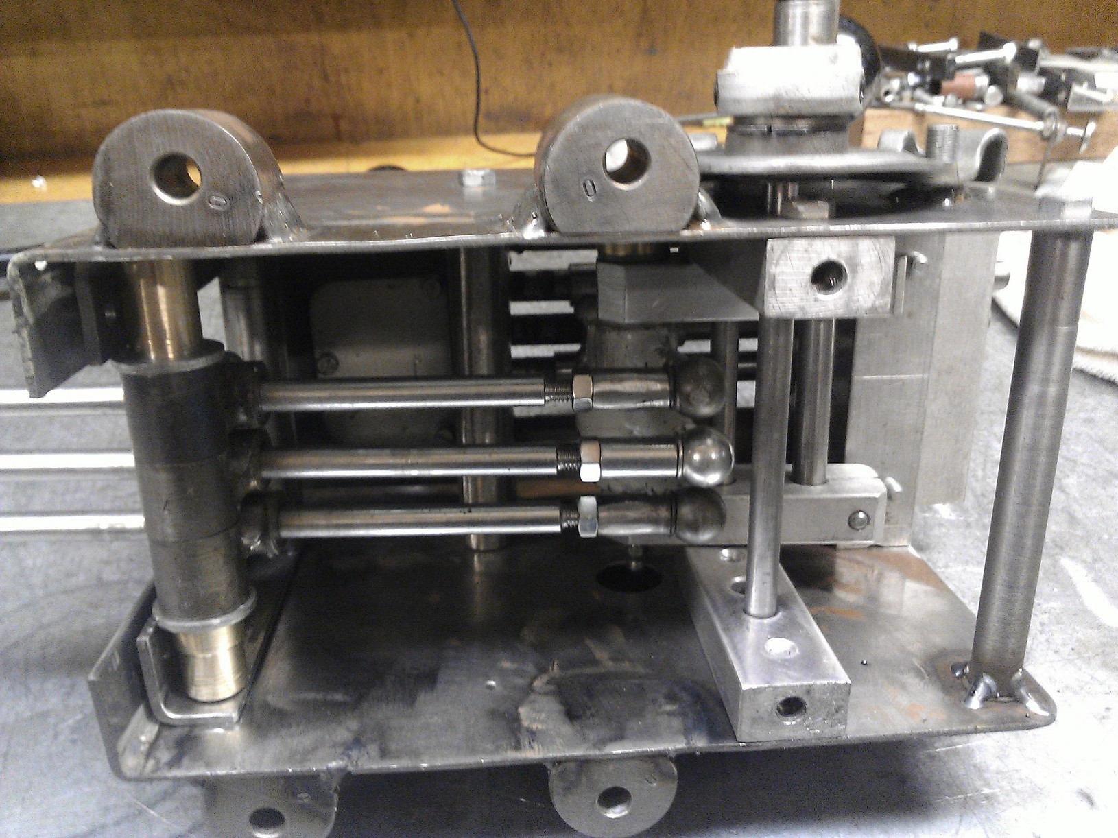

For the moment a gearbox with reverse differential is realised for the rear engine and a kind of gear to shift only the front gearbox or shift the rear and front gearbox.

That looks good, I would like to create a Sahara 602 but not sure I have the engineering ability. I see the gear lever turret is old 2cv... Is it using the shift rods from a 2cv gearbox? I presume the lever on the right hand side of the box brings the rear shift rods into play? Why do you need all the stop positions on that lever?

Hello, I have not special machines to make things, so i search in the scrap for things. So is the lever in fact a lever from a lawn mower to lift the wheels to adjust the height.
I used the rods of an old gearbox. My first attempt failed, because the rods were not lined up.

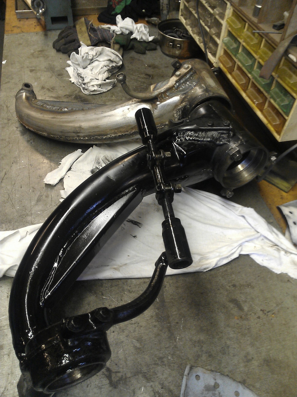

Thanks for support. Prototype rearaxles are also ready.
