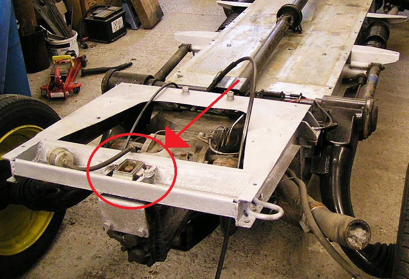

Hi, I have a question, does anyone know what rubber mounting is used on the rear of the rear box in a Louis Barber 4x4 mine has gone a bit perished, I have ordered standard type engine front mounts for the front of the back box, but I don't know the origin of the rear one..

I know that mr. Barbour uses a lot of mountings from Landrover, so I guess it will be used here too.. Can you make a foto and post it here...

Seen in circle

Pretty sure thats from a Peugeot, does it need replacing?.
On my version (2003) I have 2 mounts and they are fine, the front ones have been done a few times as they shear into two parts.

From LB
Rear single mount is probably from an AX gearbox top mount
later versions use Saxo gearbox top mount
