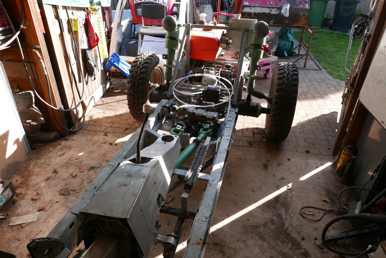

Rear Diff now rotates in the correct direction!

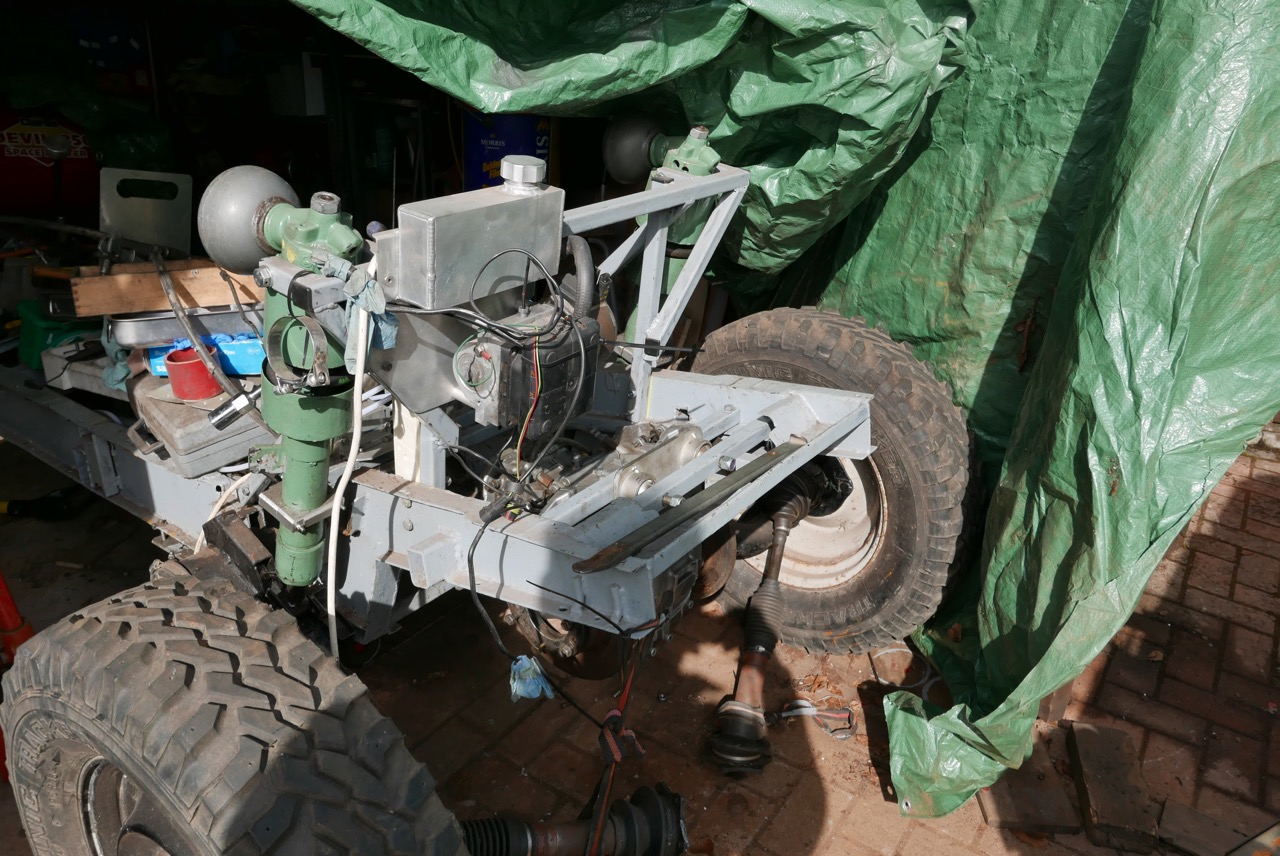

Fitted in chassis ... now just a few bolts, pipes, drive shafts and prop shaft to attach.

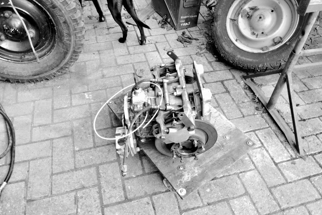

Rear End.
Transfer Box and shafts

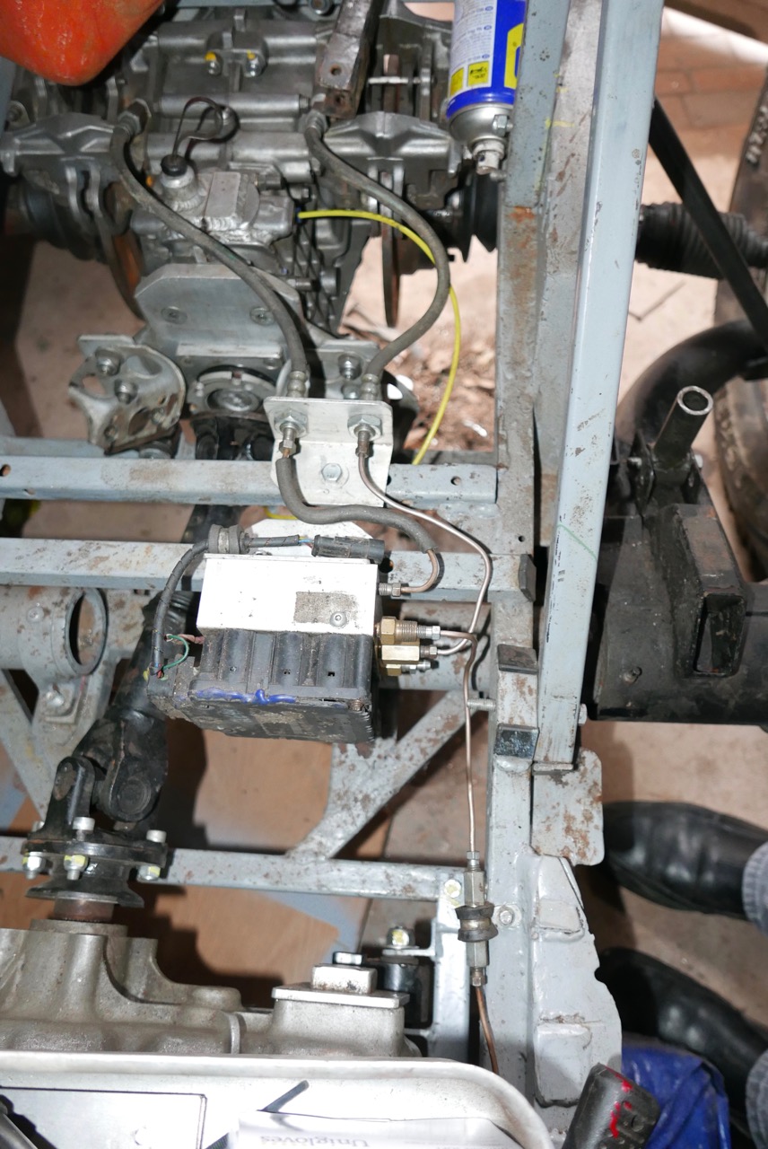

Rear Disc Brakes Line Lock.
Allows the rear brakes to be locked on as a pair or individually.
Push the brake pedal and switch the valves closed, remove foot from pedal, Rear bakes held on.
Adapted from Citroen Xantia ABS unit.

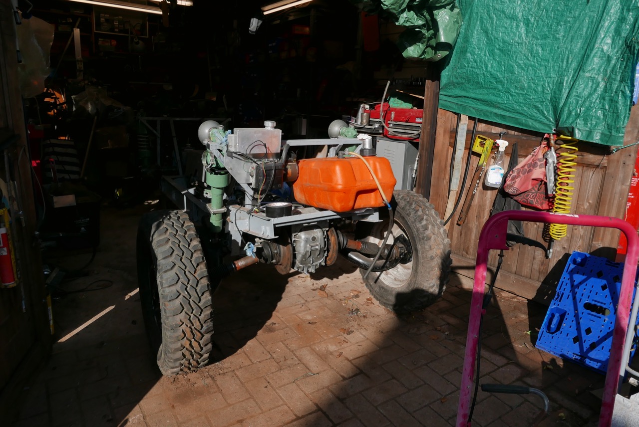

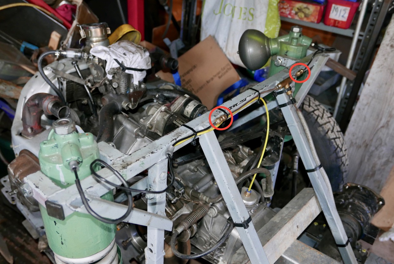

Front Struts Plumbing.
Used Brass (Imperial Size) compression to connect the pipes, hope they withstand the 62Bar.
This time, plan on only having one pump for both the front and rear struts.

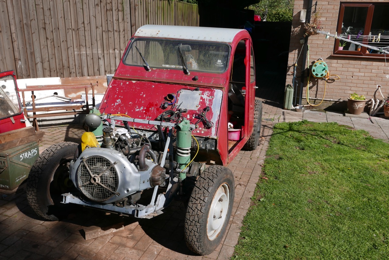

Body meets Chassis !!
