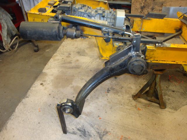

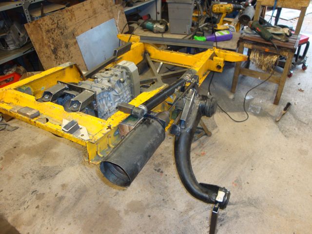

Bit more progress.....
Inverted Spring and Shocks. Better ground clearance but the C of G raised a bit.
Tried inverting the rear arms (swapped over L->R and R->L), but drive-shaft fouls the arm.
So I have fabricated my own mounts, with the arms the correct way up.
For the moment have left the brackets for the standard suspension in place.

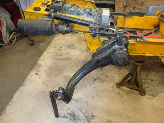

Future Upgrade to allow height adjusment.
Annotation shows room for either Air or Hydraulic suspension??
However "Air suspension" with mud and water may not be a good mix.
