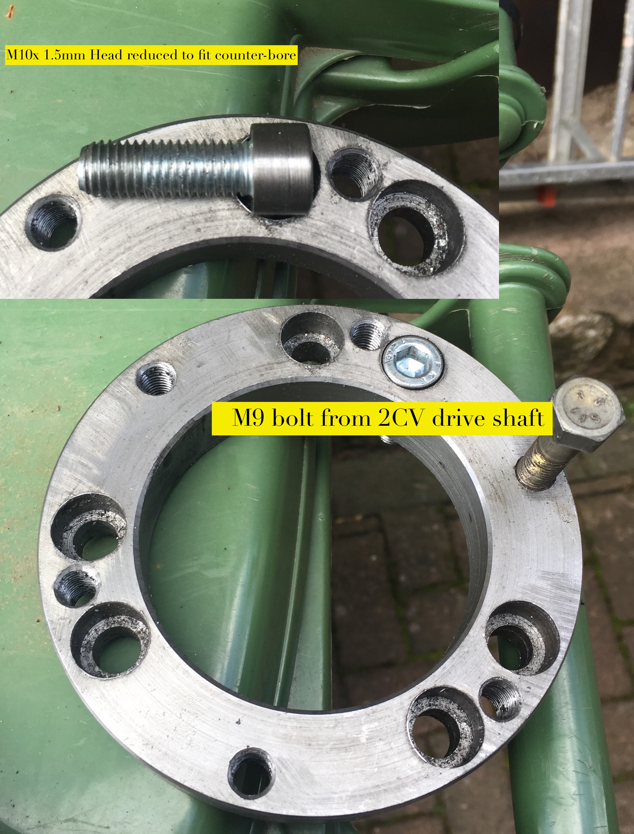

For AZS
Drive Shaft Adaptors

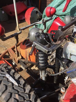

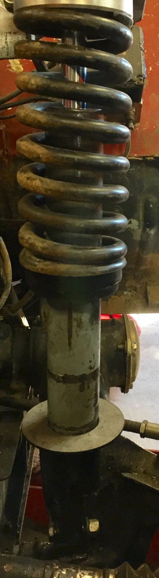

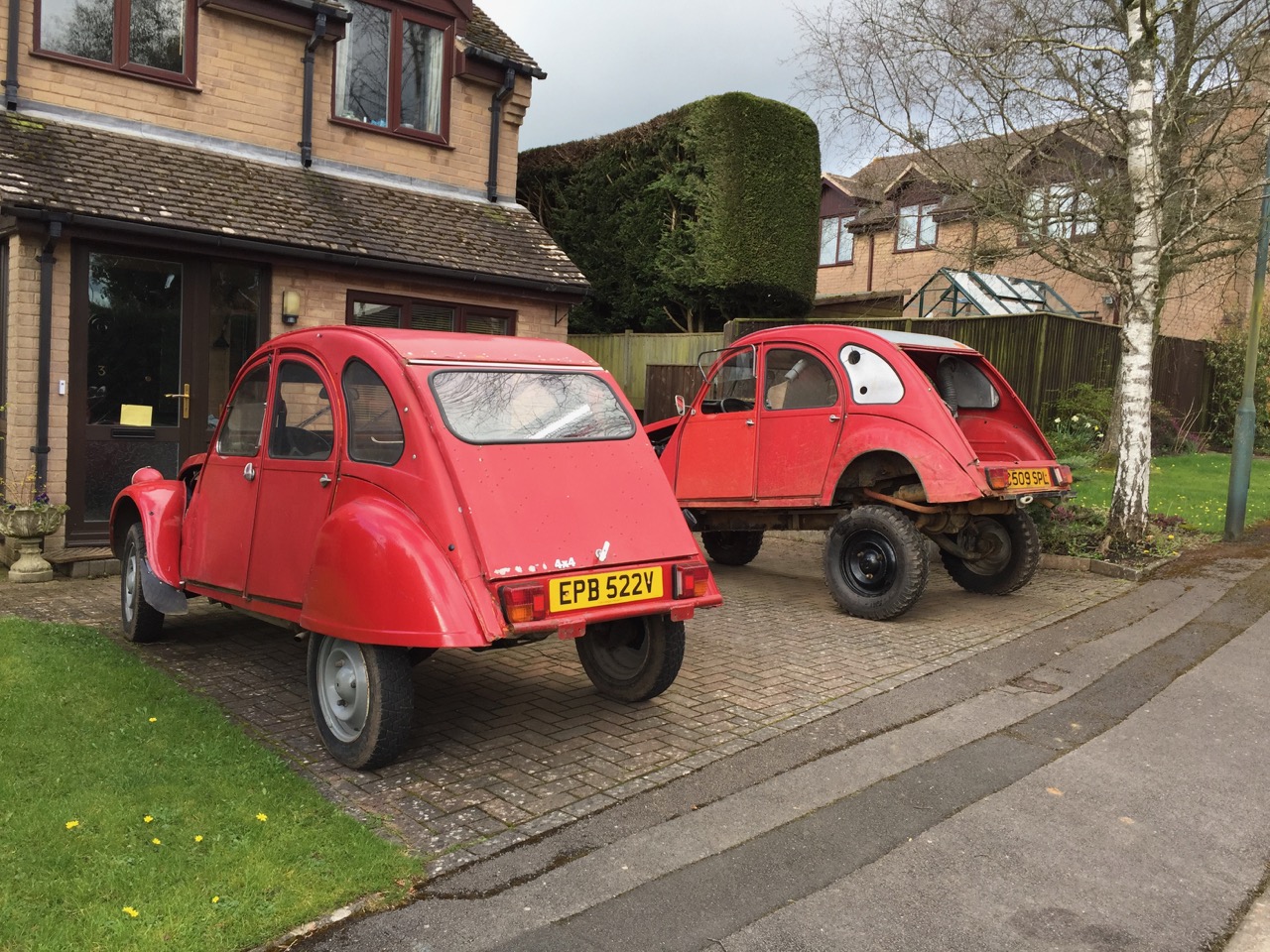

Modified the C5 struts to allow fitment of a coil spring, so that the static ride height is set without the need of the LDS part of the strut
Did a calculation for the spring and it is far to soft :( :(
The spring sits have way along the arm so 400 lbs/" ??? would be far better than 240lbs/" :(

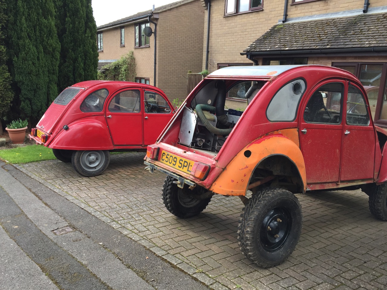

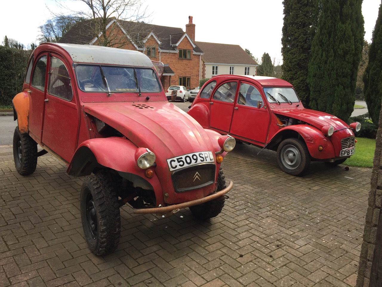

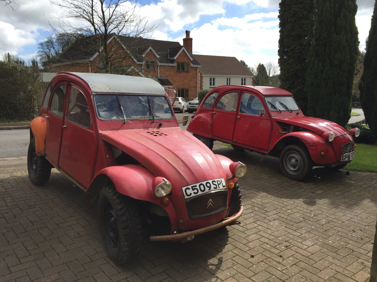

Almost ready to go to Morvan :D

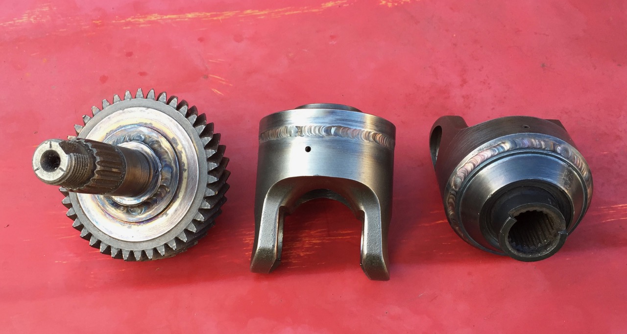

Prop Shaft couplings and Transfer-Gear with quality TIG welding by Martin at MTech Ltd.

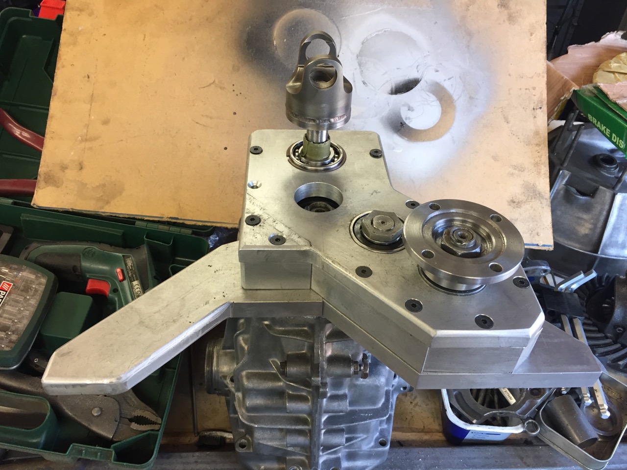

Assembled the main parts, ALL rotates without problems :shock:
Need shim washers etc etc and finish the back-plate.

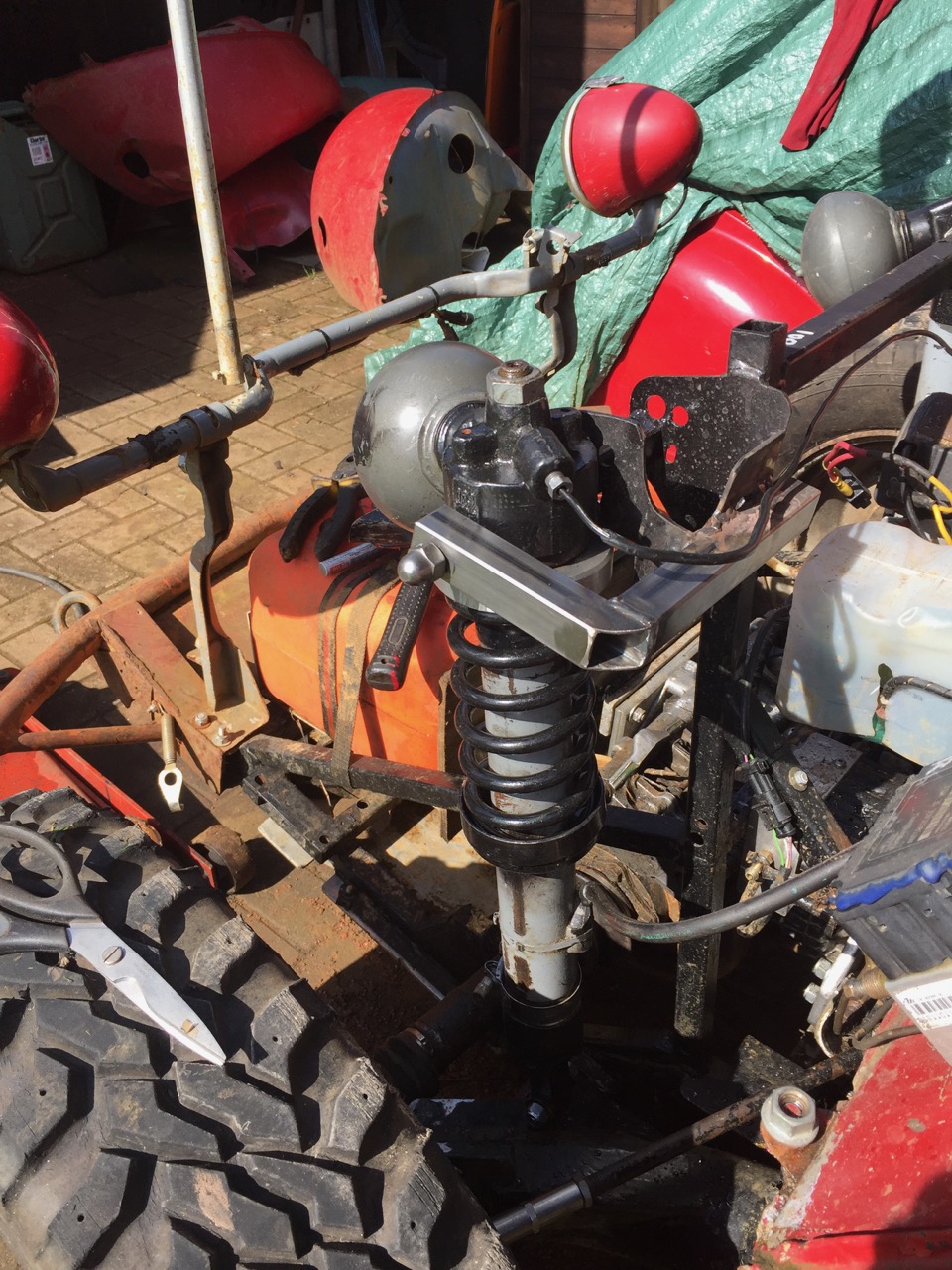

Springs, Springs and more Springs.
Found some soft front 2cv springs, fitted as Coil-Over they seem to be about right.
Just need to fabricate a stronger top mount :oops:
