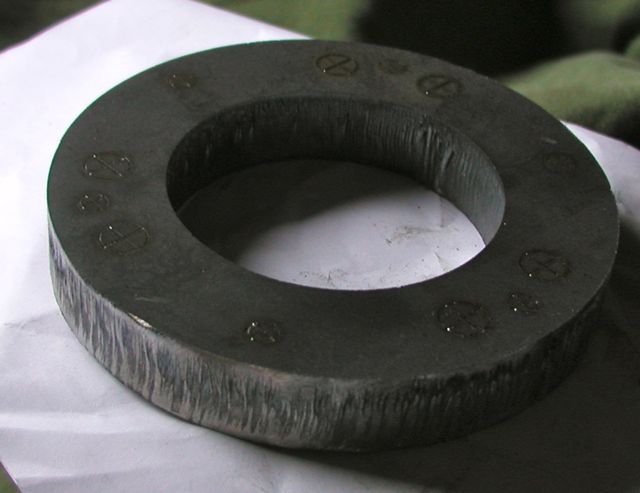

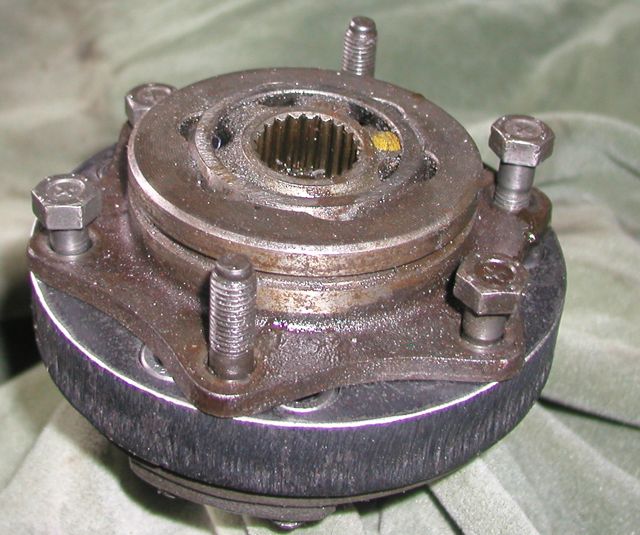

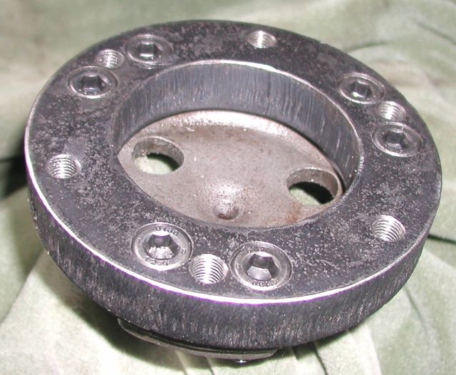

Having waited 3 months for a local macine shop to make some drive shaft adapters for the rear gear box , I embarked on making my own, using the front ones for dimensions.
Used QCAD to make a drawing.
Laser Cut or Water Jet ?
Laser cheaper whereas Water Jet is more accurate and can do small holes but expensive.
Opted for Laser with the hole positions marked up.
Use a sharp centre-punch and an eye glass for accuracy, to mark out the centre-points for drilling.
Hours with the drill press/9mm and 10mm taps....
Blank Laser Cut
Used 10mm Hex nut onto Gearbox flange.
Fitted 2CV Inner flange.
It all fits together :o
