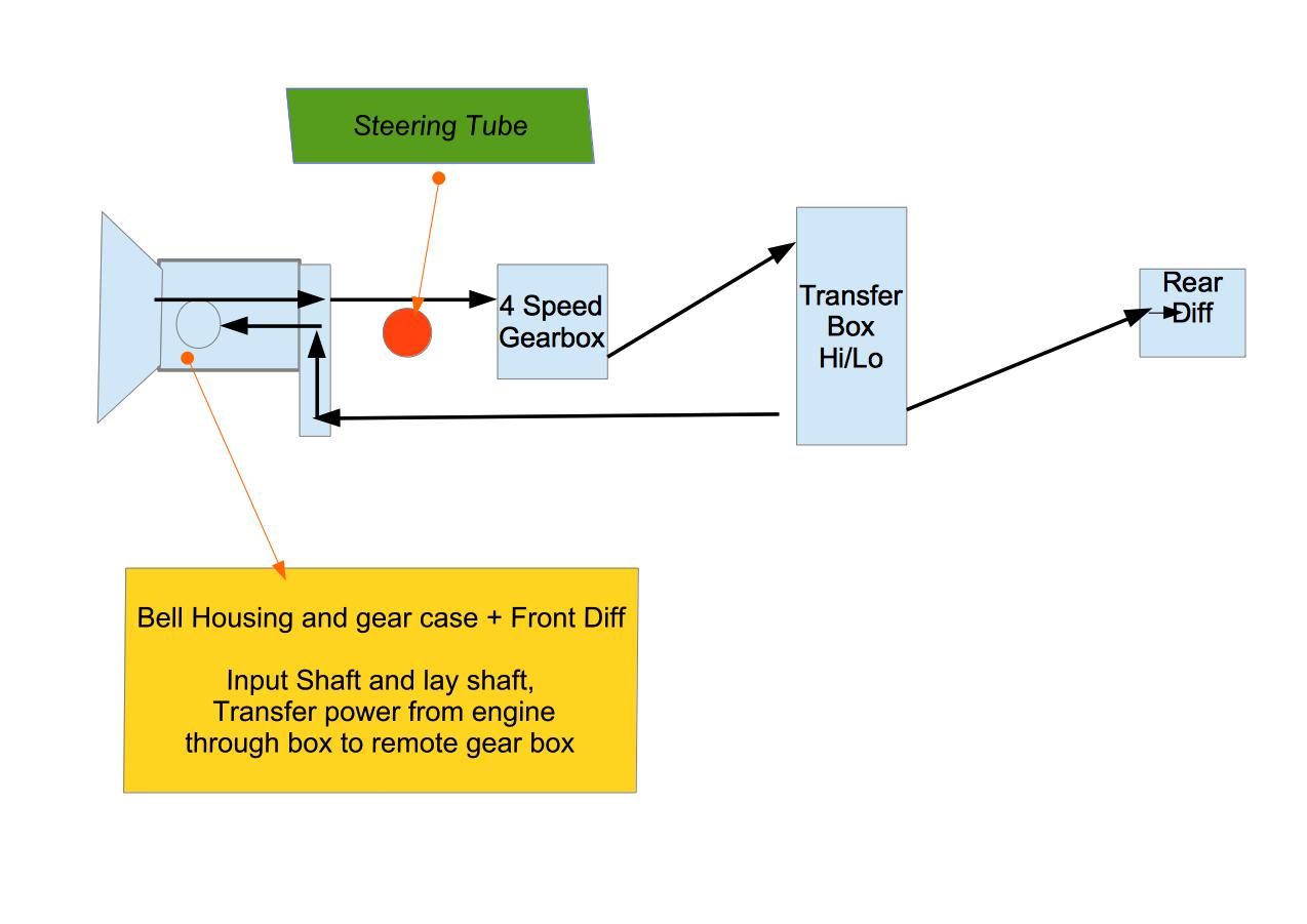

OK guys here you go with the latest madness.
Front box with diff and shafts could be made from 2CV gearbox or GS.
Rear Diff could be made from a 2CV box or GS.
The remote 4 speed box made from GS 5 speed box, however this could be made from a 2CV box if there is a reliable method of putting an output flange on the pinion??

yup. This works for me...

Pete: You could also have 1-2-3 -speeds on "first gearbox", if you want. And about flange to pinion shaft, maybe the best way is to shorten the case like you did on your diff case..?
