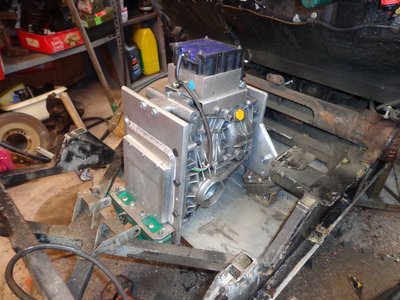

Test Fit Number 1.

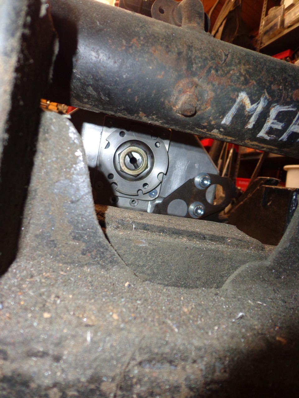

View under steering cross tube.

Fitted revised Transfer box with lower ratios it also site 2.5cm lower in the chassis.

Fitted new front diff good clearance for prop shft under the axle cross-tube.
See https://youtu.be/2Rxk4ZqeImI
September 10th, 2016, 11:52 am
