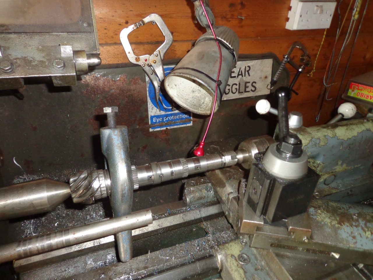

Machining the Pinion Shaft, reduce diameter to fit the new bearing and cutting a new thread M24 x1.5 on the shaft end. Will then cut of the extra bit...

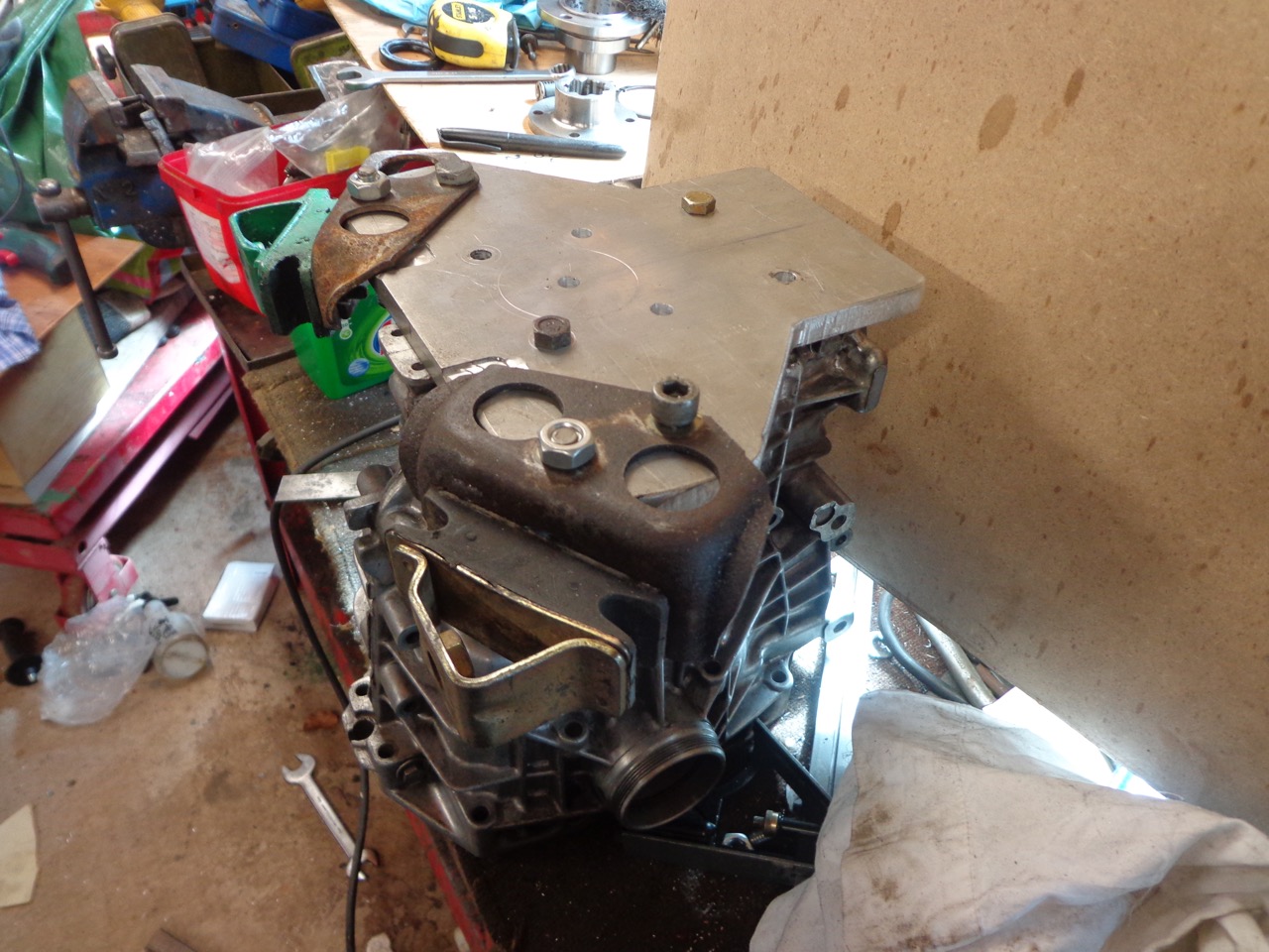

Progress with the Stumpy diff.

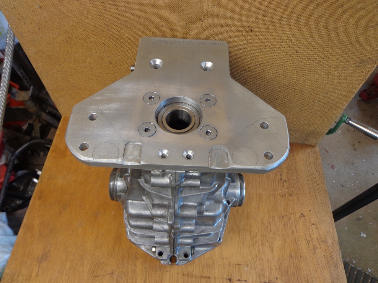

Back Plate with mountings.

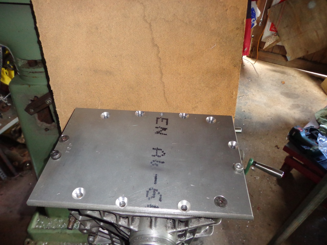

Back Plate.

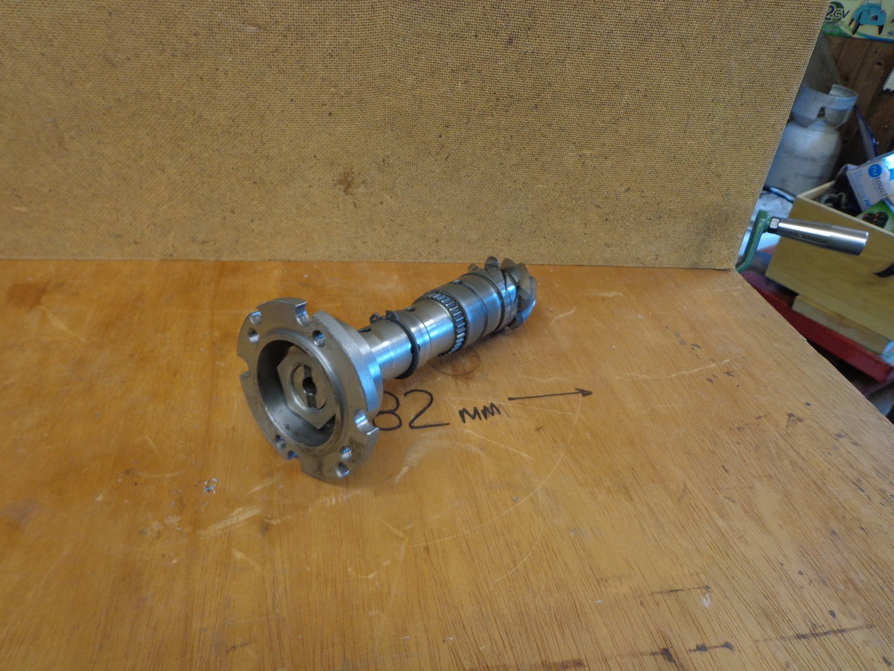

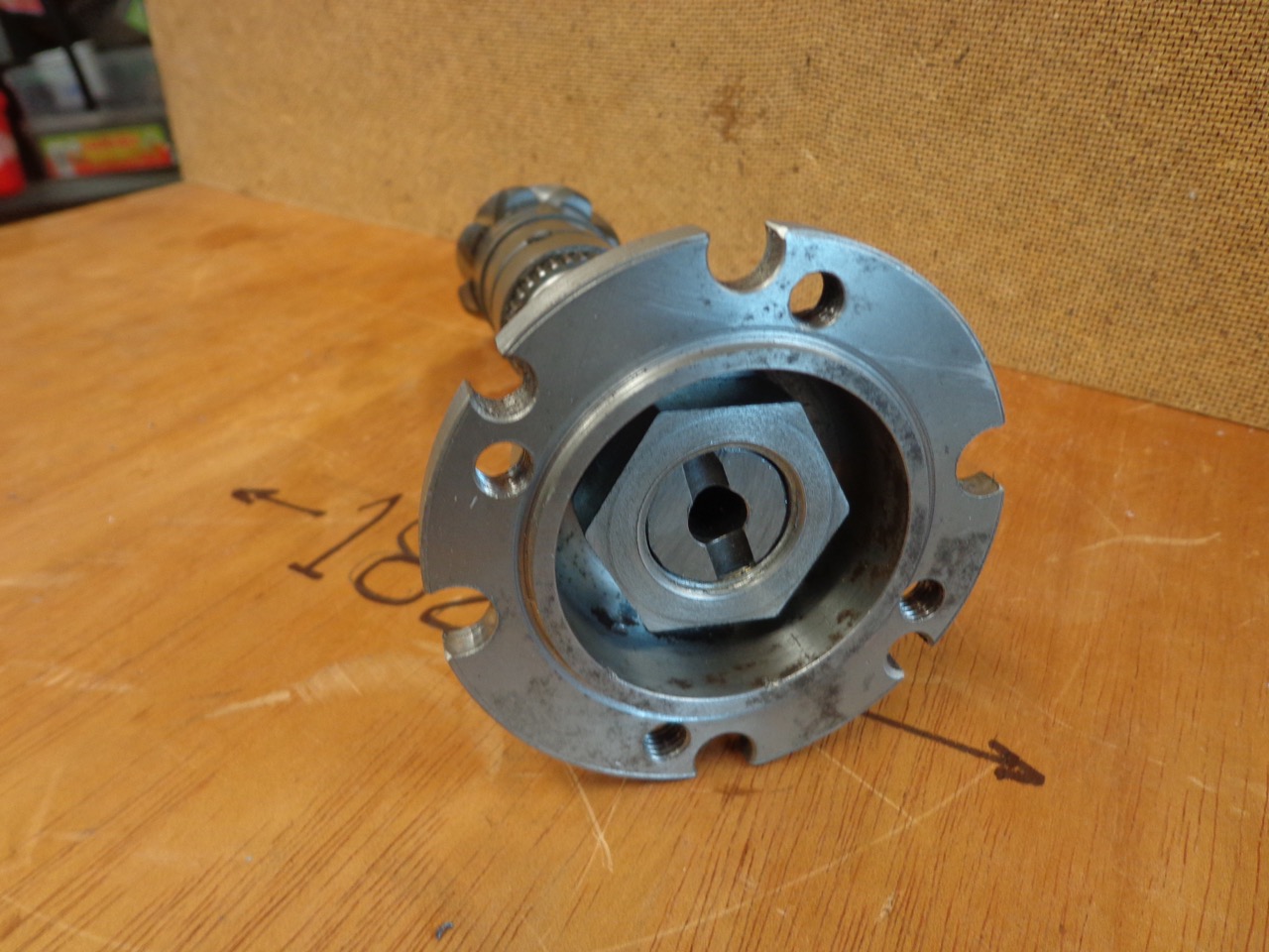

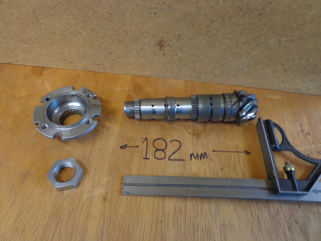

Pinion shaft.
Flange is from a LR and the splines seem?? to be a good fit.

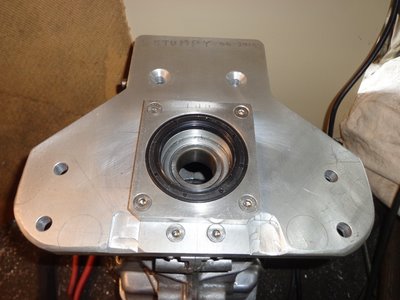

Completed the back end of the diff.

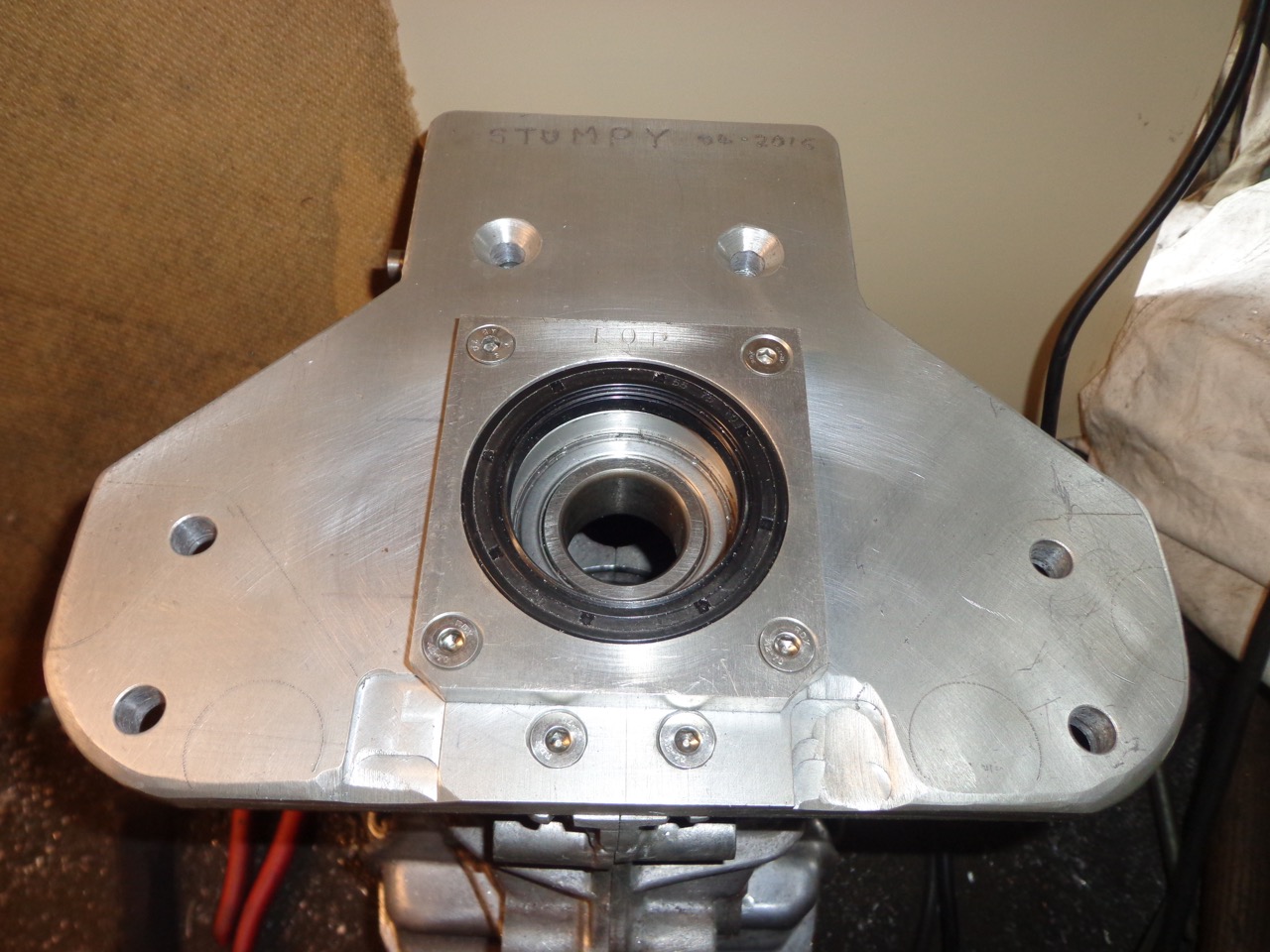

Rear Oil Seal mount

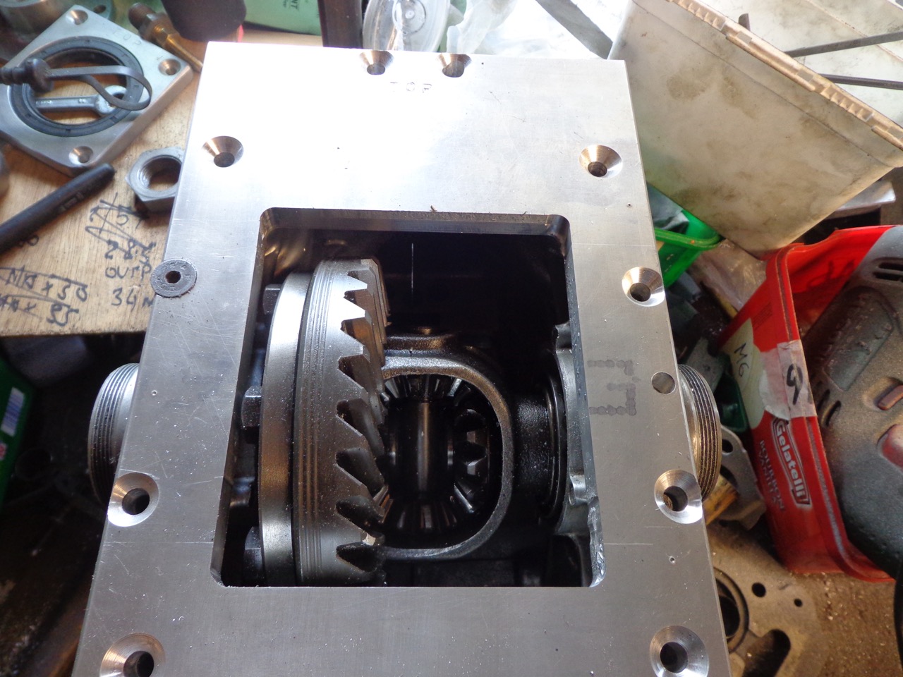

Started the front end ...

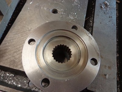

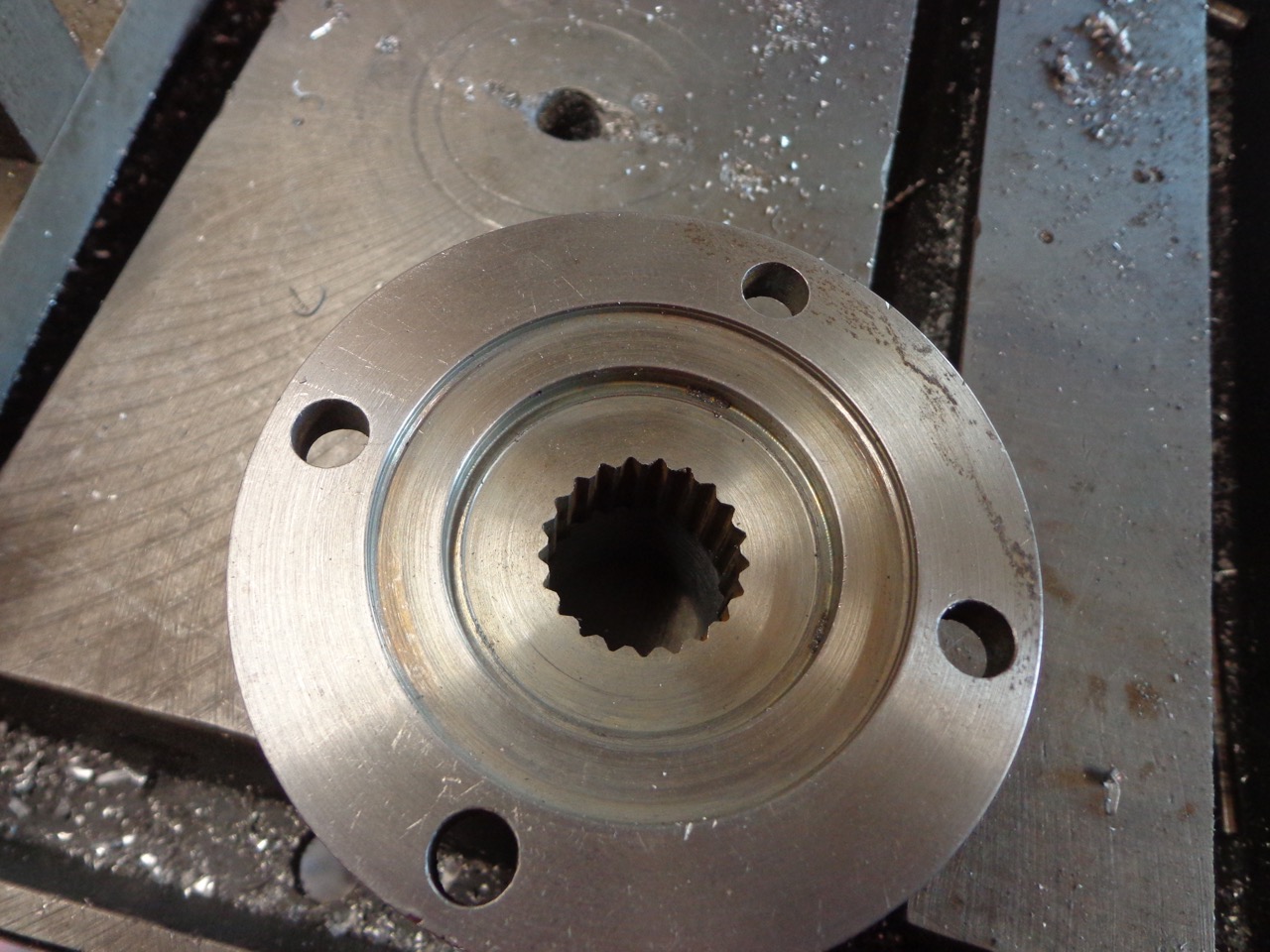

Output Flange finished with splines, "wire eroded" by Screwtech

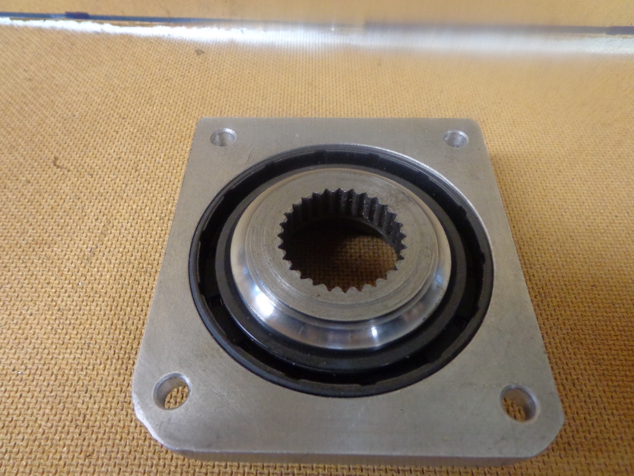

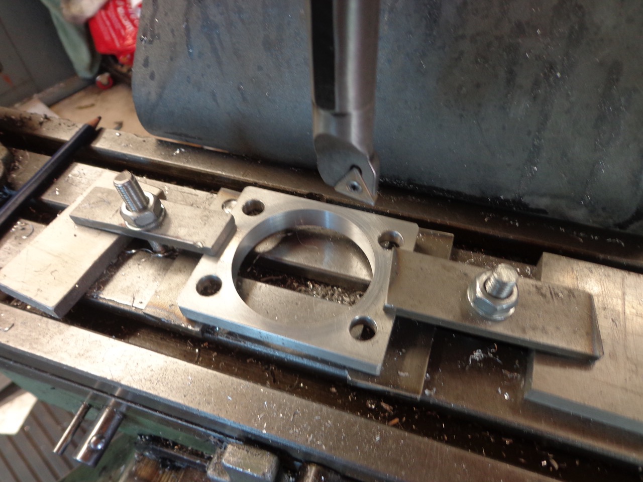

Plate to retain Oil Seal for the new output flange.

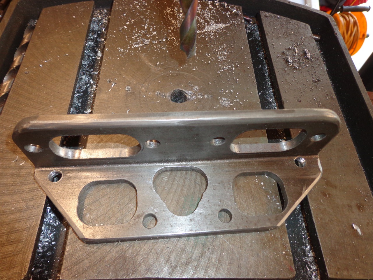

Support Bracket
Milled holes to reduce the weight, bit more to go, so that it is the same weight a 2 Engine mount brackets.

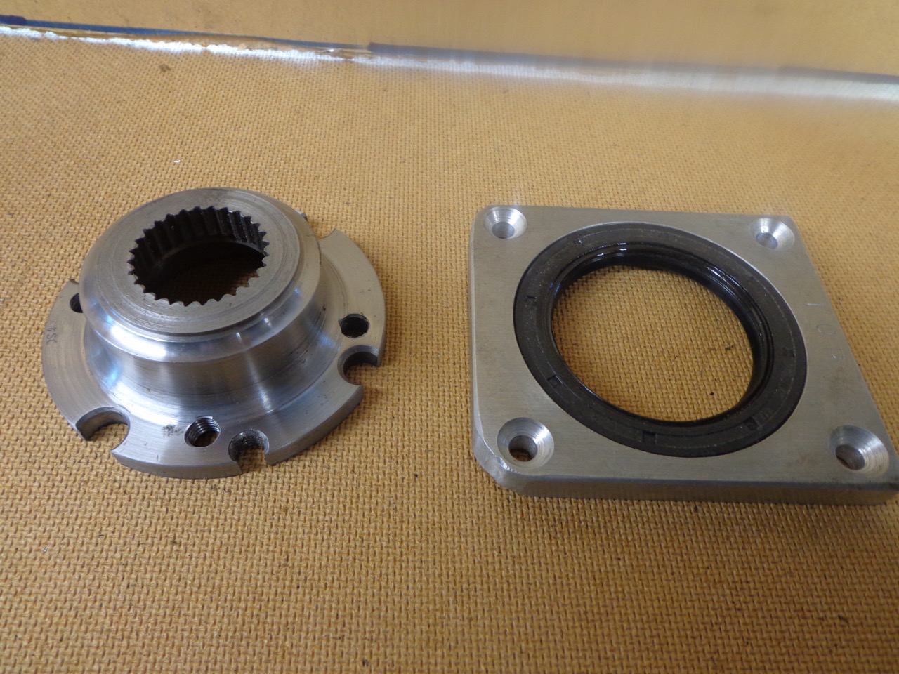

Final Machining/polish of the output flange so it fits the Oil seal.
Video of shaft in the lathe
https://youtu.be/haFgHuzzbK8
