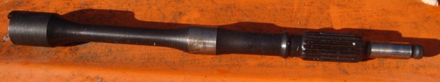

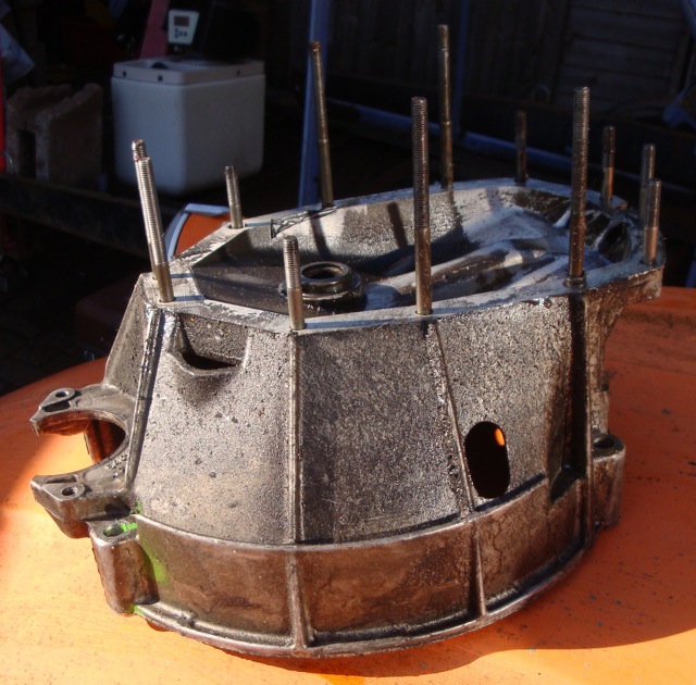

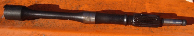

Obtained an LNA Bell housing and input shaft.

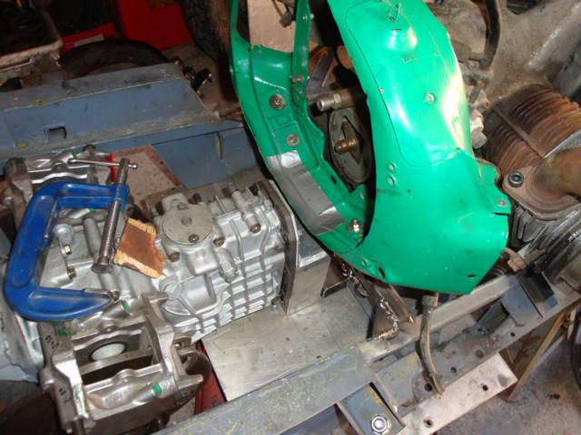

Fitted the Revised Diff Housing and have opted to usa a 2CV engine, which is still a tight fit.

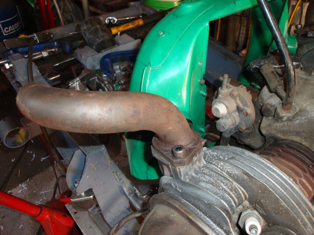

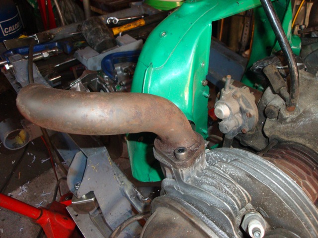

GS Manifolds to be modified..

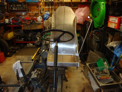

Seating in a 2CV is quite cosy, this will be more so...

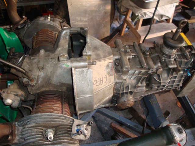

Simple jobs this week.
Put Flywheel and Clutch on Engine, Put gearbox on engine.
Test Rotate by hand as you do....
I now have a system with 8 reverse and 2 forward gears!
I had ASSUMED the output pinion shaft rotated in the same direction as the engine!
