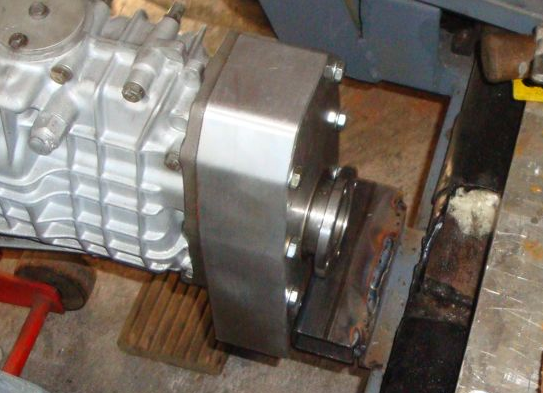

Two Steps Forward One Step Backwards......

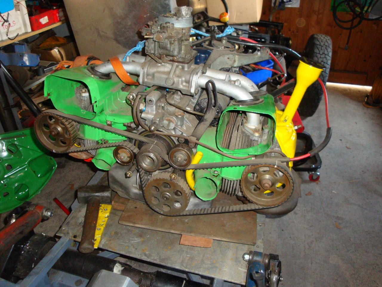

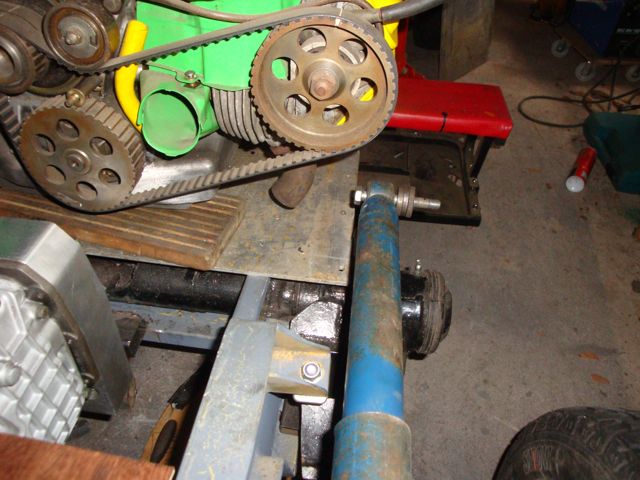

Fitting the engine and gearbox in a tight space.
Had to move the rear diff back 5cm to prevent the fan housing hitting the box.

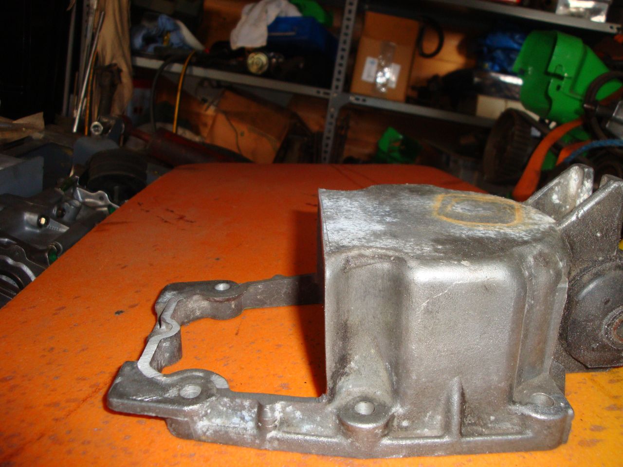

Will also have to chop the top off the new housing, will try with original housing first
Forgot how complex a GS engine is compared to a 2CV
February 19th, 2012, 2:54 pm
Online
Posts: 2257

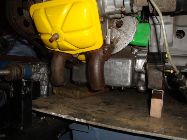

Two Steps Forward... Two Steps back....
The exhaust manifolds need more room..
Need to move the mounting for the shock-absorber.

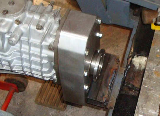

If the existing manifolds can't be squeezed in, maybe some work to fabricate the exhaust
