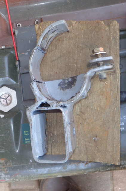

See pic of my first bracket, tried the pump, bracket badly aligned,not bolted up and bad welds....
Quite a bang....

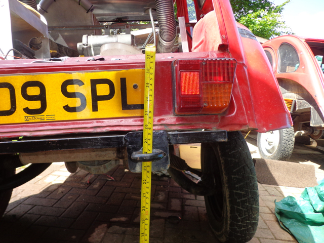

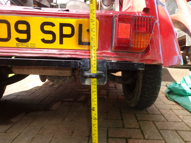

Measured Max and Min not the most extreme but happy with the result, with total of 20cm at the bumper.

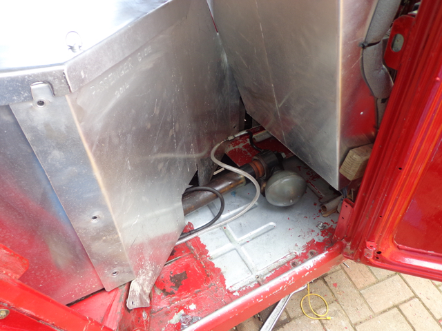

Cut the engine covers and tried the seat, all seems to fit.
Need to postions pipe work and fasten down with clips.

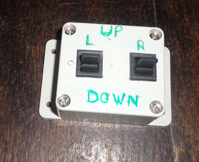

Control Box with Up/Down buttons for each side

Great job - why didn't you put the control buttons up near the steering wheel?
June 19th, 2015, 5:16 pm
Too many wires.....
So an old remote TX/RX control from the junk box....
Remote control from 50metres
