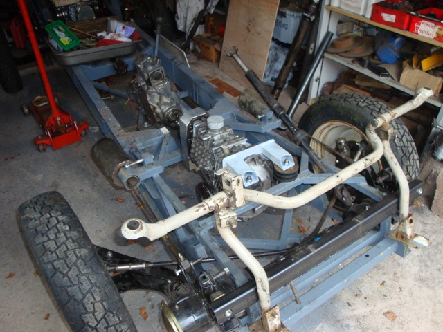

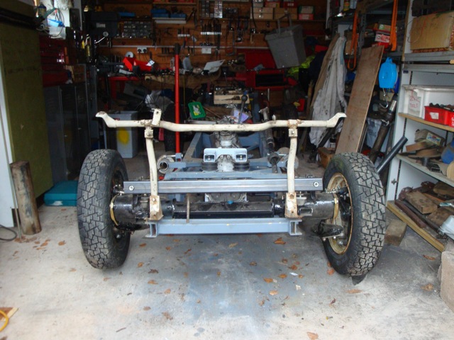

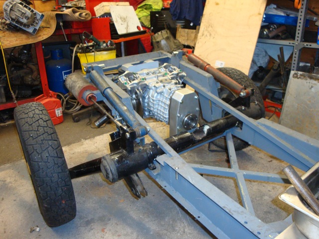

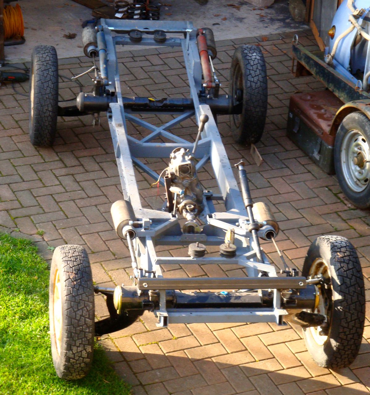

As the weather has been so mild, made/fitted some adapters to mount he spring cans.
Now I have a rolling chassis.

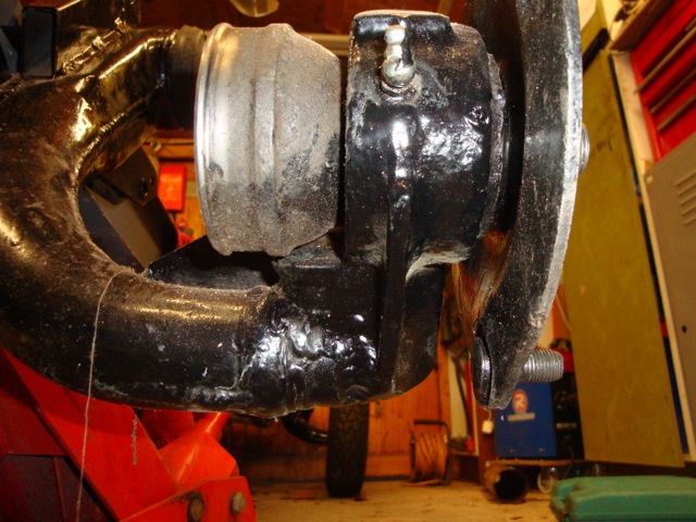

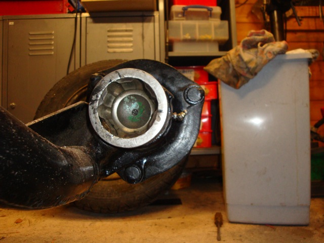

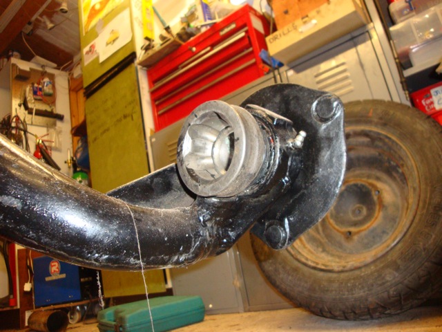

I'm very interested in your rear arms Pete. (i'm running rear wheel drive)
Do you still have kingpins in there?
if so have you rotated the kingpin piece in the end of the arm?
How is the steering disabled?
could you show a close up of the hub area?
My steering is diabled by welding the track rods to the arms, it works but is very inelegant, i also want to lengthen the wheelbase slightly and yours looks like an elegant solution.
nice work there.
Bob.

here's one of the simplest (and most effective) arrangements I've found for a RWD setup using 2CV components...

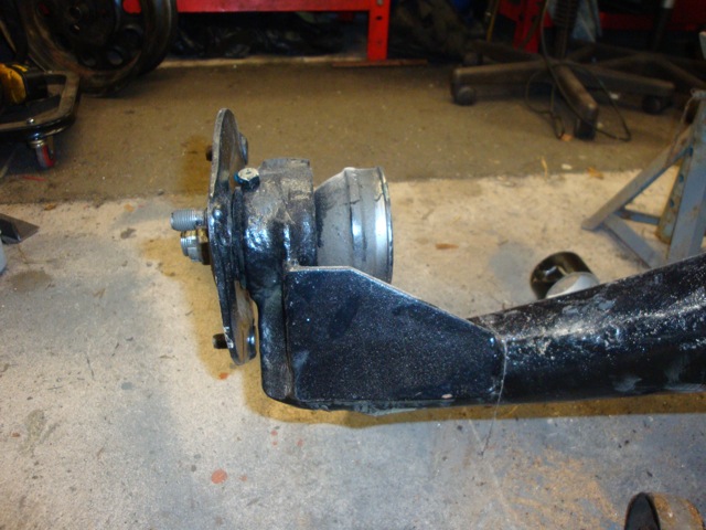

Hi Bob,
What are you building?
Seen some Rear drive/Rear engined specials on the "snail" forum
Please post some pics.
Some pics
Arms were originally made by Louis Barbour.
Appear to retain kingpin
Last pic show the 4mm support plate
Are they Turned??
Hub appears to have no caster ie its up right
If you nearby come and visit.
Peter

Thanks Ken, I like that! very neat.
Thanks for the close ups Pete. they show just what i wanted to see.
It looks like it's been turned so the kingpin angle goes the other way compared to front arms, this is what i wanted to do so cheers for that.
Sadly i'm about as far from you as i can get or i'd love to come for a look.

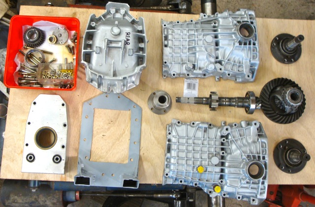

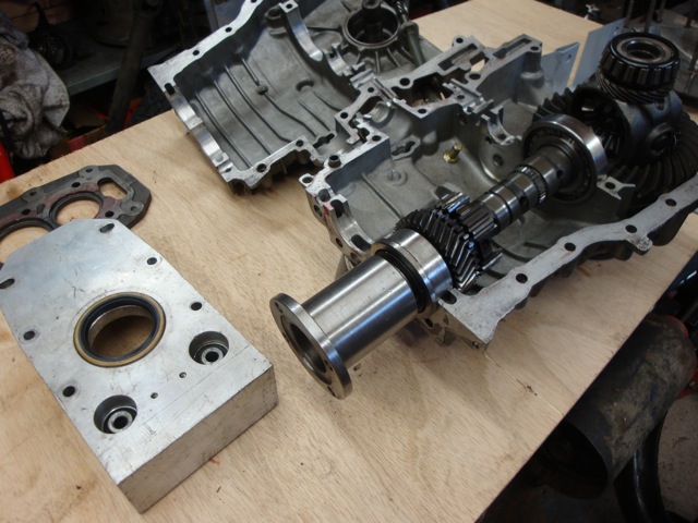

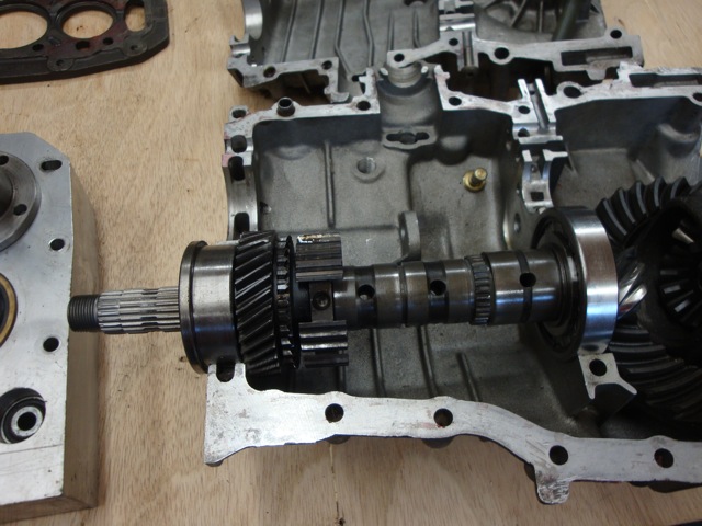

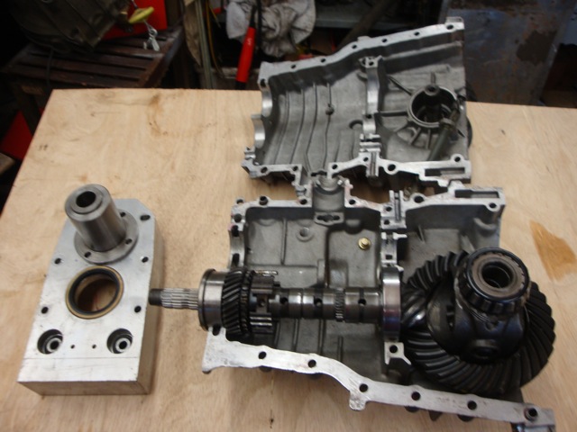

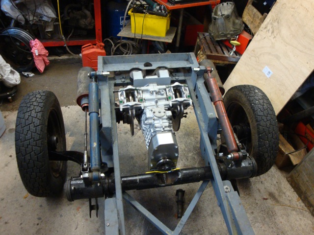

Very Cold in the workshop this week , but a few stints have got the Front and Rear diff's assembled.
With the Rear diff fitted to the chassis.

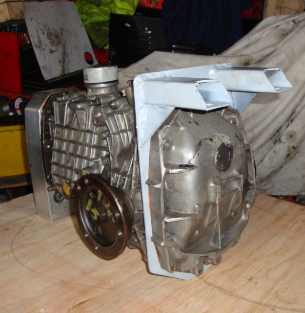

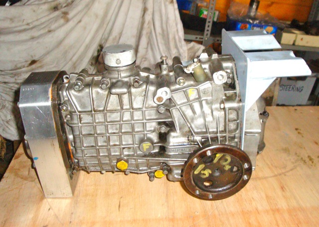

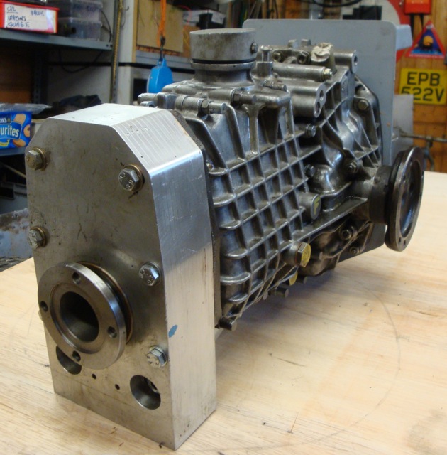

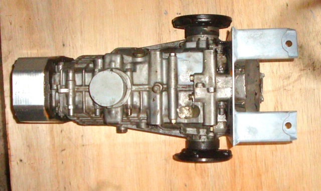

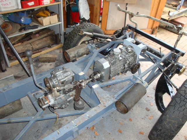

Front End.
Today Fitted front diff.

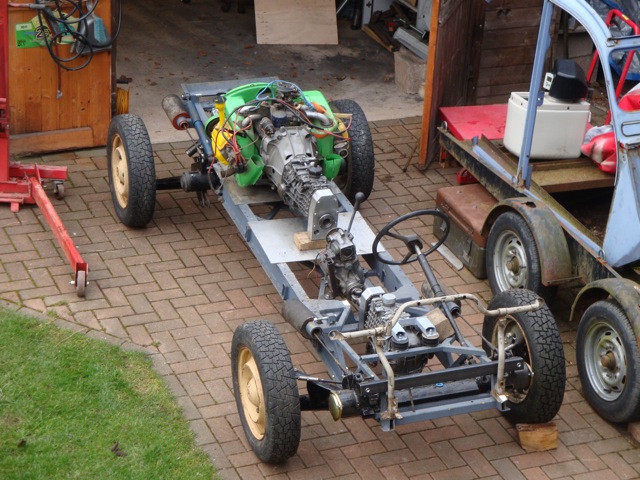

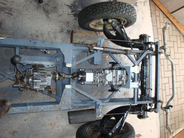

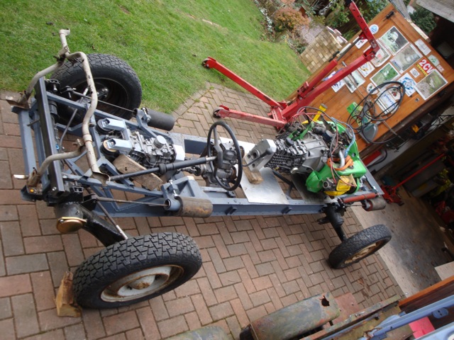

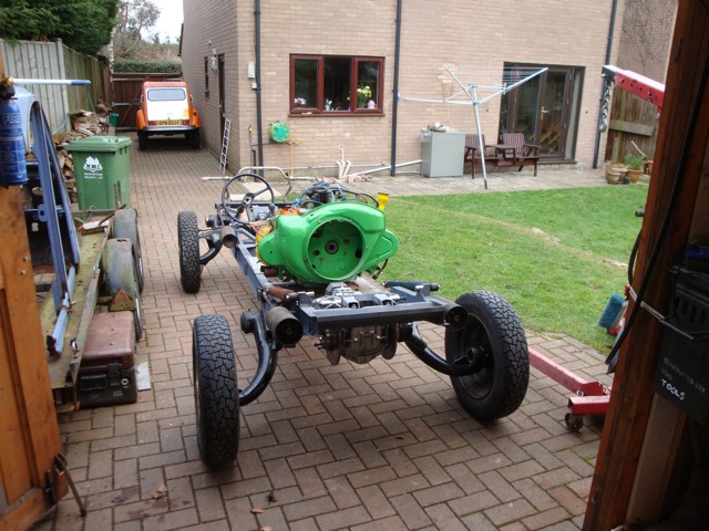

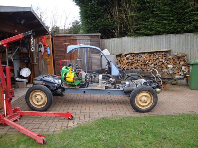

Placed engine and main gearbox on chassis.
Engine has been in the back of the garage for the past 6 years.
Needs another Carb and timing/distributer setting up!!!
