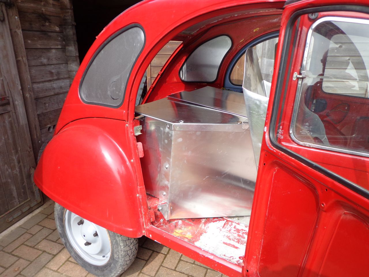

Made cover for Engine ++ sound insulation.

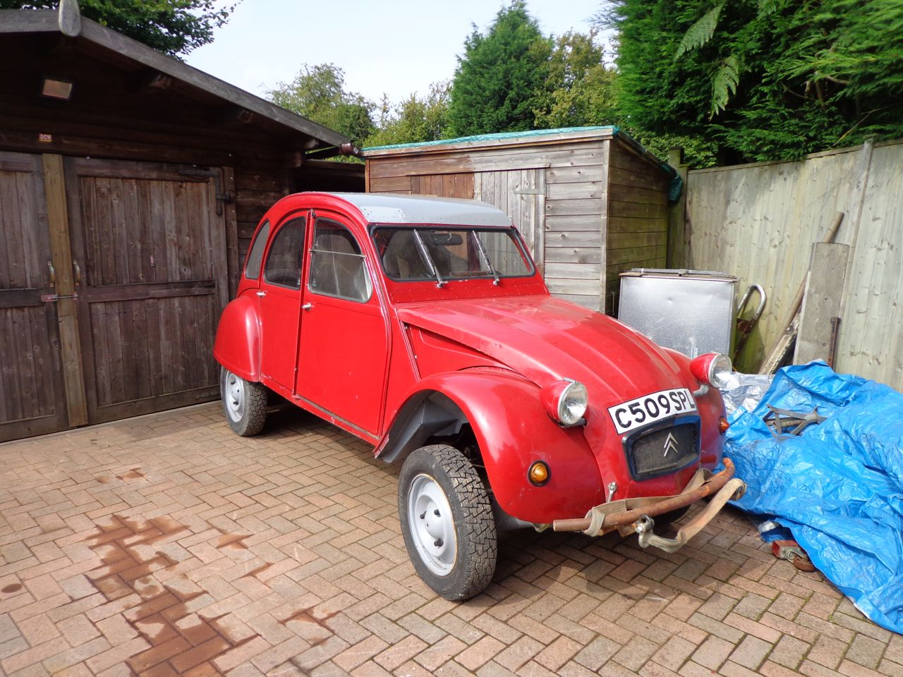

Ready to go to France...

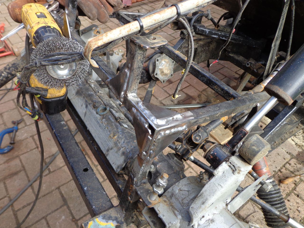

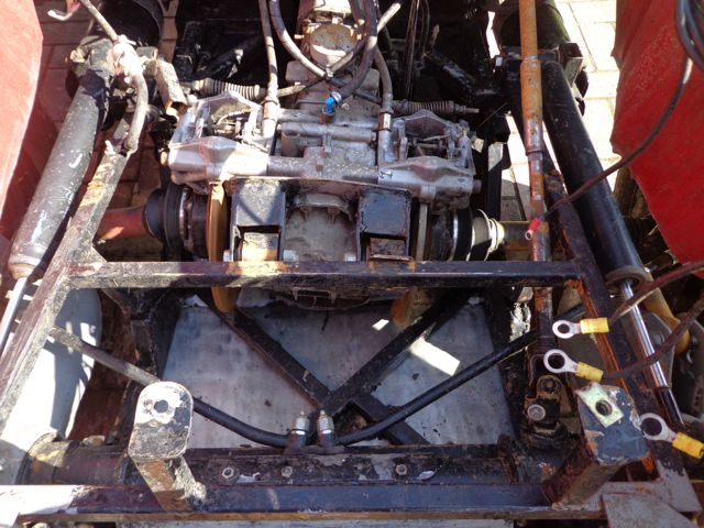

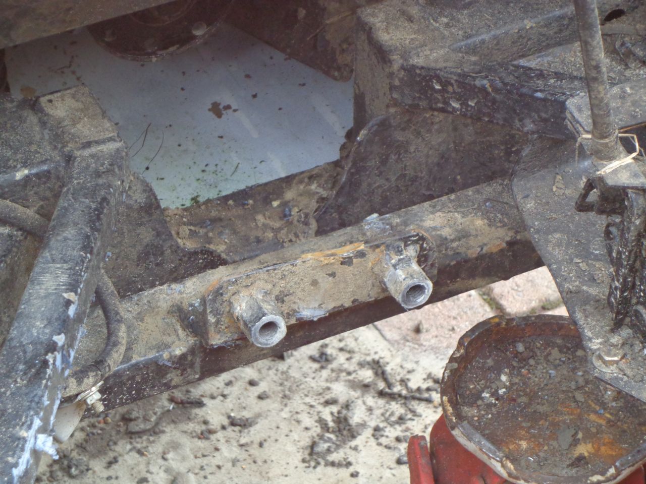

Broken mountings for the front diff..

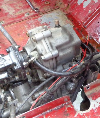

Bent Gearbox mounting (5mm angle).

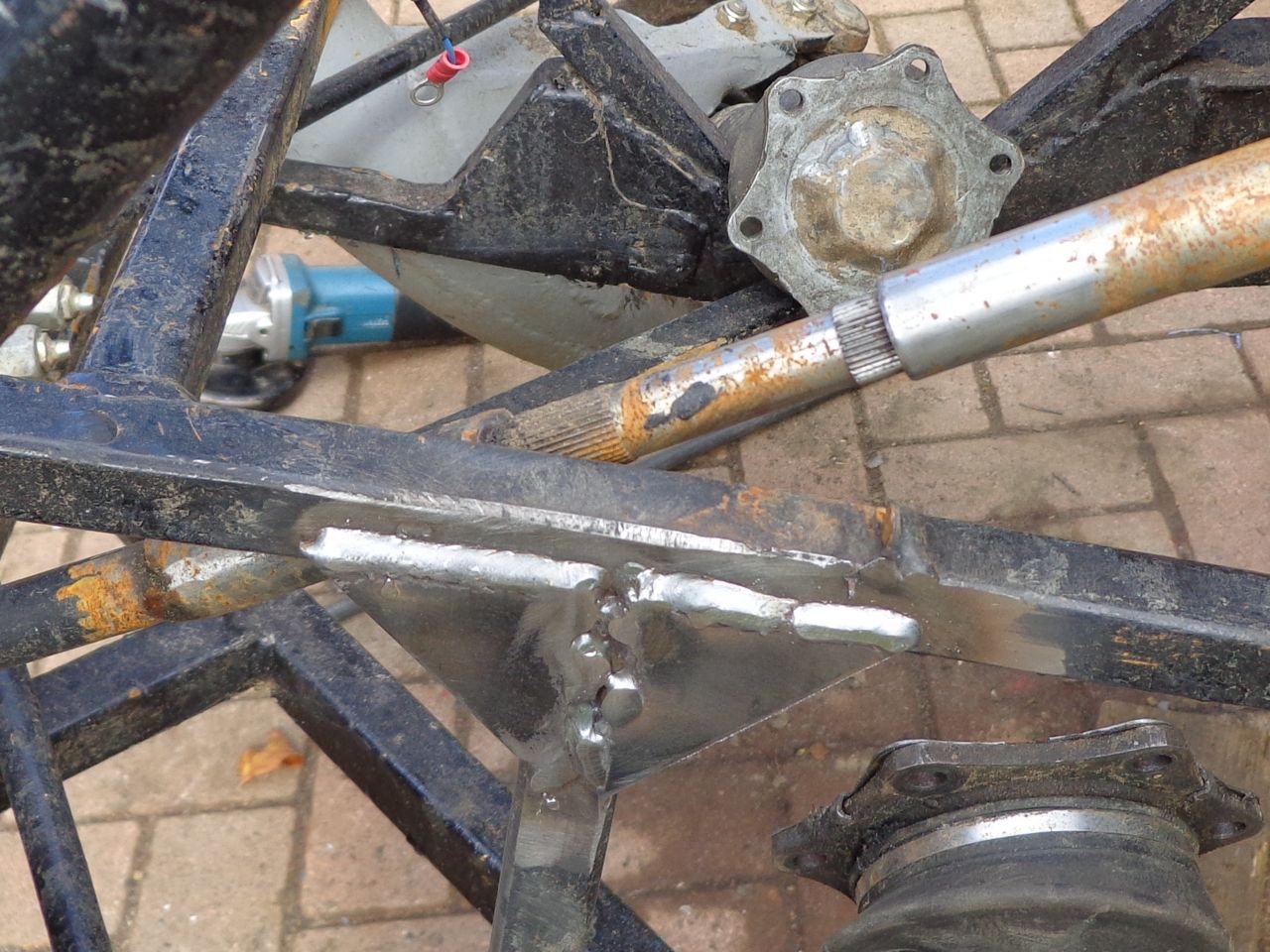

But looking at the welds, they are bad,
I did them with last of the Gas and the end of the wire reel not feeding properly.
Plan to mount the front box with four mounts as it seems to get more movement/stress then the rear.

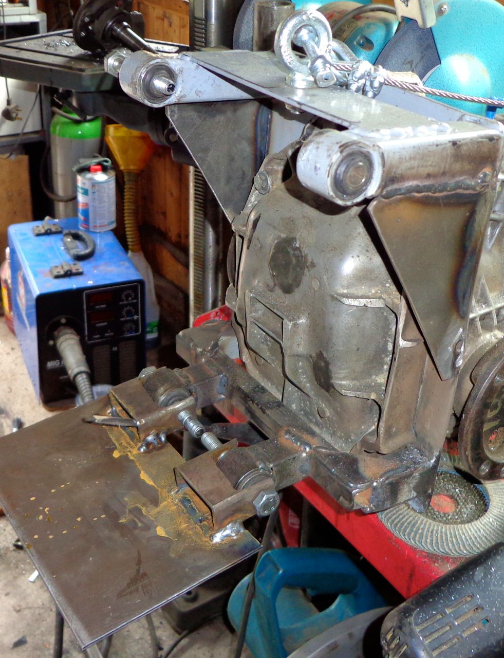

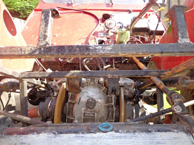

The current job is to build a new Gearbox mount in 3mm steel and Thick wall tube, as 2mm steel and exhaust tube are not up to it...

After some more "Espionage" ;) in France, have added some Gussets

Revised Front Diff Mounting...
October 4th, 2014, 1:57 pm
Diff now refitted..
