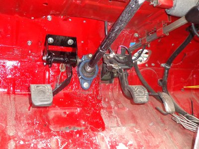

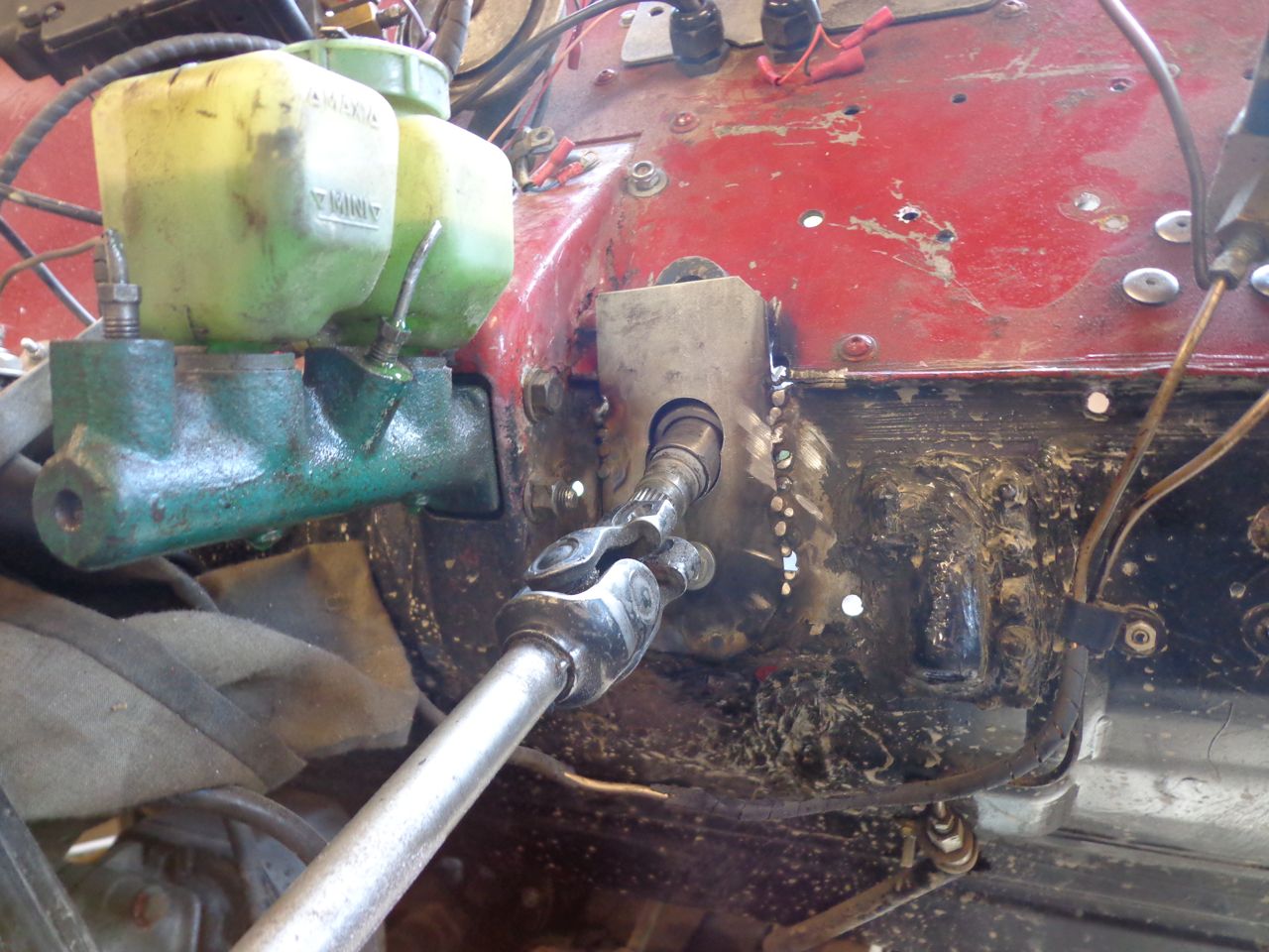

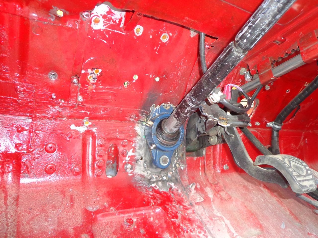

Steering Column bearing mounting plate.
Tacked in place to see if it all rotates.

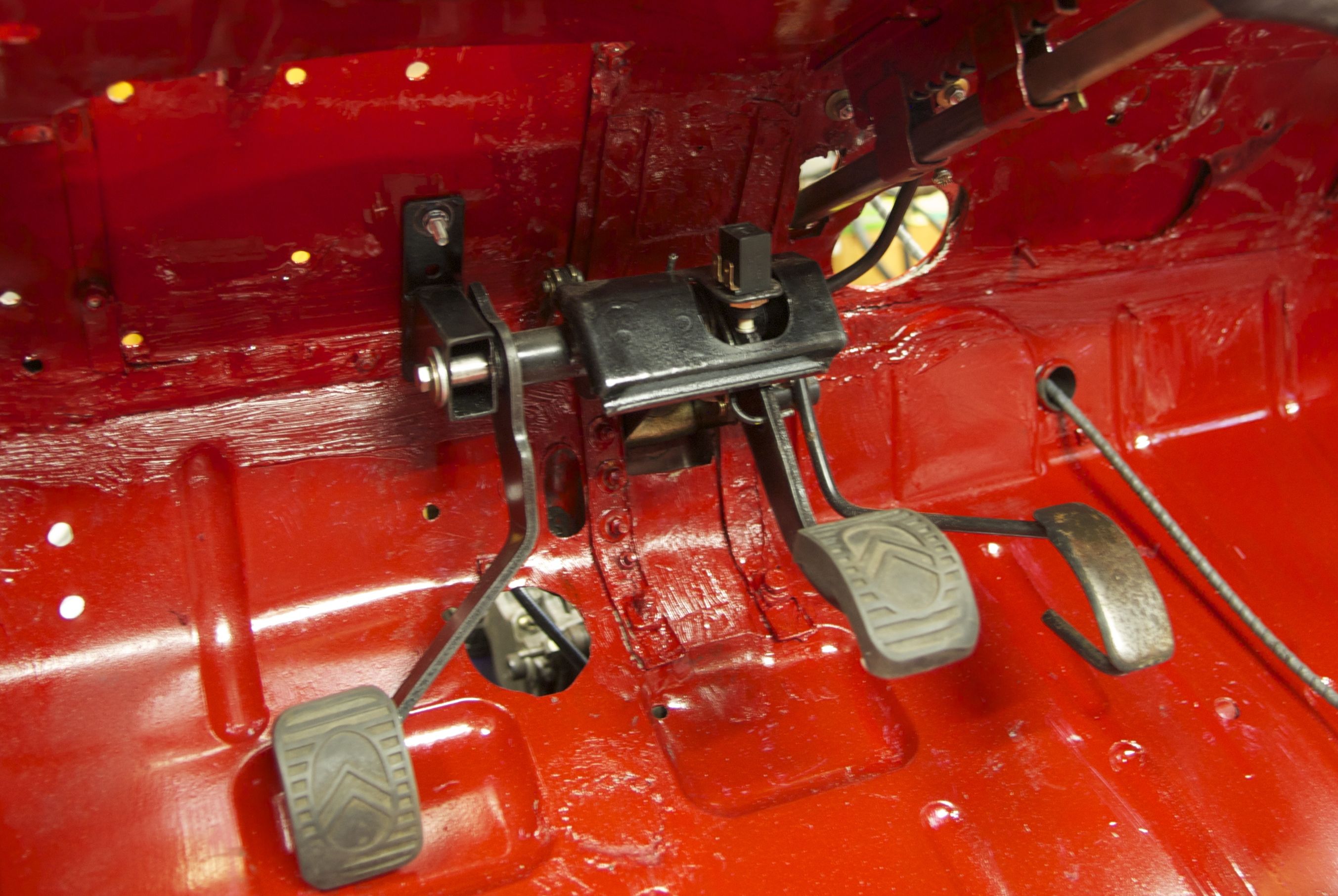

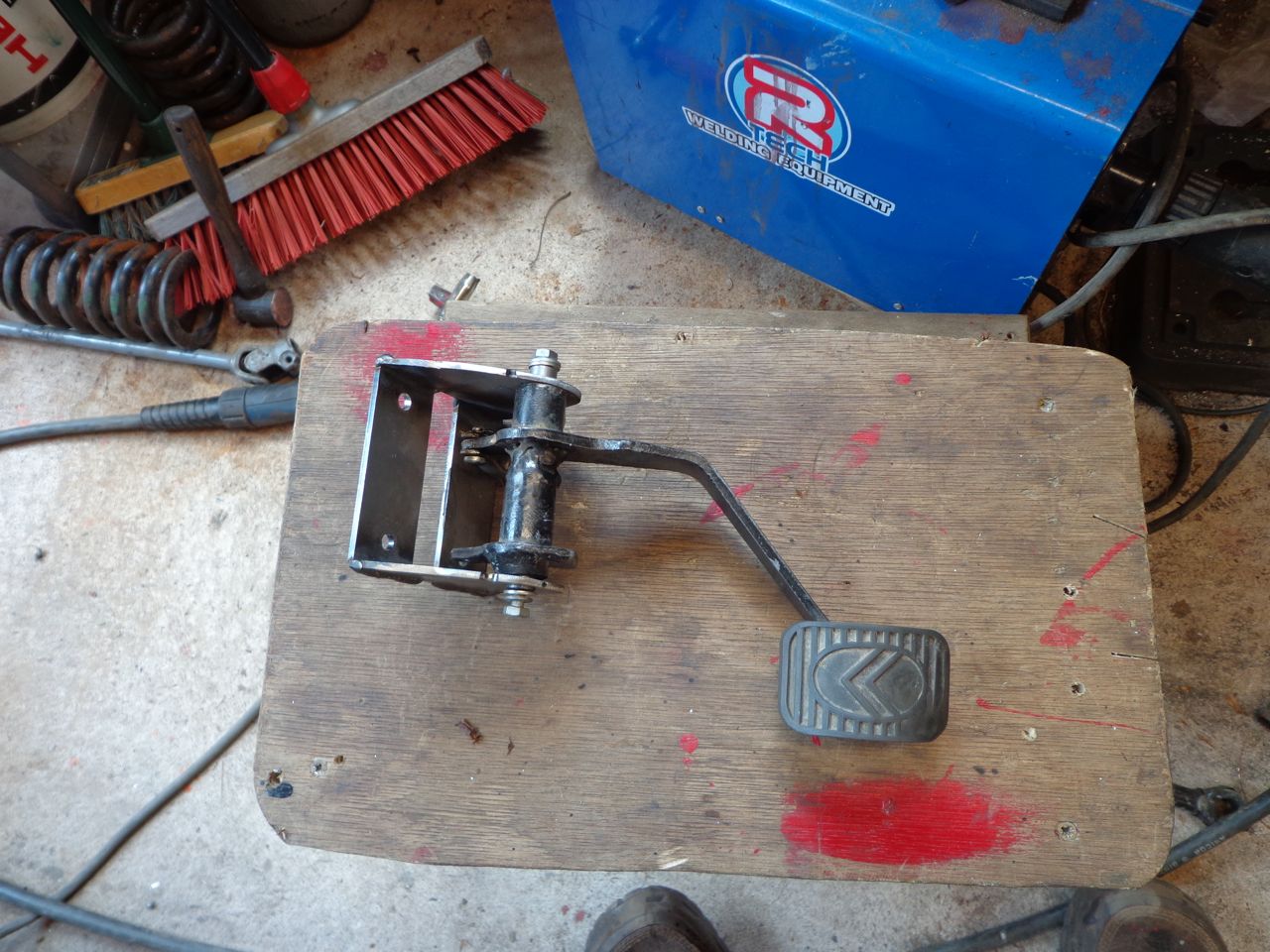

Clutch Pedal bracket (number 3)

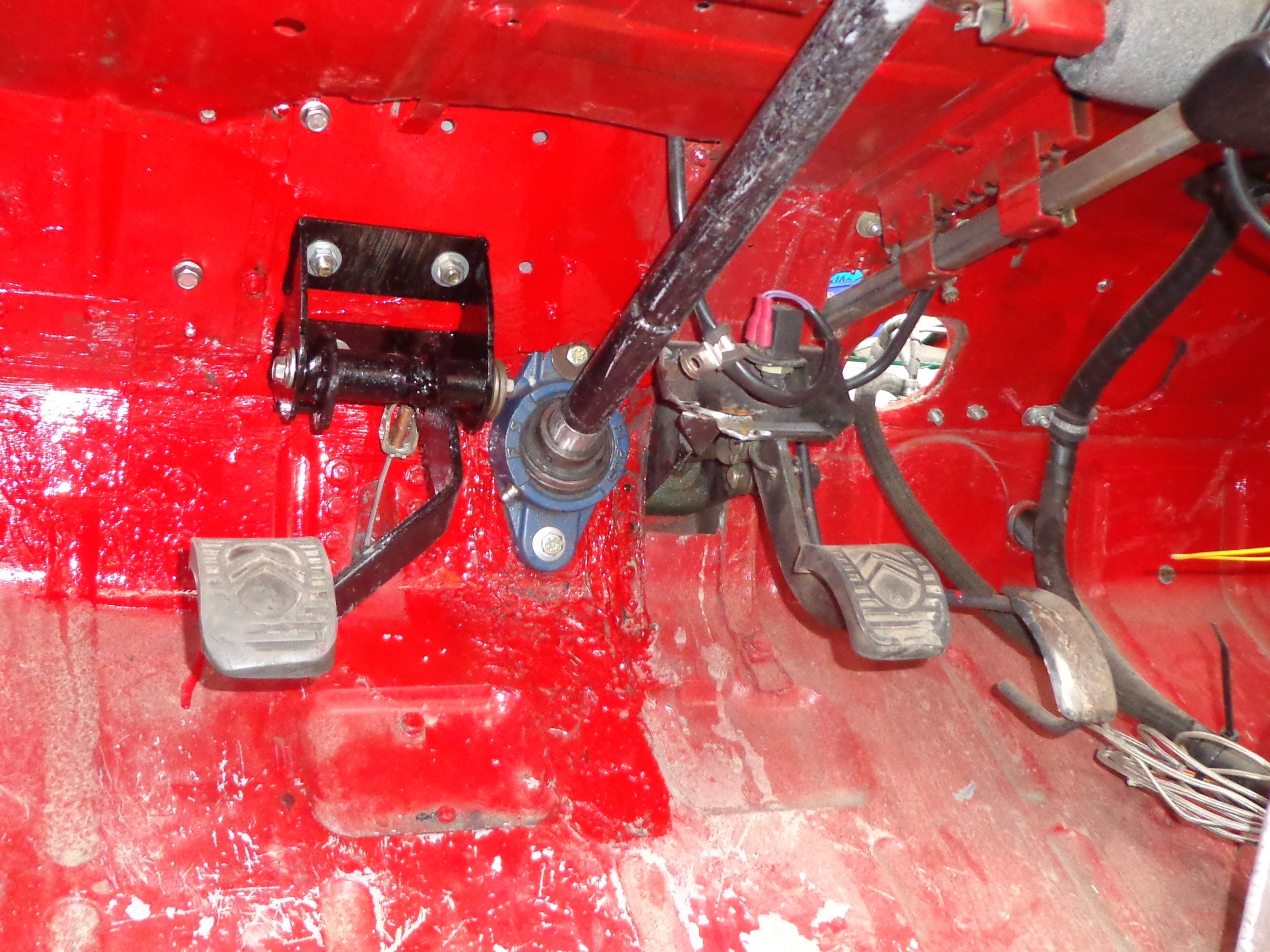

Paint always makes this look a bit better.

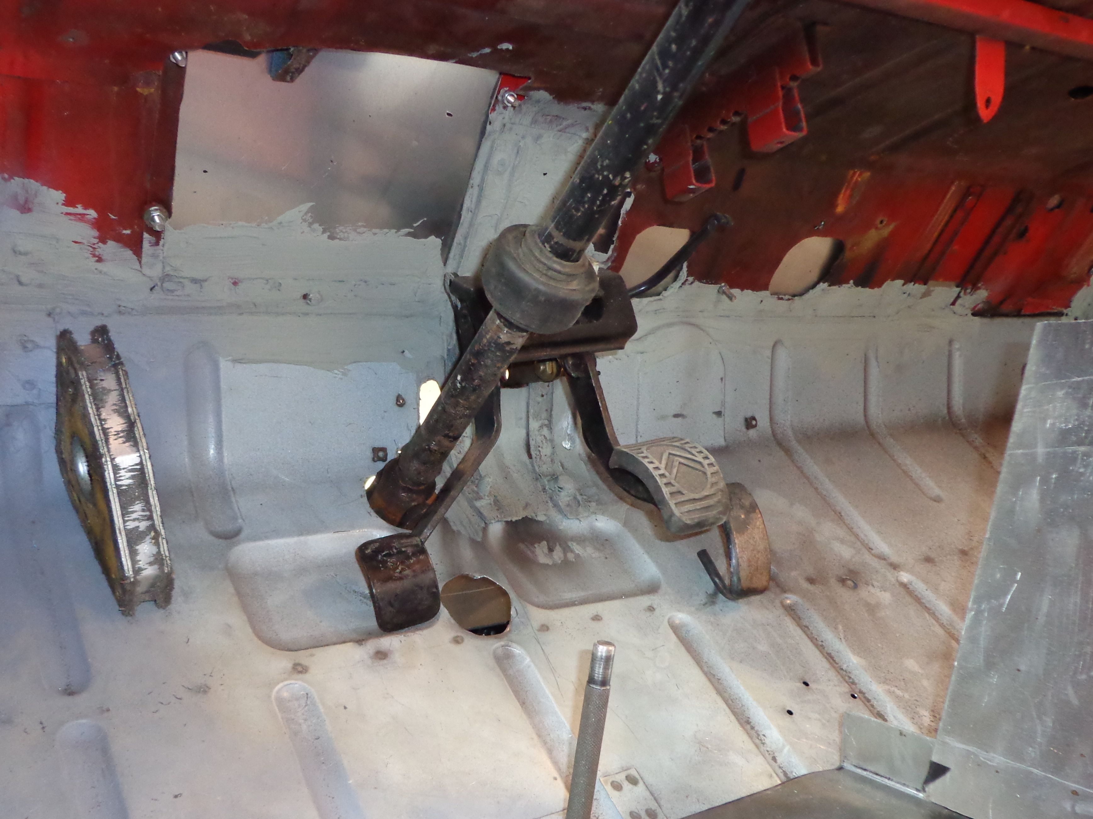

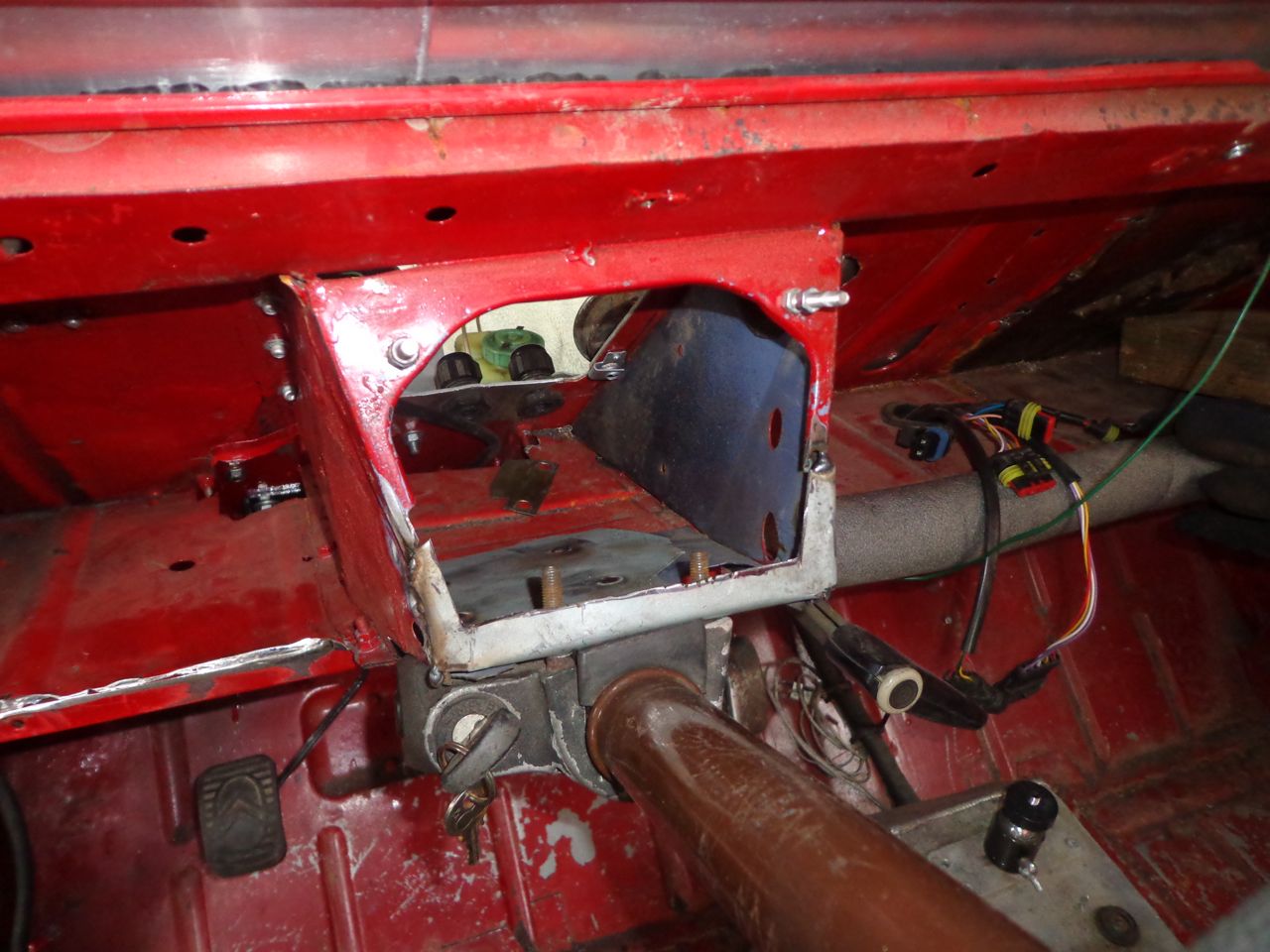

Versions of Steering column position.

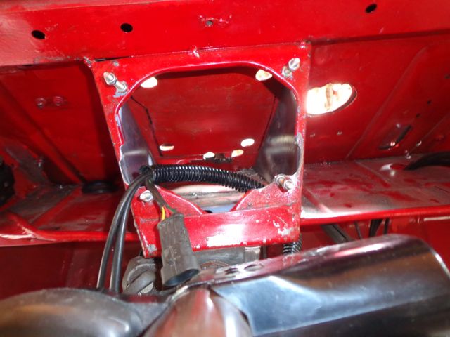

Mk 2 - Steering Lock Mounting.
Mk3 - Steering Lock Mounting (a bit shorter)

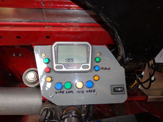

New Dashboard.

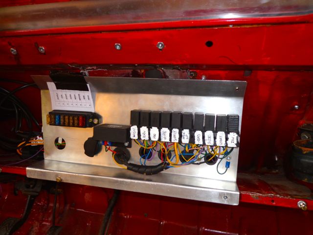

New Fuse Panel.
Wiring still to do ....

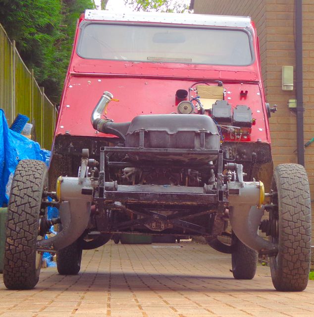

On going Saga of the front suspension :( :(
As it is now...
TO DO.
Robust Front bump stops????
Figure out why the steering doesn't self-centre.
more Caster Angle may be required...

Pete,
could be the camera angle, but there seems to be a fair bit of negative camber on the offside wheel, more than is on the nearside.
If that's the case, it would make the car pull to the left, iirc...
Ken

Hi Ken,
Looked like that to me, adds to my woes.
Quick measure, nearside 1deg offside 2.1 deg , with my Iphone :lol:. Using the flat part of the wheel centre...

Aaaah now I know at last where the heck a I-phone is for... :lol: :lol: :lol: :lol: :lol:
Is it running already on 1-2-Spark or is it also on the todo list....
p.s. self centering has to do with Caster not with Camber.. It doesn't like right anyway, Ken has a point there, but you noticed it already...
Think about a shop trolley wheel when giving Caster to it/lining it up.... then it can't go wrong.... :idea:

Todo list...
Camber, Caster, engine out ...12spark.. :lol:

New bump stop, support bracket will bend before the chassis does, well thats the plan.. :o
