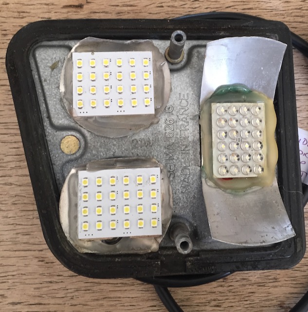

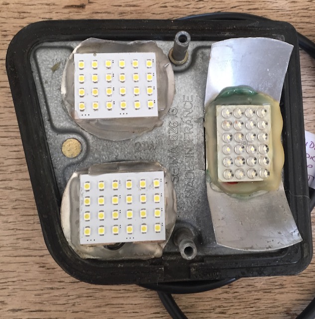

Update .. but still lots to do... LED rear lights. Attachment:

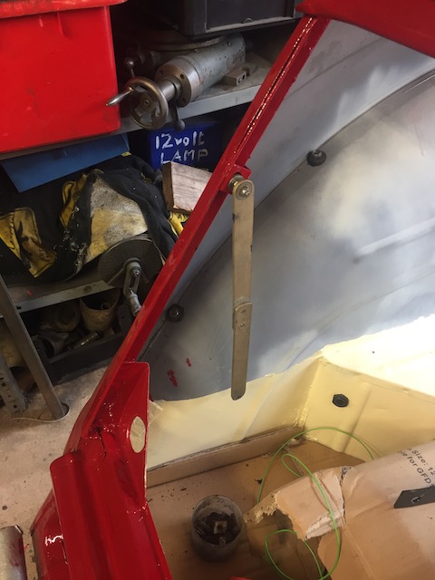

Parts on ebay, but cheaper if you use Aliexpress and wait... https://www.ebay.co.uk/itm/255496392311 ... 0667.m2042Found the boot stay.. Attachment:

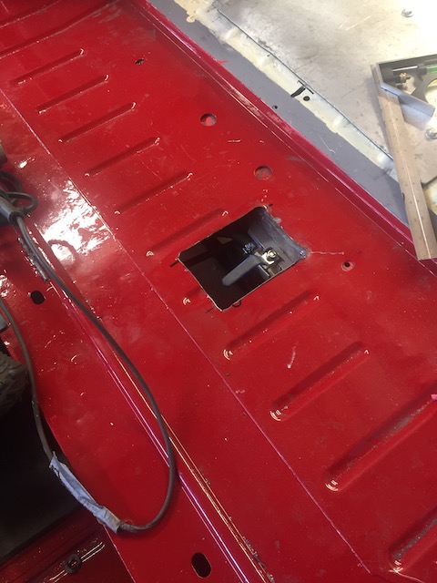

Change over fuel tap (under rear seat) for additional fuel tank. Attachment:

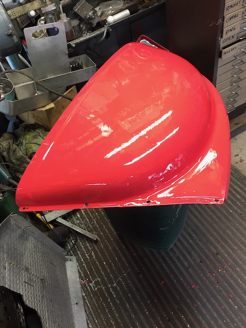

Craftmaster Under Coat on rear wing (with runs). Attachment:

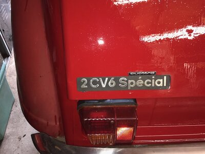

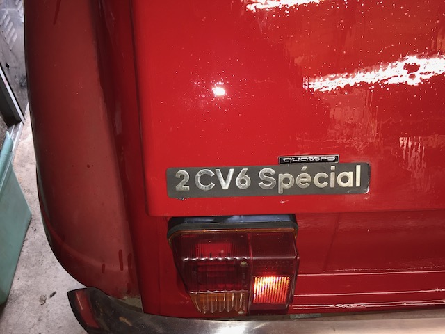

Essential extra Badge. Attachment:

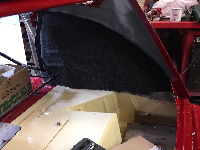

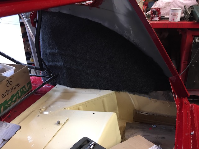

Carpet Lining on rear wing. Attachment:

That's coming along nicely Pete.  I like the idea of the light conversion.  Can you still see the lights from anywhere that is not directly behind?
_________________ If you can't fix it with a hammer, it's probably electrical (or, an electric fuel pump!) ....
| July 30th, 2022, 10:22 am |
subarupete
Joined: March 5th, 2009, 6:23 pm Posts: 2257 Location: Near Monmouth
 Re: EPB Refurb

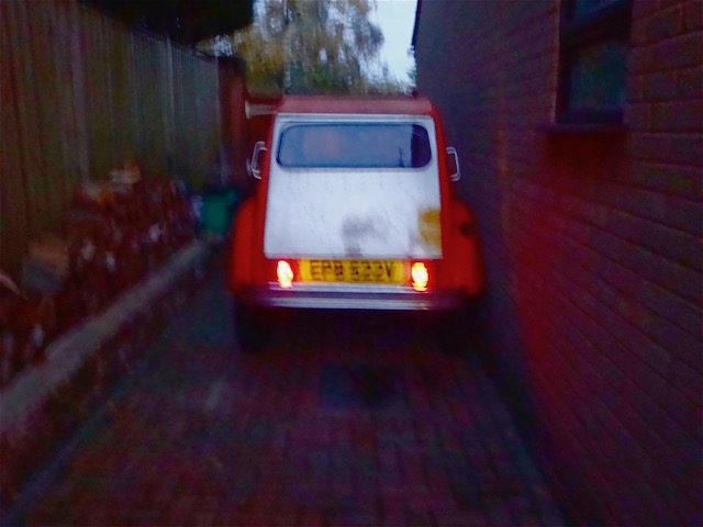

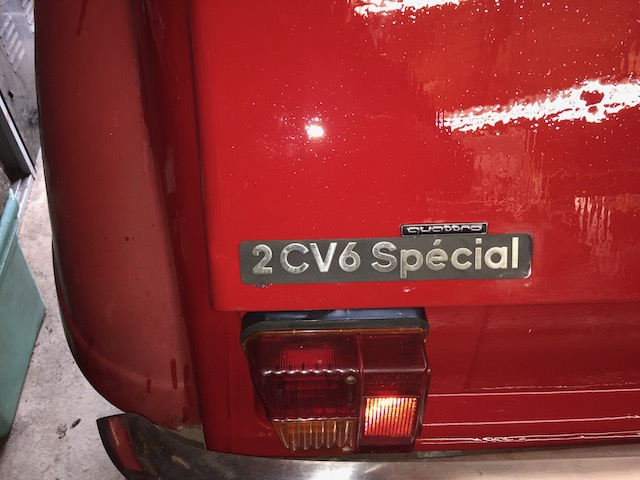

Bulbs being a point source are the best option. the LED replacments are expensive. The LED arrays are brigher and the Fresel Lens cover does its job. See photo Attachment:
Cheers ps They work under water!

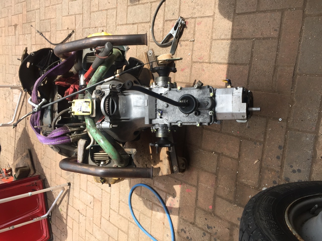

Engine and Gearbox ready to refit. Attachment:

Cool  Though have to say I really liked the purple... then realised it was the lifting harness!!
