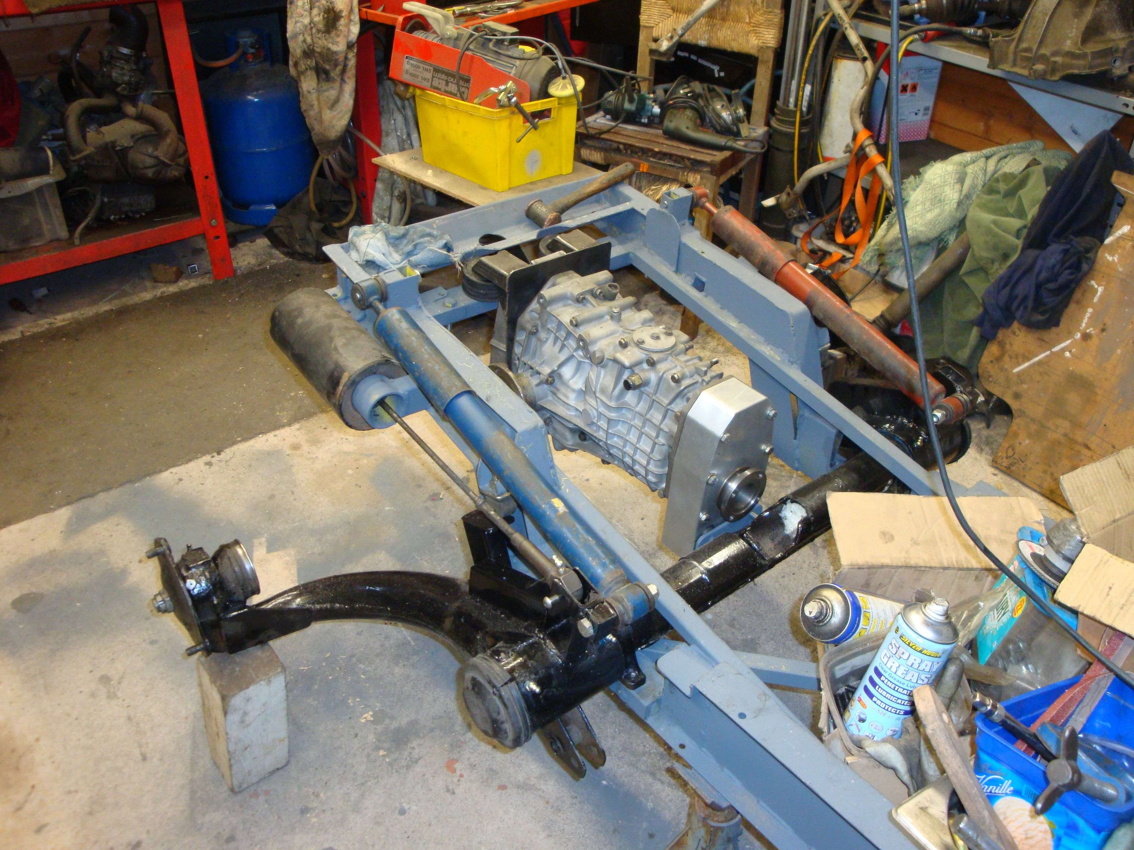

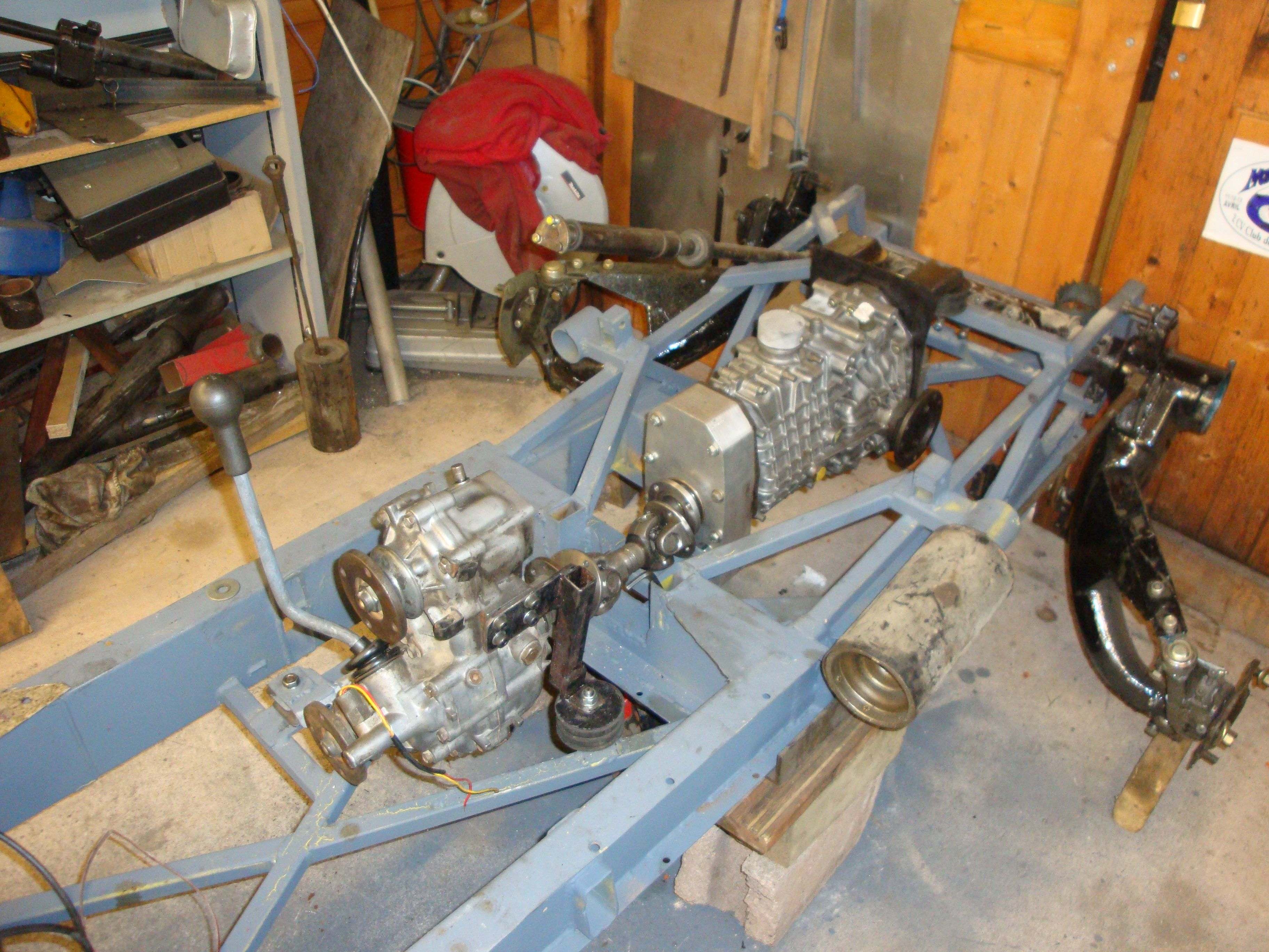

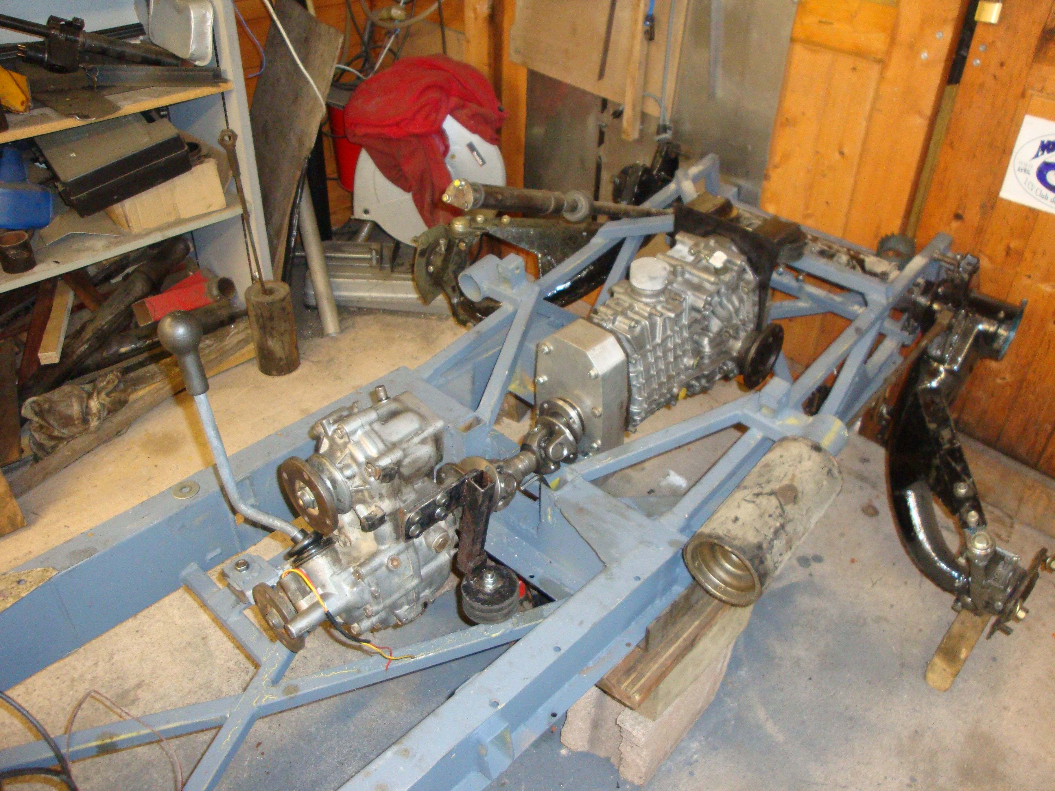

Some pics.
Assemble suspension, still some fixing of spring cans and adjustments to do.
On the wish list are AK springs as I believe they are a lower lbs/inch softer?
Anybody know the spring rate?
Rear End.
Front End.

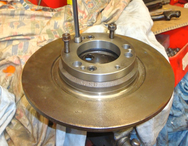

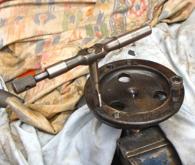

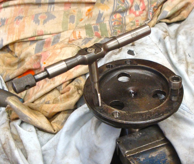

Drive Shaft Adapters.
Drilled and Tapped Gearbox Drive Flange.
Test Fitted Adapters.
November 18th, 2011, 5:34 pm
8-) What did you tap them to, 10mm I'm guessing, 1.5 or 1.25 pitch? Much easier than finding 9mm bolts.
I should do this myself, currently got the original bolts with spacers under the heads.
November 18th, 2011, 11:53 pm
Posts: 2257
Hi Joolz,
Tap 10mm x 1.5. and use 10mm socket bolt, heads need to be reduced to fit, (drill/ flap disc as i dont have a lathe).
The 9mm socket bolts are hard to get. Have tried to source these, but min quantity would be 200+
Was going to use 10mm for the drive shaft as well but not enough metal.
The adapters came from Holland, getting them copied locally for the rear-end.
November 19th, 2011, 11:00 am

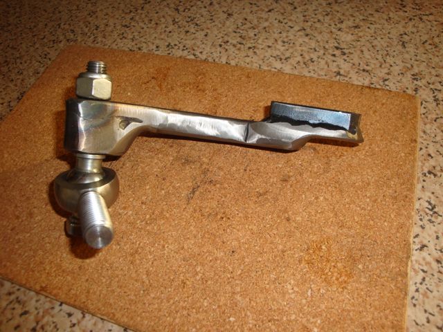

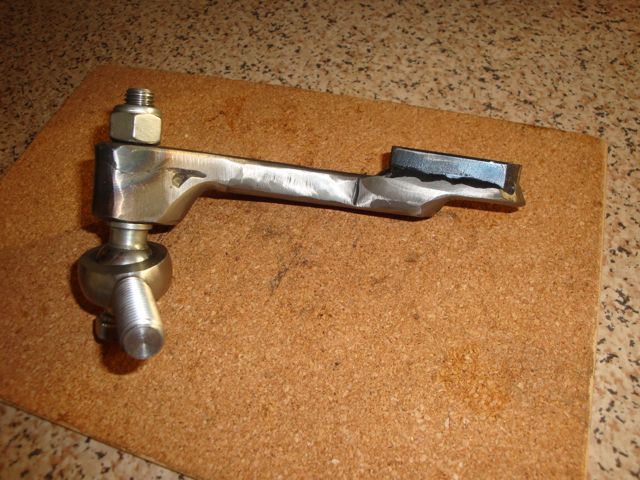

Hi Guys,
Your advice is sought, have attempted to fabricate some steering arms.
See pics.
Problem – have drilled thru the arm at the pivot point to < 12mm.
The 12mm bolt is a “tight fit” in the arm.
Can torque the nut/bolt tight, to put a crush load on the rod-end and spacers.
Will the bolt move and eventually “wear out” the steering arm????
Spend so far on one arm is £16.00, so shall I bin it?
December 23rd, 2011, 1:38 pm
Pete,
it's surprising how difficult it can be to separate parts which have been bonded with high strength threadlocking/bearing fit compounds.
If the shank of the bolt isn't fully threaded, might be worth a shot with one of them, as they're capable of filling bondline gaps of up to 0.25mm, although the cure rate is slower then...
Trial pack;
http://www.ebay.co.uk/itm/ABRO-HIGH-STR ... 1301wt_698
or giant economy size;
http://www.ebay.co.uk/itm/Loctite-290-H ... 2548wt_932
December 23rd, 2011, 3:43 pm
Posts: 2257
Ken,
Thanks for that.
Can put the bolt in from the bottom with the permanent bonding stuff.
December 23rd, 2011, 3:57 pm
