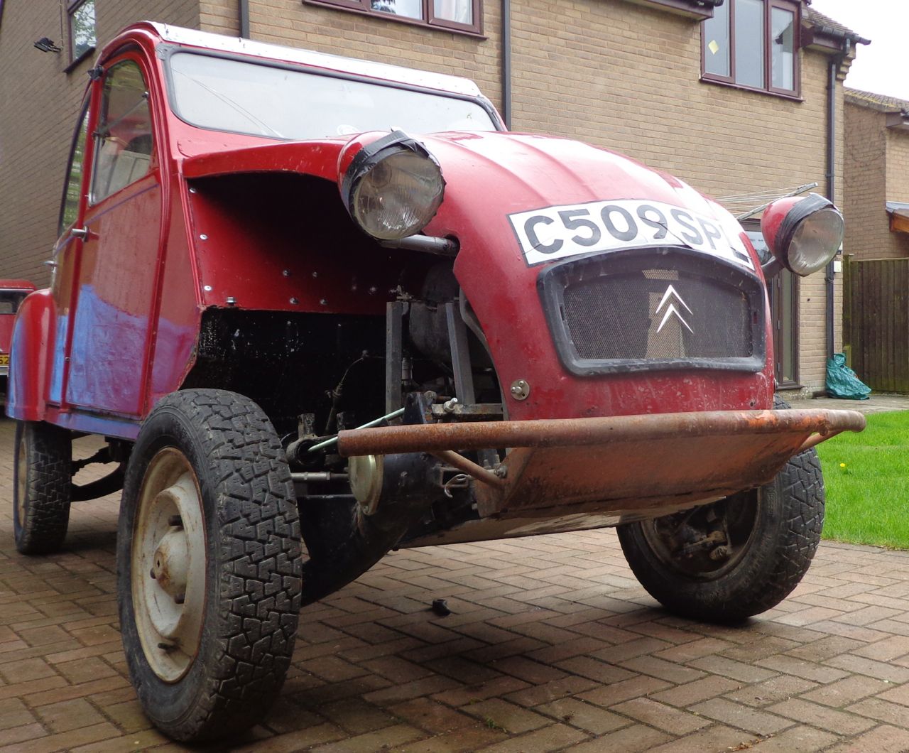

Car sits level, excellent ground clearance, drive-shaft angles, not extreme (see rear left of picture.)
Front end doesn't hit the bumps stops, with me on the front bumper, will try with 2 people.

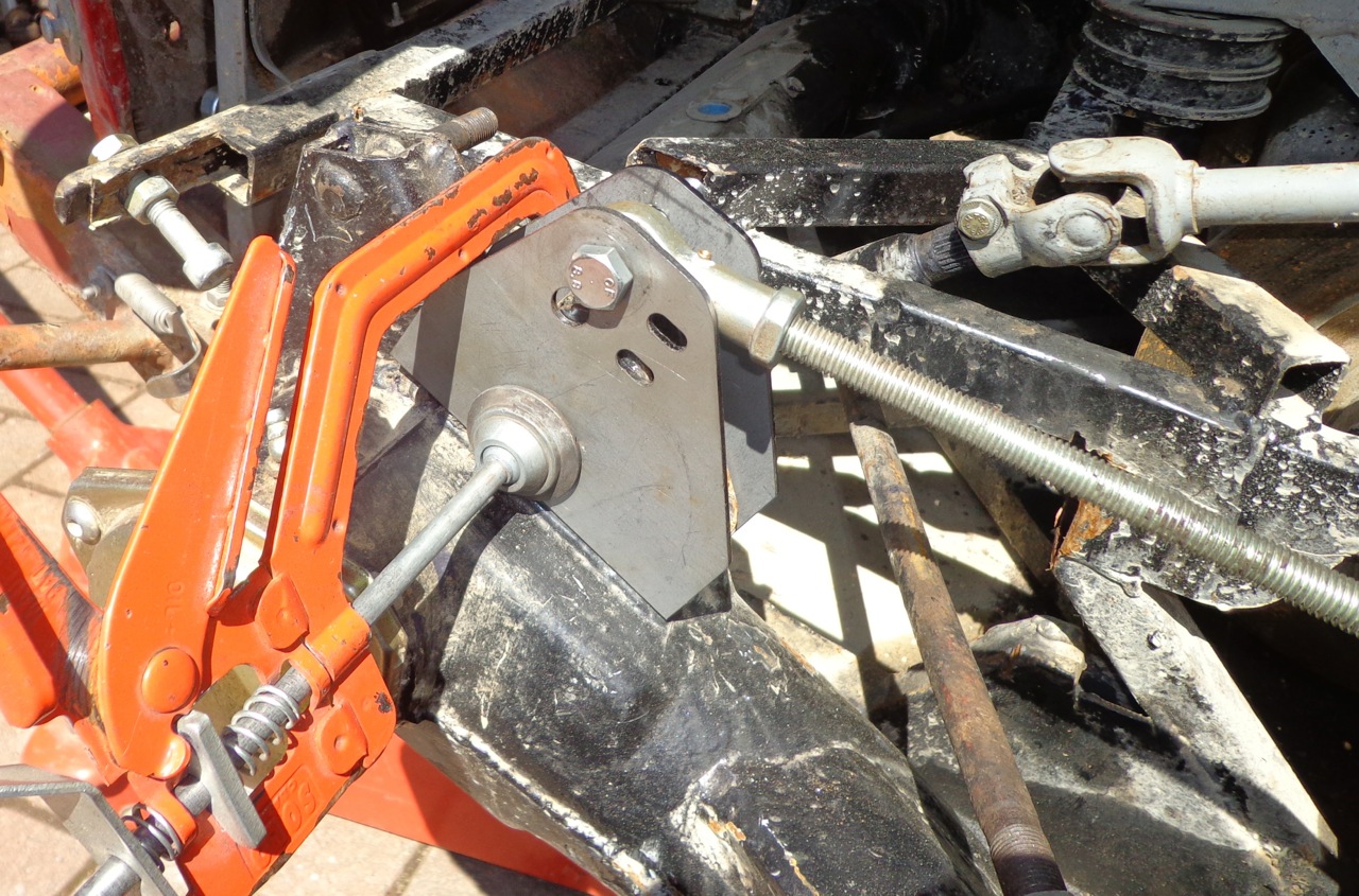

Using the shock mounts to guess at the length of the knife-edge mounts, has had the following result.
twisted/bent mounts :(
However with the revised longer mounts, the suspension should now be less soft and progressive..

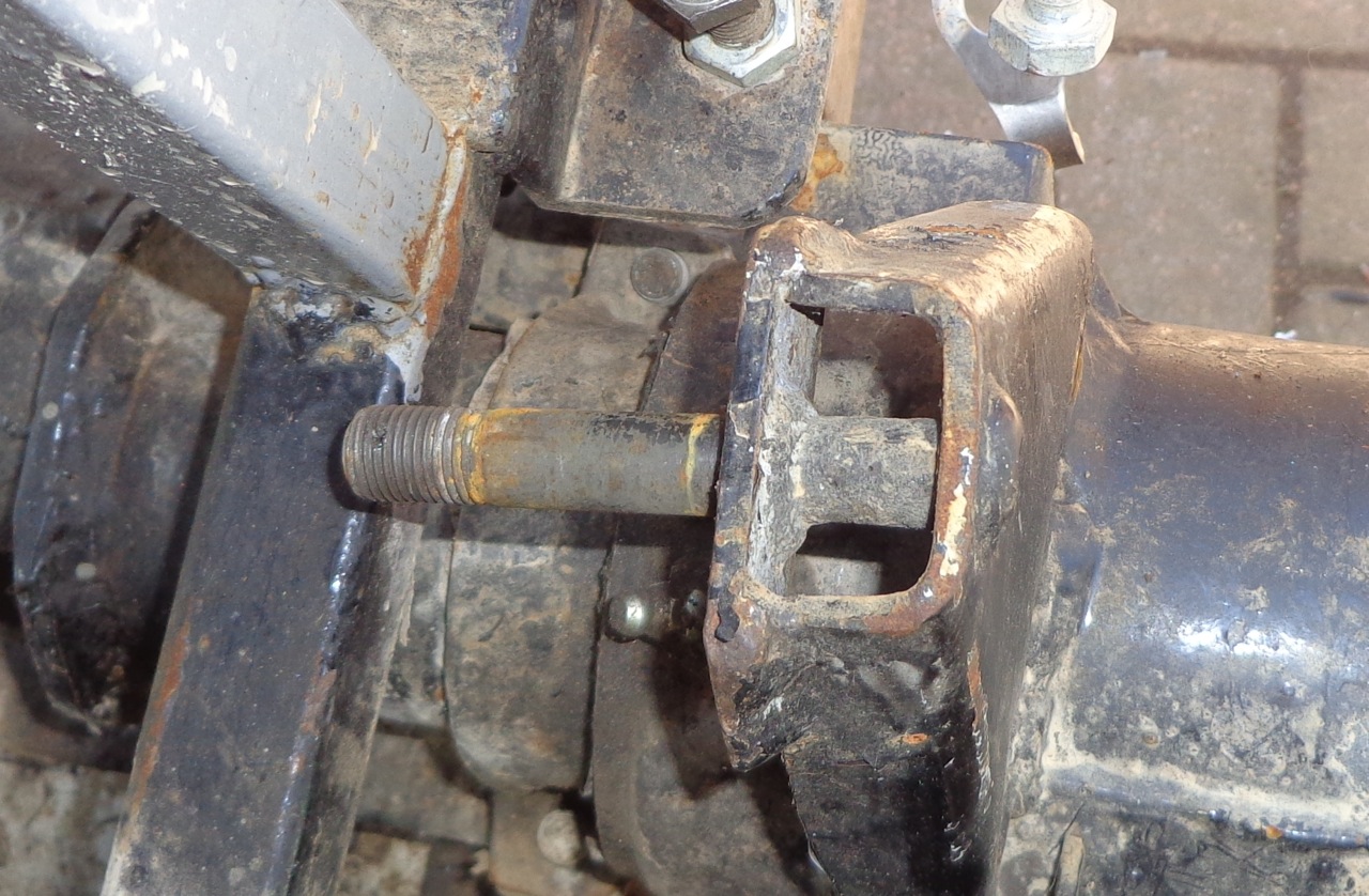

Nice knife edges
if any one wants to convert 2CV to Ak type front knife edges i got them
as we use a lot of them for the 4x4 when fitting A K springs
i normally fit them up with a special jig to ensure they are fitted in the correct position in relation to the inside of the arm
when i get round to it i will find some fitting pictures on the web
so to make an easy welding job
pony

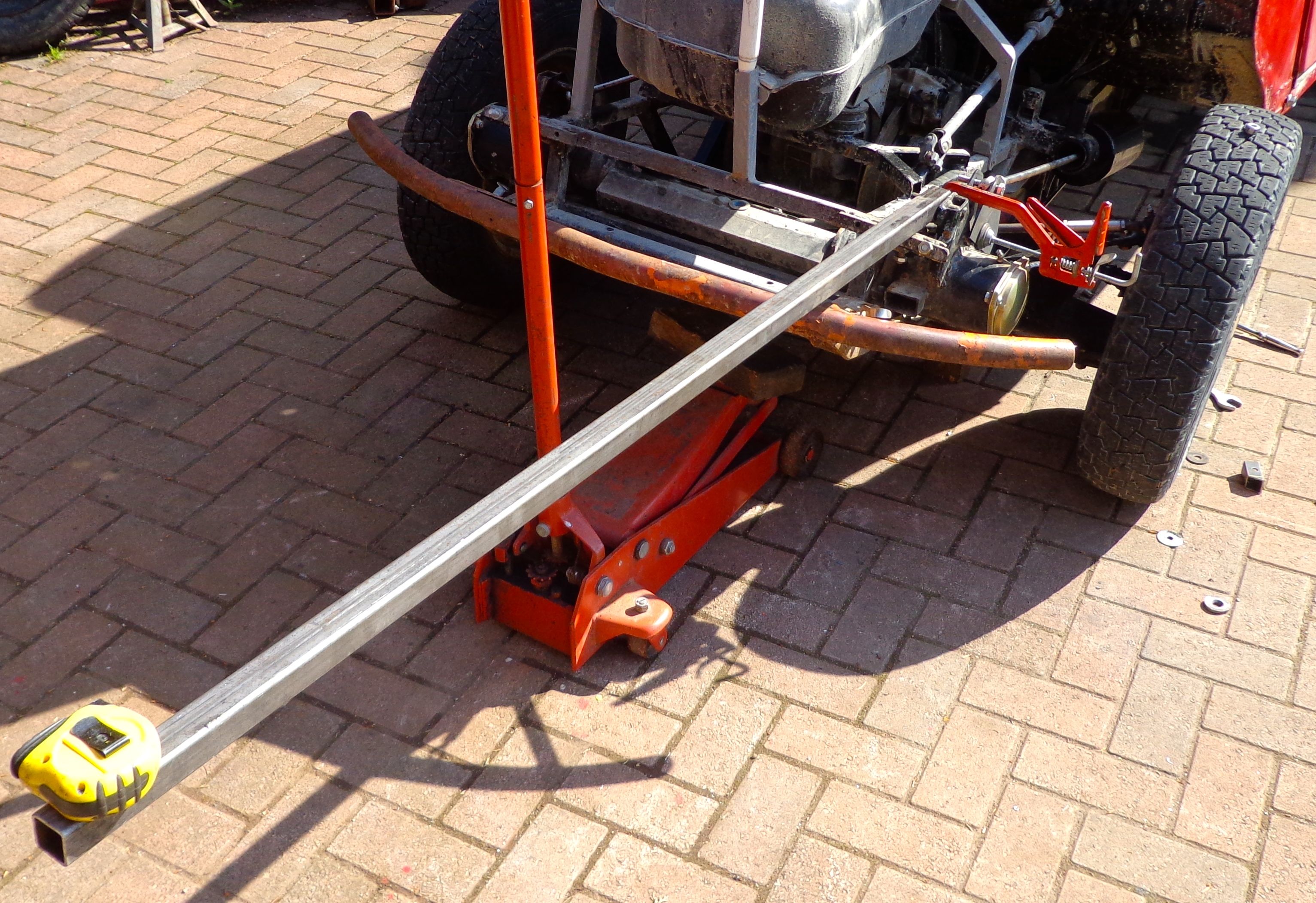

Today I used "engineering skills" ;) to fine tune my shock absorber mounts..
With a 1.5 m square tube they bend quite easily.
