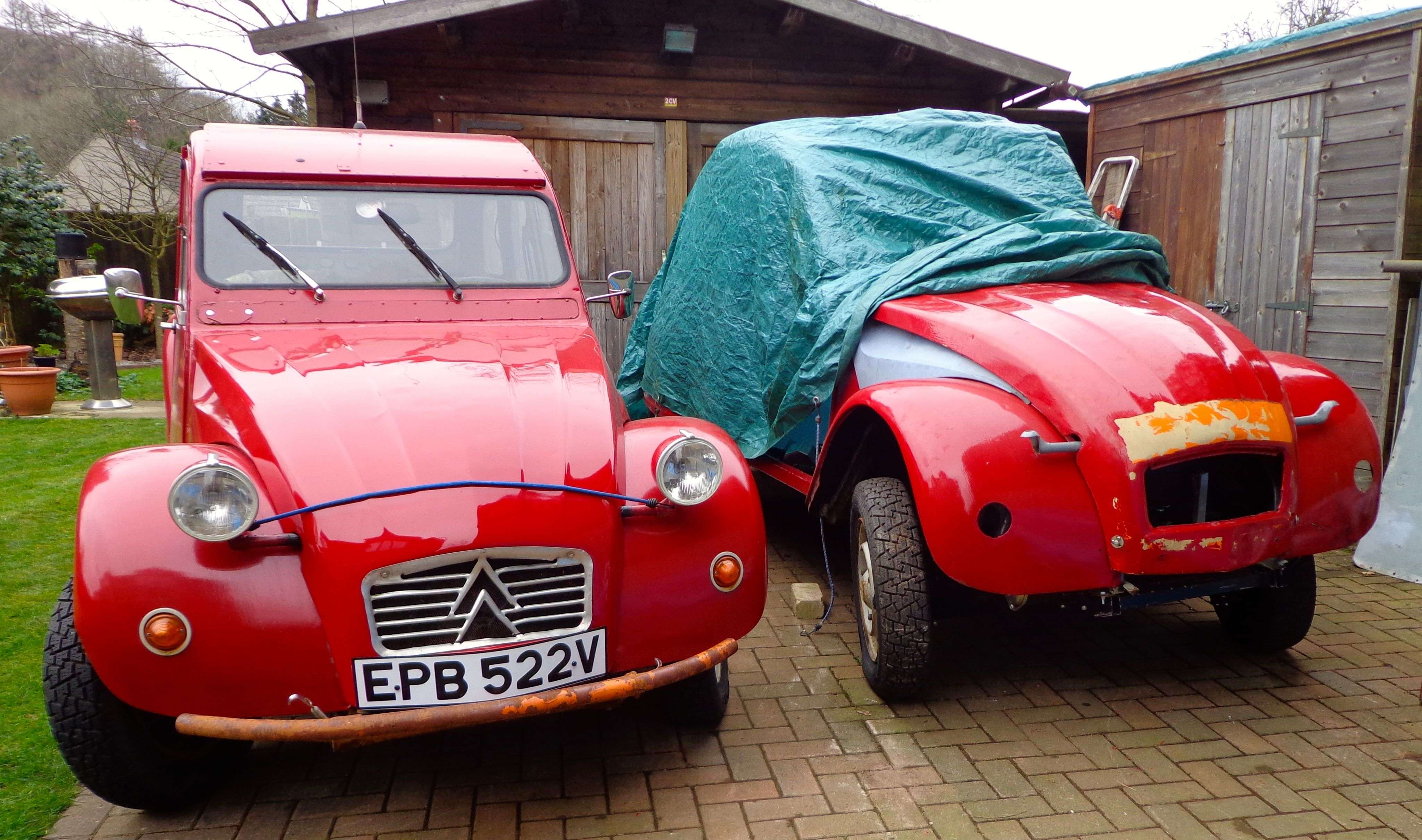

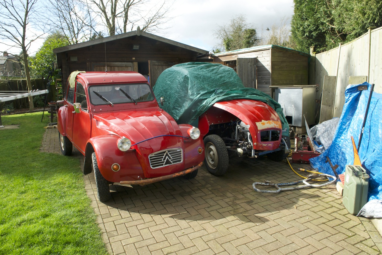

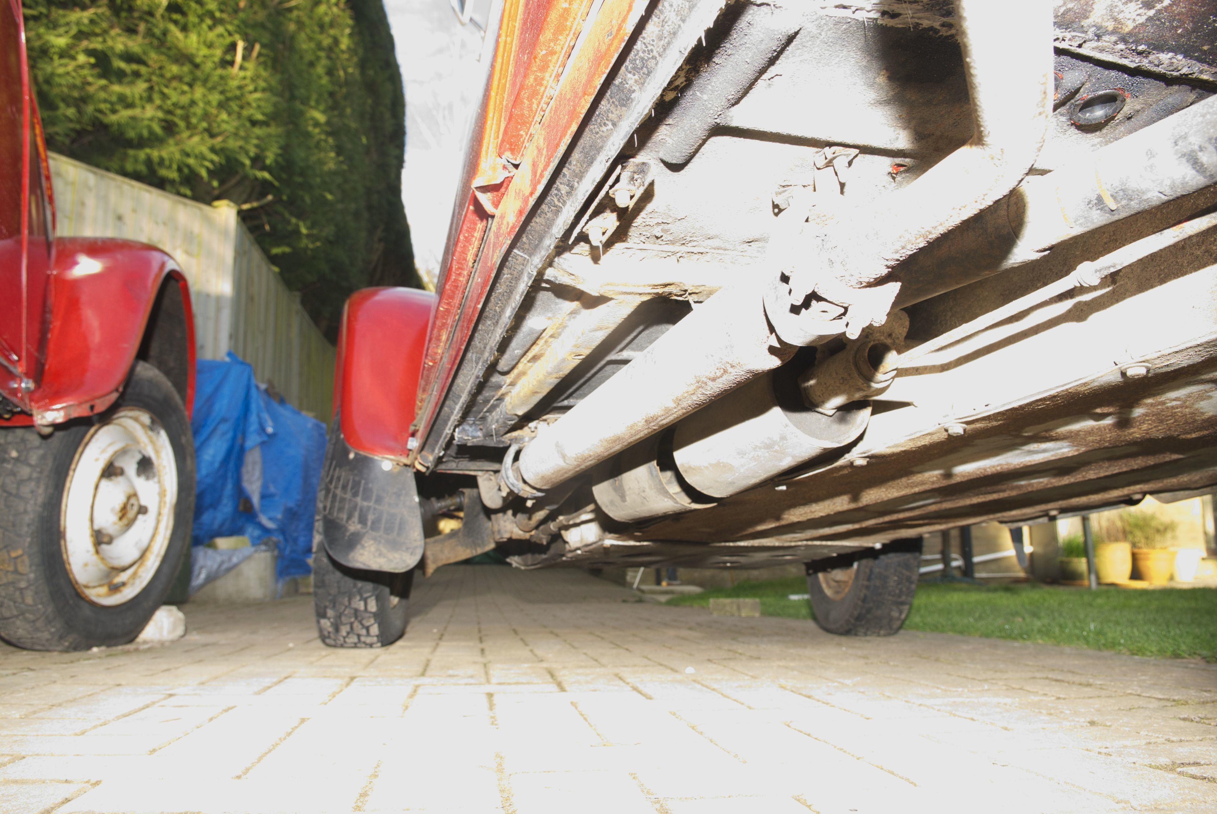

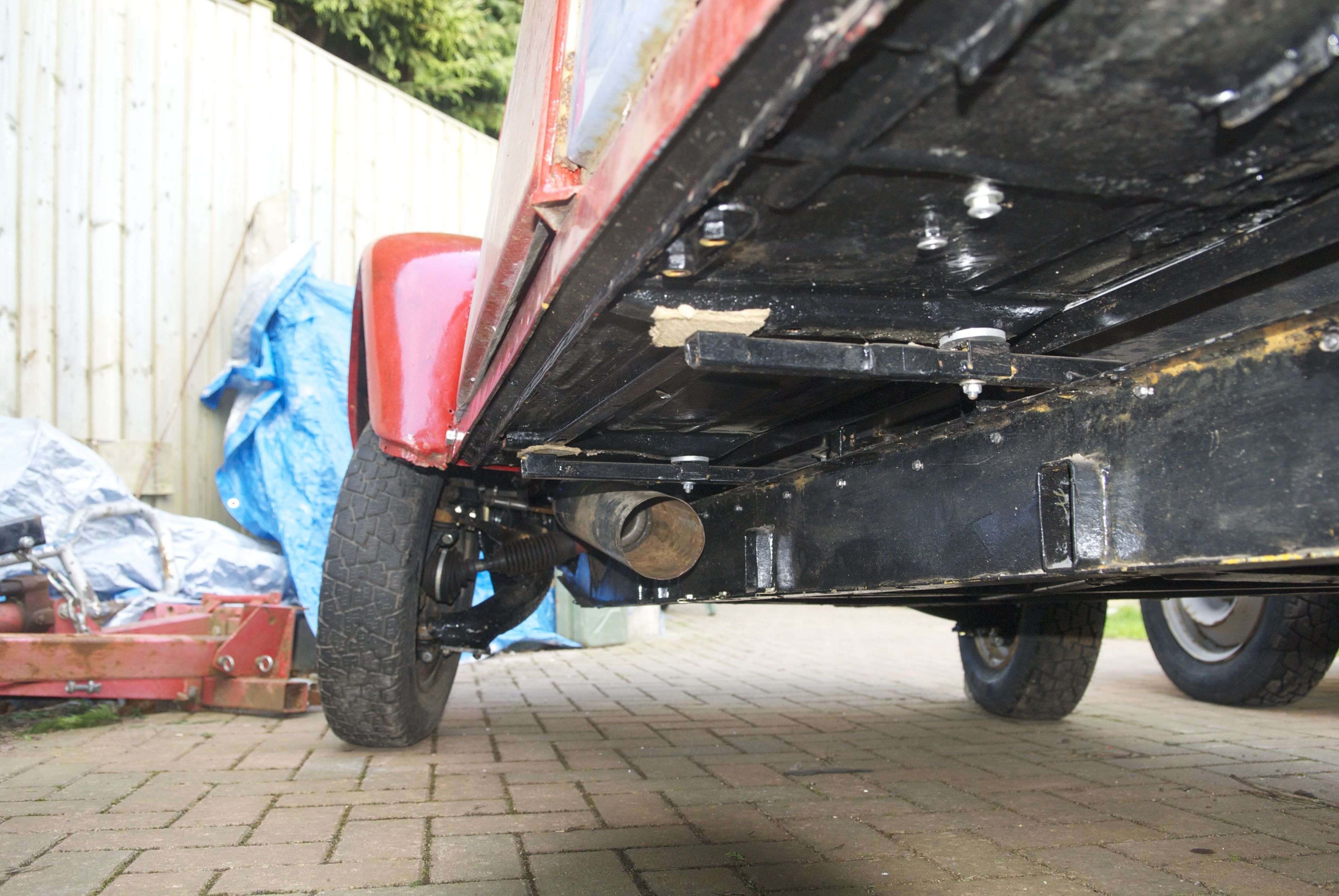

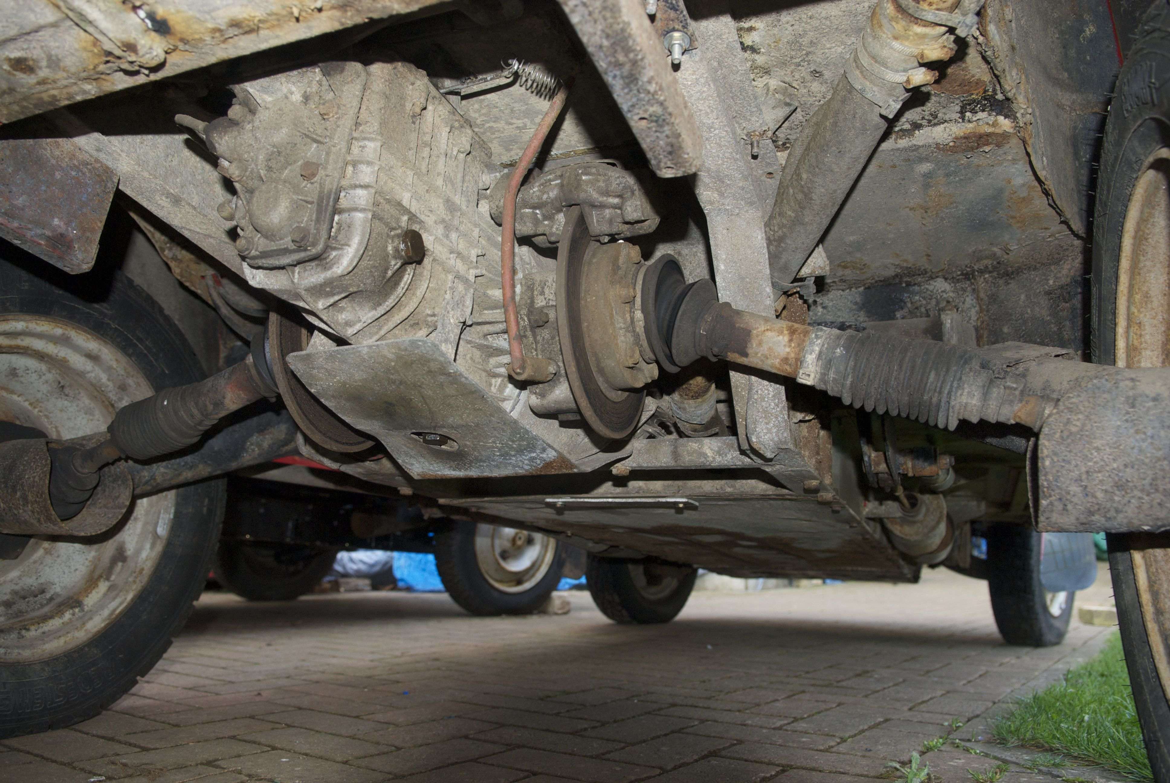

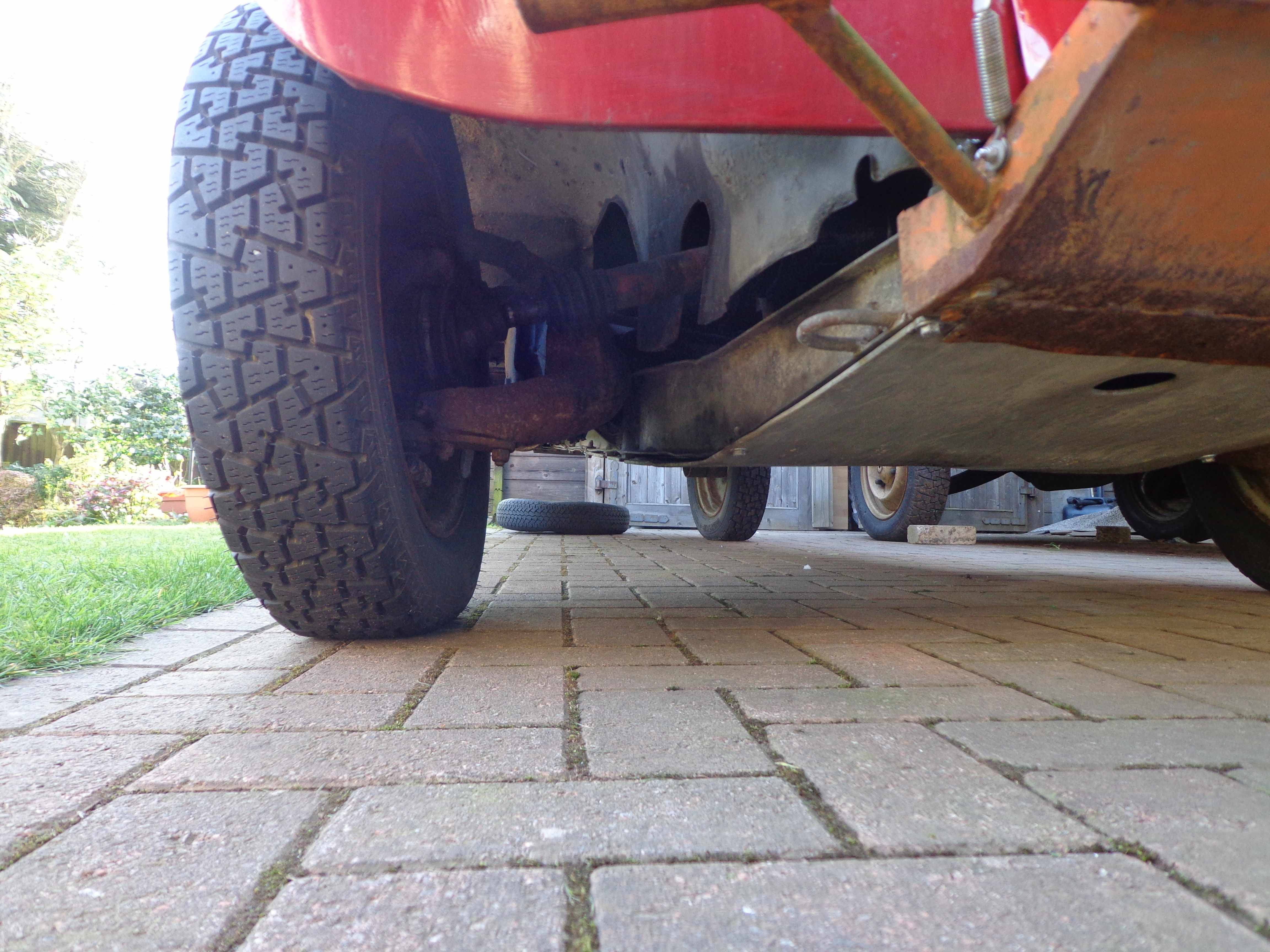

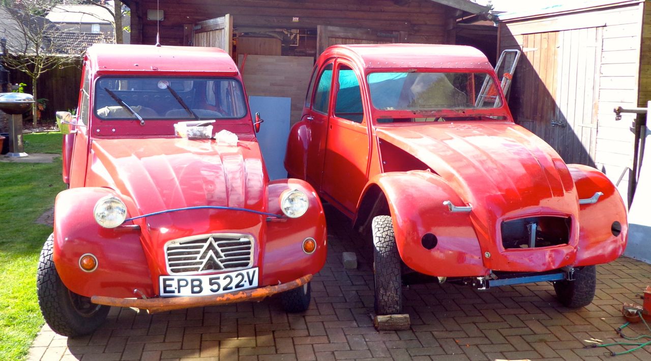

Some comparison images...
Front Barbour 4x4
Front New 4x4
Rear Barbour 4x4
Rear New 4x4
Side Barbour 4x4
Side New 4x4

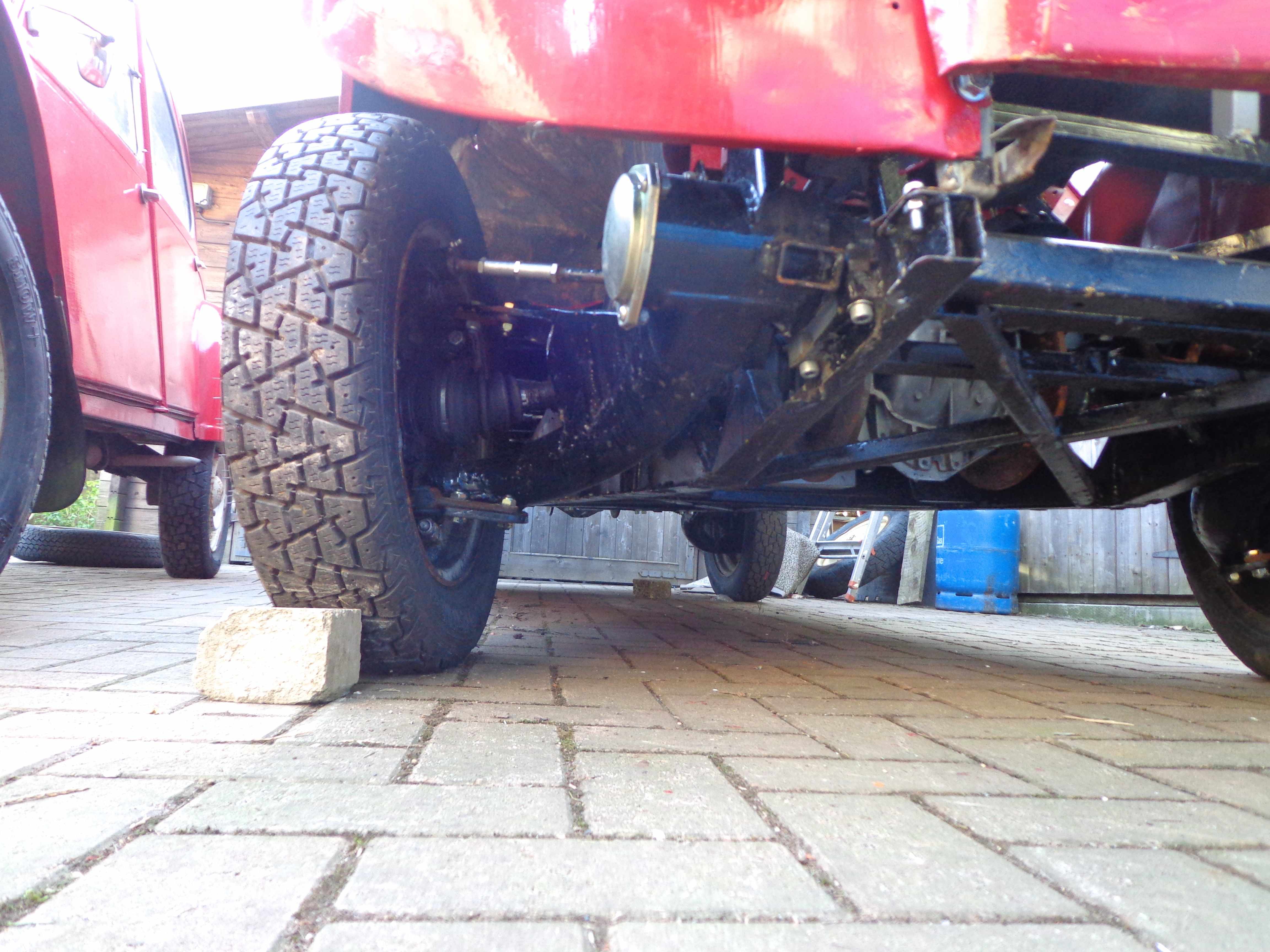

March 15th, 2014, 7:43 pm
Posts: 510
Location: Korpilahti, Finland
Pete.
Have You heard about Ackermann -theory? Inner front wheel should turn more than the outer, if not, You loose grip on front wheel when turning...
Something like that
As it can be seen from the last picture of You car, it seem to be opposite, the outer wheel turn more than inner.
That can be a problem, it makes also qreat understeering, car "want" to go straight instead of turning...
If You want to have front axle like You have, the steering rod joints must to move much outward, outer than kingpin. On normal position with 2CV steering, the joint is inner than kingpin...
Hope You are thinked about this, if not, I'm sorry that didn't mention that before... :oops:
March 15th, 2014, 8:12 pm
Posts: 2258
Hi Jasu,
Ok on the steering, the arms have been altered with a lot more castor angle added, its first drive was ok but may need some more adjustment.
Cheers
Peter
March 15th, 2014, 8:31 pm
Maybe you could swap the rod ends side to side to counter that, if they fit within the wheel.
