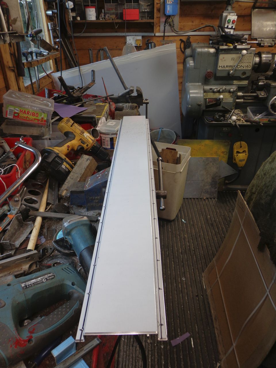

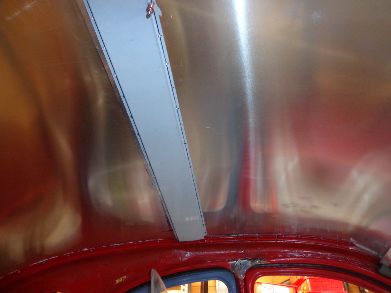

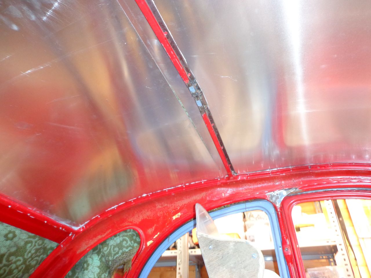

Easier Job Today The Roof Joint.
Roofbar is not straight because of adding the extra width.

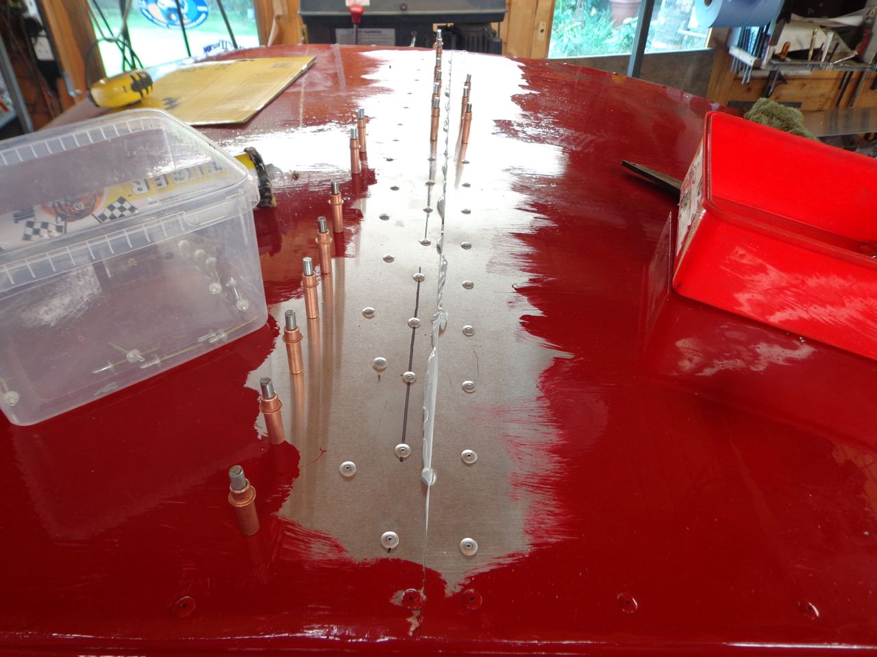

Local Engineering shop has a hydraulic bender, got this channel bent up..
Inside View
Top View

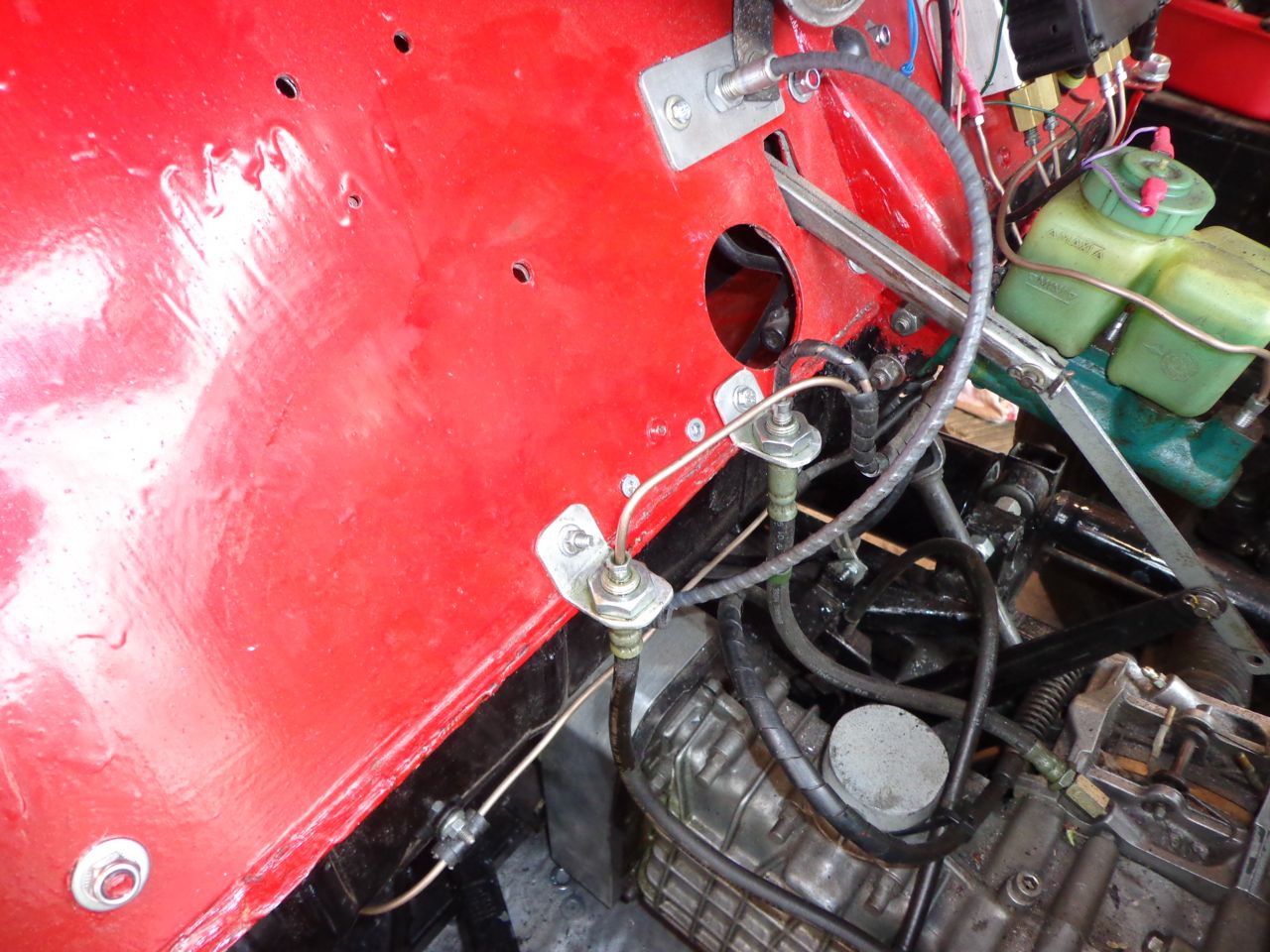

Moved the brake pipes so that they don't foul the Hand-Brake cables.

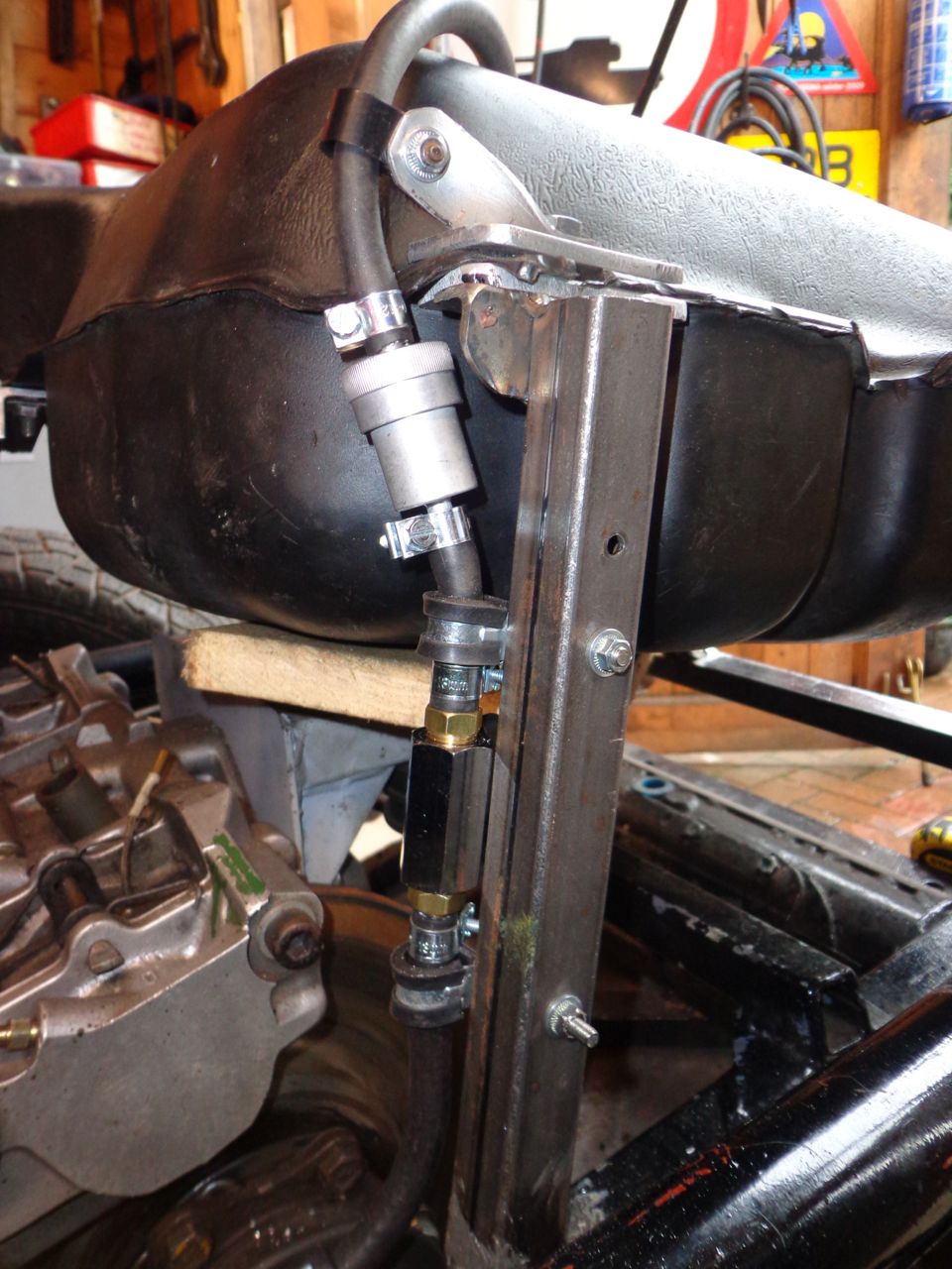

Fitted Fuel Tap and Filter.

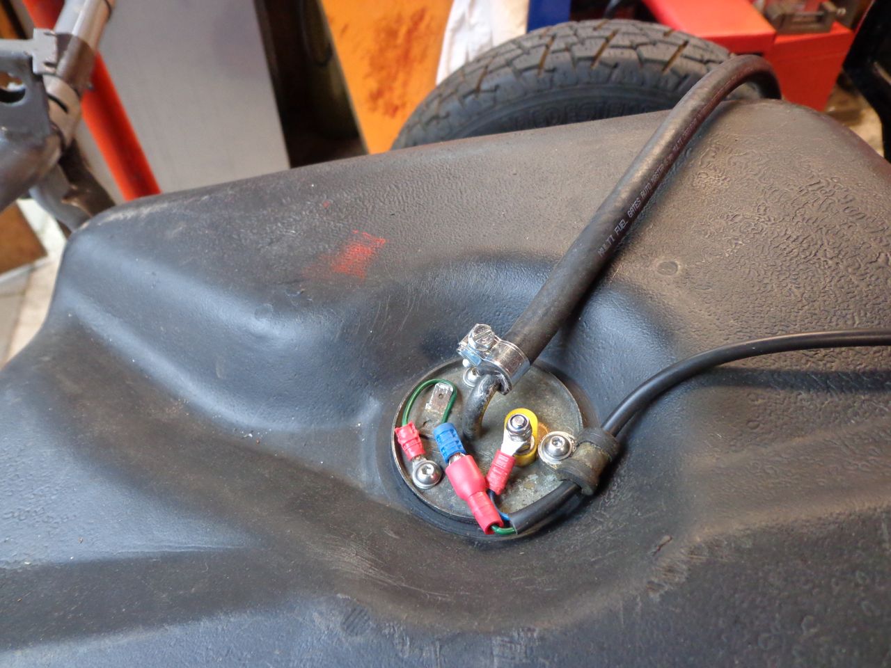

Repaired the Fuel Sender.

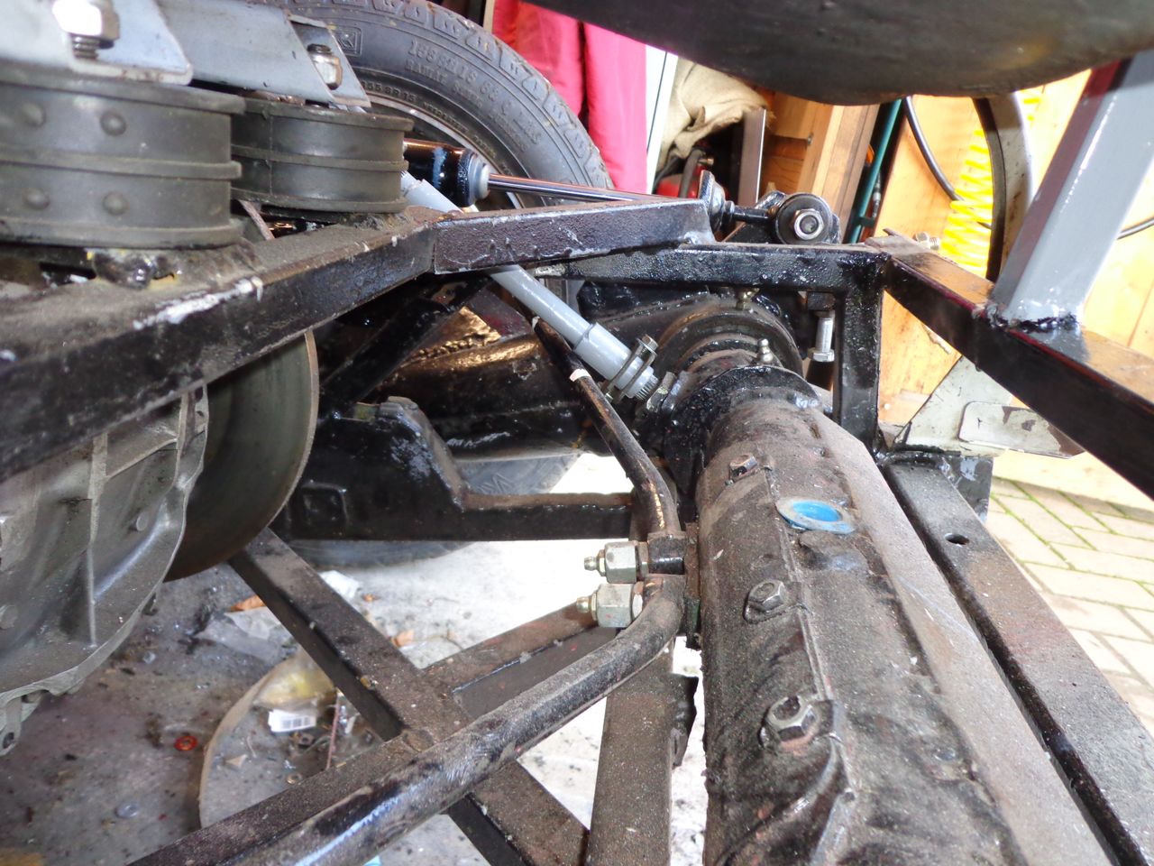

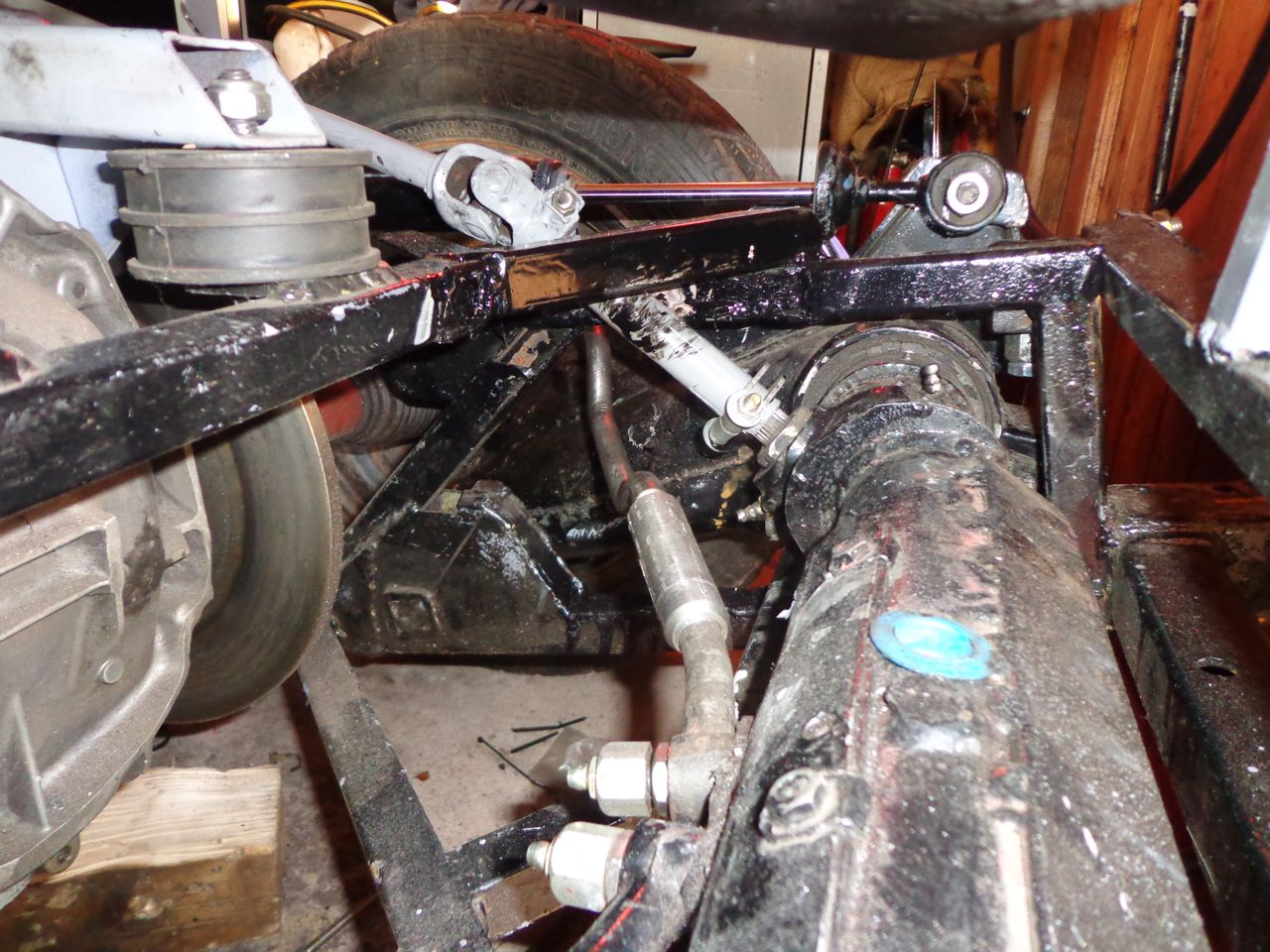

Front Suspension Problems!
With the suspension on full compression, the steering tie rod would hit the steering column.
Solution was to rotate the rack clockwise in the saddles and put a bend in the tie rod.
Still have problems on full lock!!!!!!! with chassis getting in the way.

I can't see where the chassis is getting in the way but it's hard to tell what is what in there!

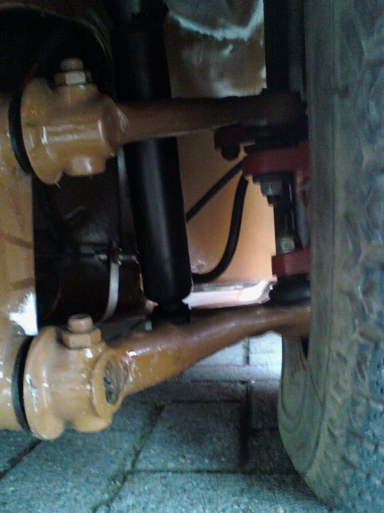

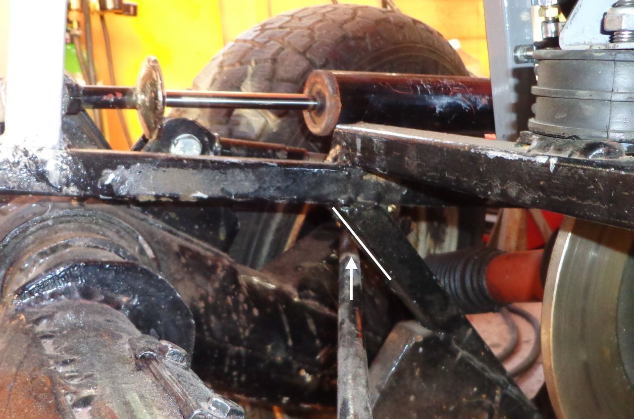

Another pic
Full Lock, Full compression
