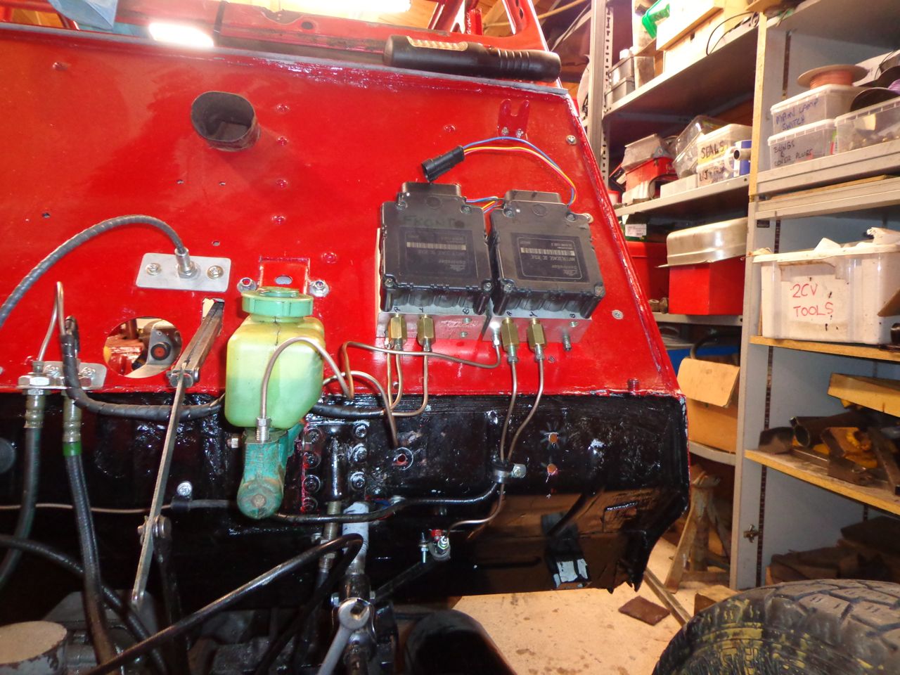

Brakes - Bleeding Brakes.
Have made brake "Line Lock" for both the front & rear, utilising the valves inside a BX ABS controller.
