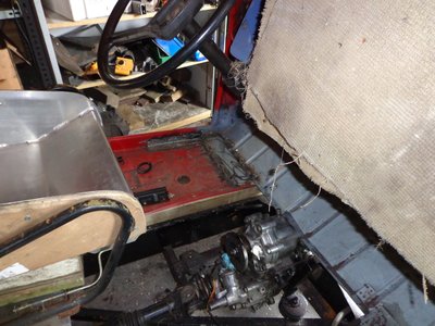

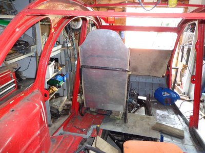

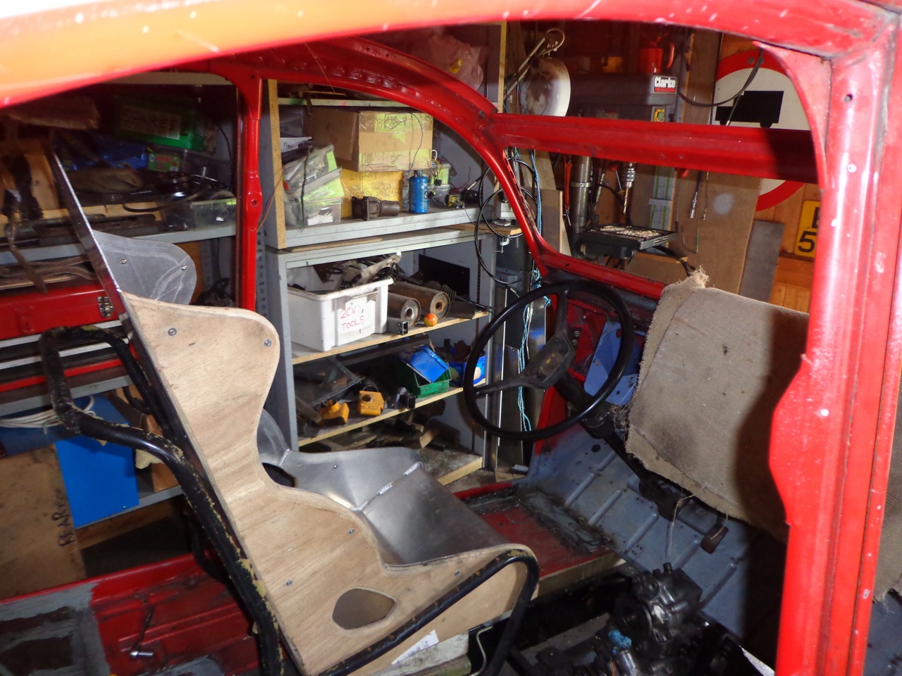

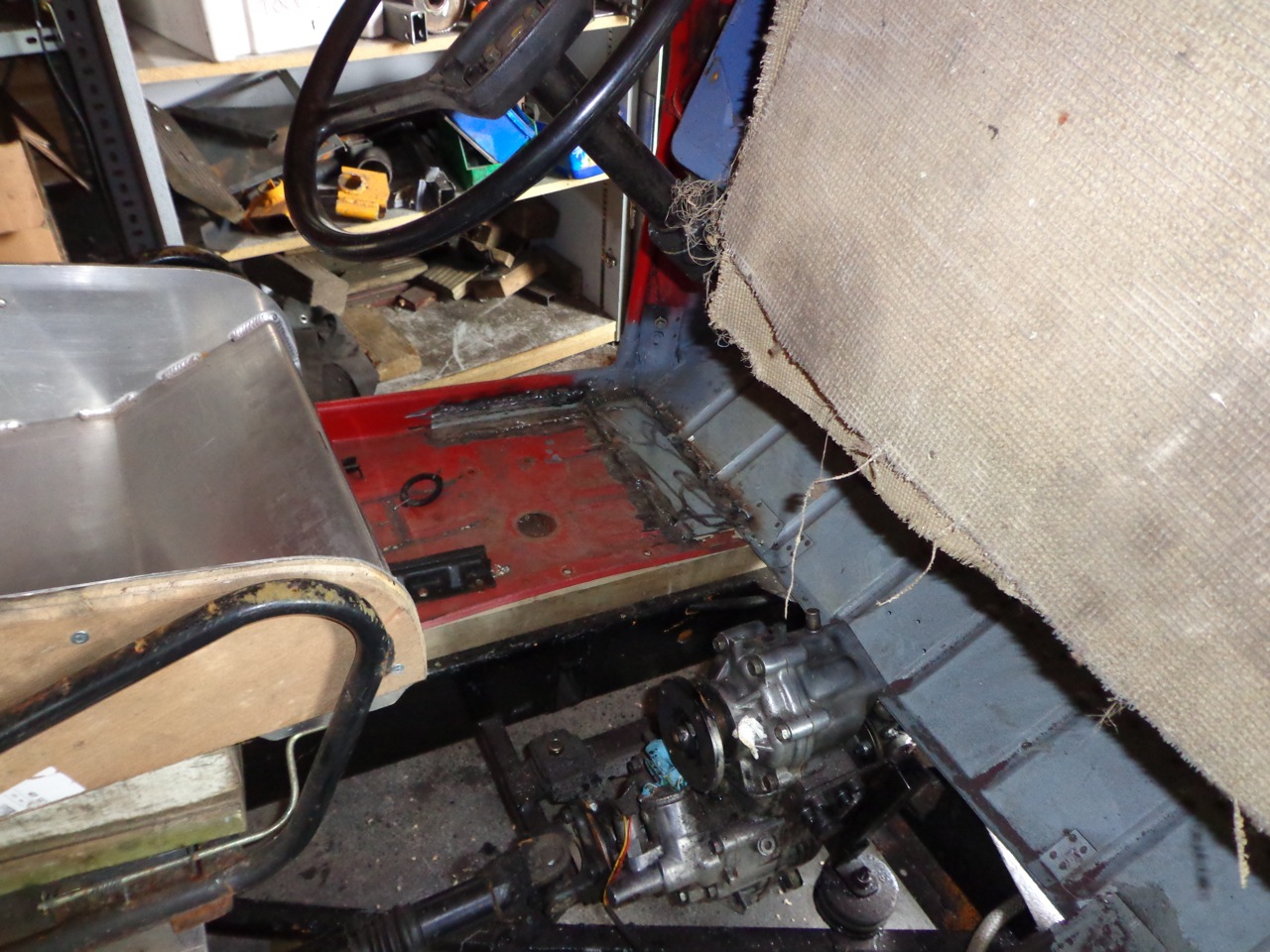

Seat Mounting.
Planning to use the bottom part of a 2CV seat to mount the home-made seat.
Floor and Sill Patch and De-Channeling.
Body sits 25mm above chassis, used part of a builders plank.

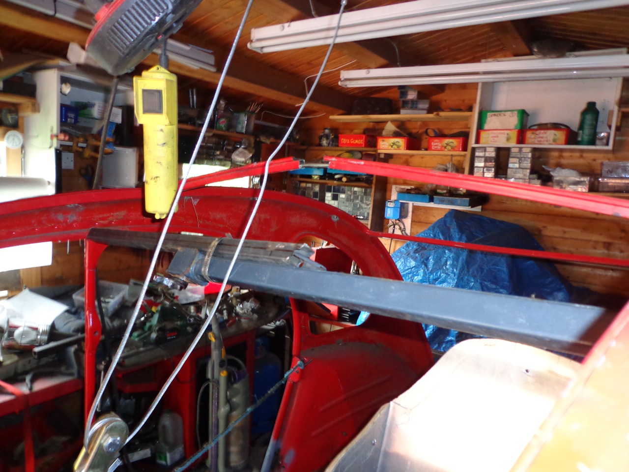

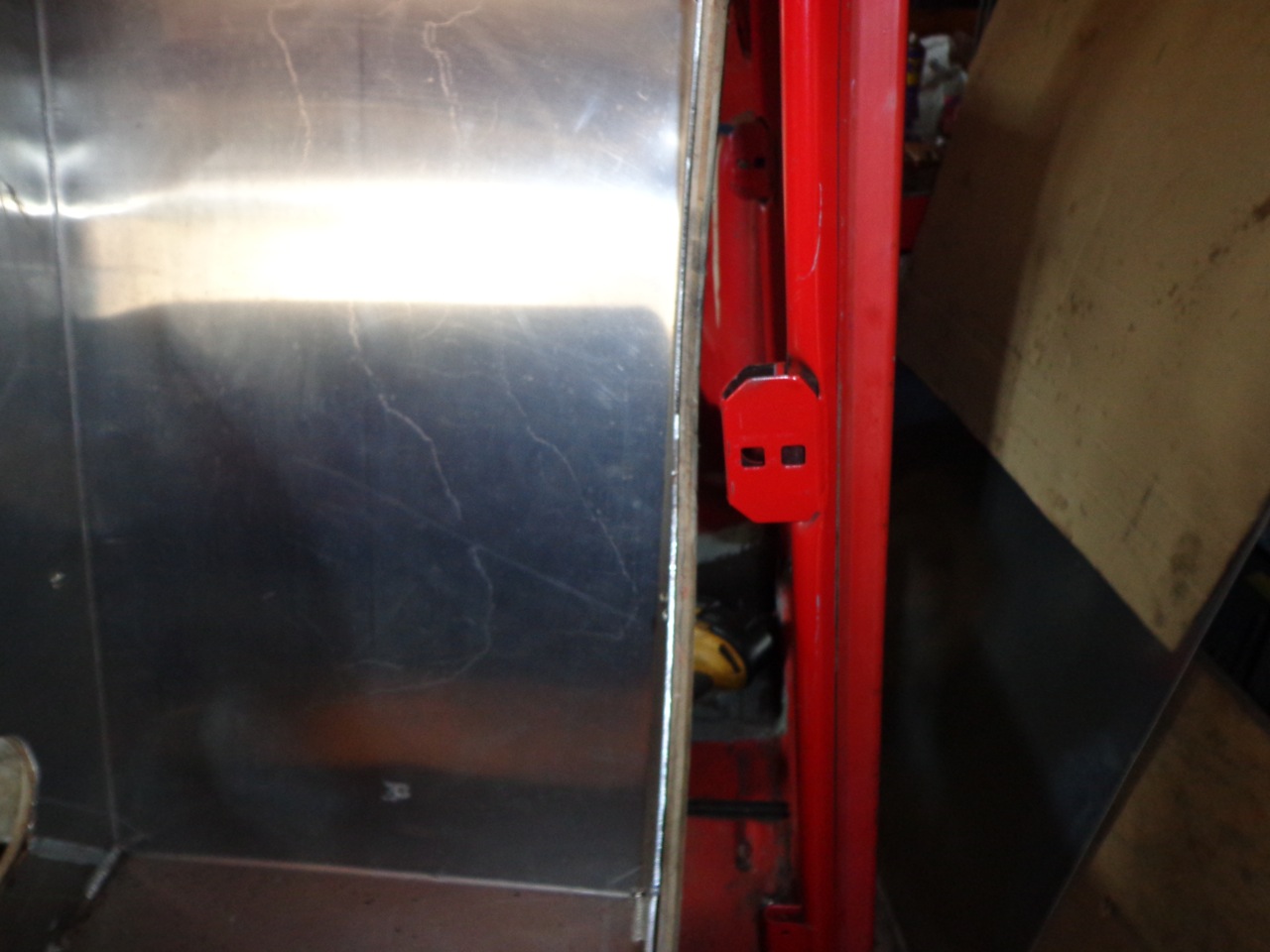

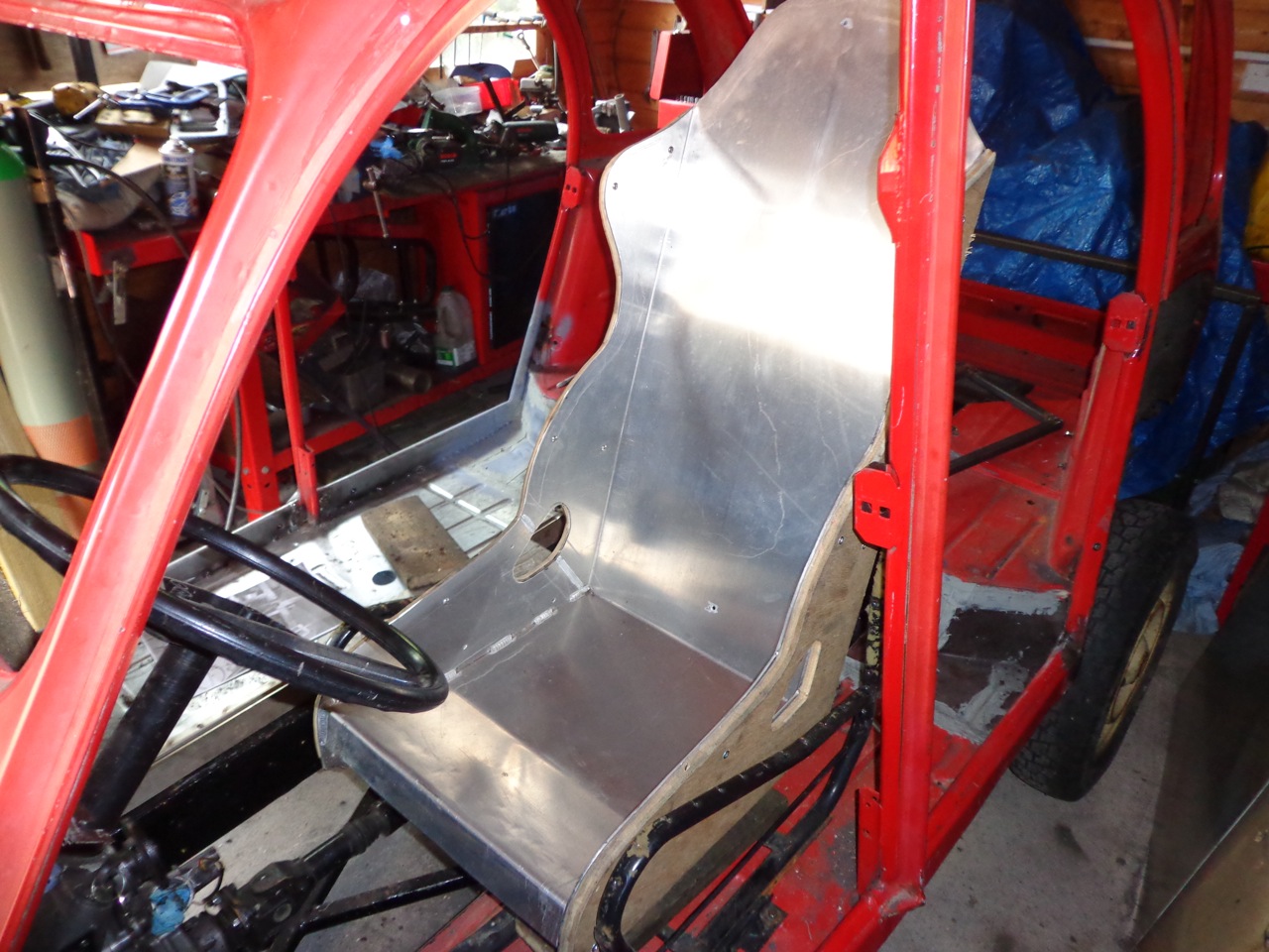

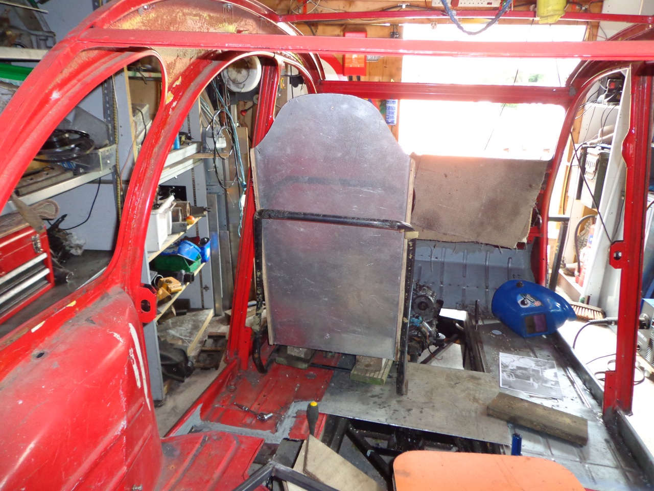

Seat Problems...
The clearance between the door catch and the seat is zero.
Cant make the seat any smaller, (my hips) and needs to be positioned so that the gearbox with cover have sufficient space.
Had a brainwave, to widen the cars shoulders.
With my trusty jack have added 75mm
Gives about 30mm extra by the door catch.
