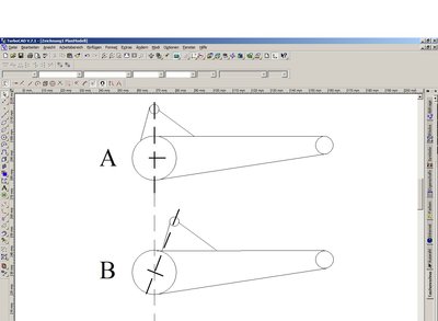

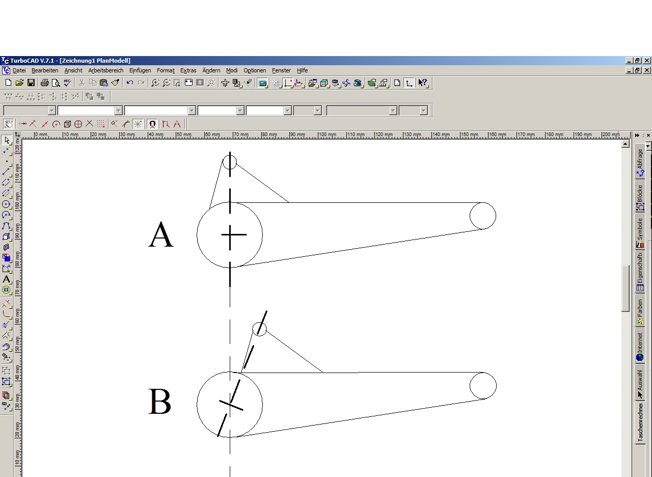

Theres no space to make longer brackets.. However I changed the position of the point where the Airsprings go to.. (can't explain in Englisch) I now have a sort of progressive suspension which seems to work fine..
Yesterday evening must have been a strange look for passers-by.. Me jumping on the back of my 2cv.... as if it was a trampoline.... but it works for me now.....
Heres a pic of the bracket mounting vs middlepoint of the arm....
Now I'm using solution B...

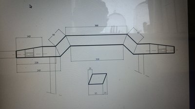

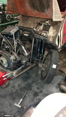

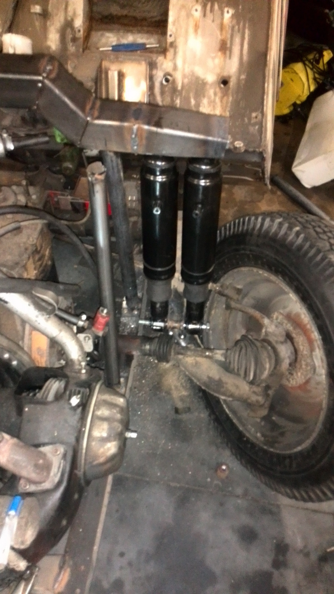

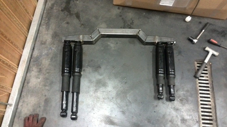

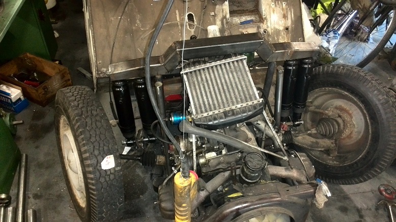

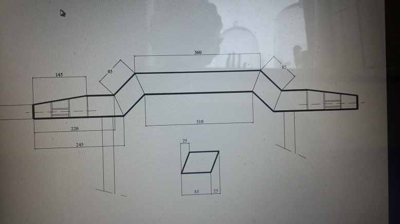

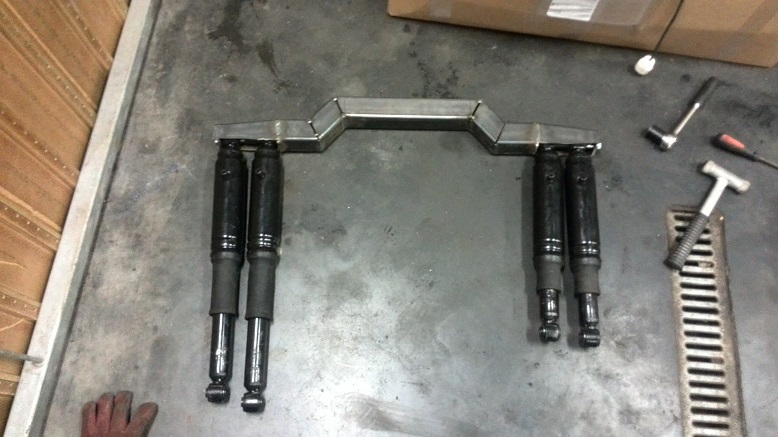

Here are some pics of the front end..
Made a bridge to host the air shocks, going over the gearlever.
