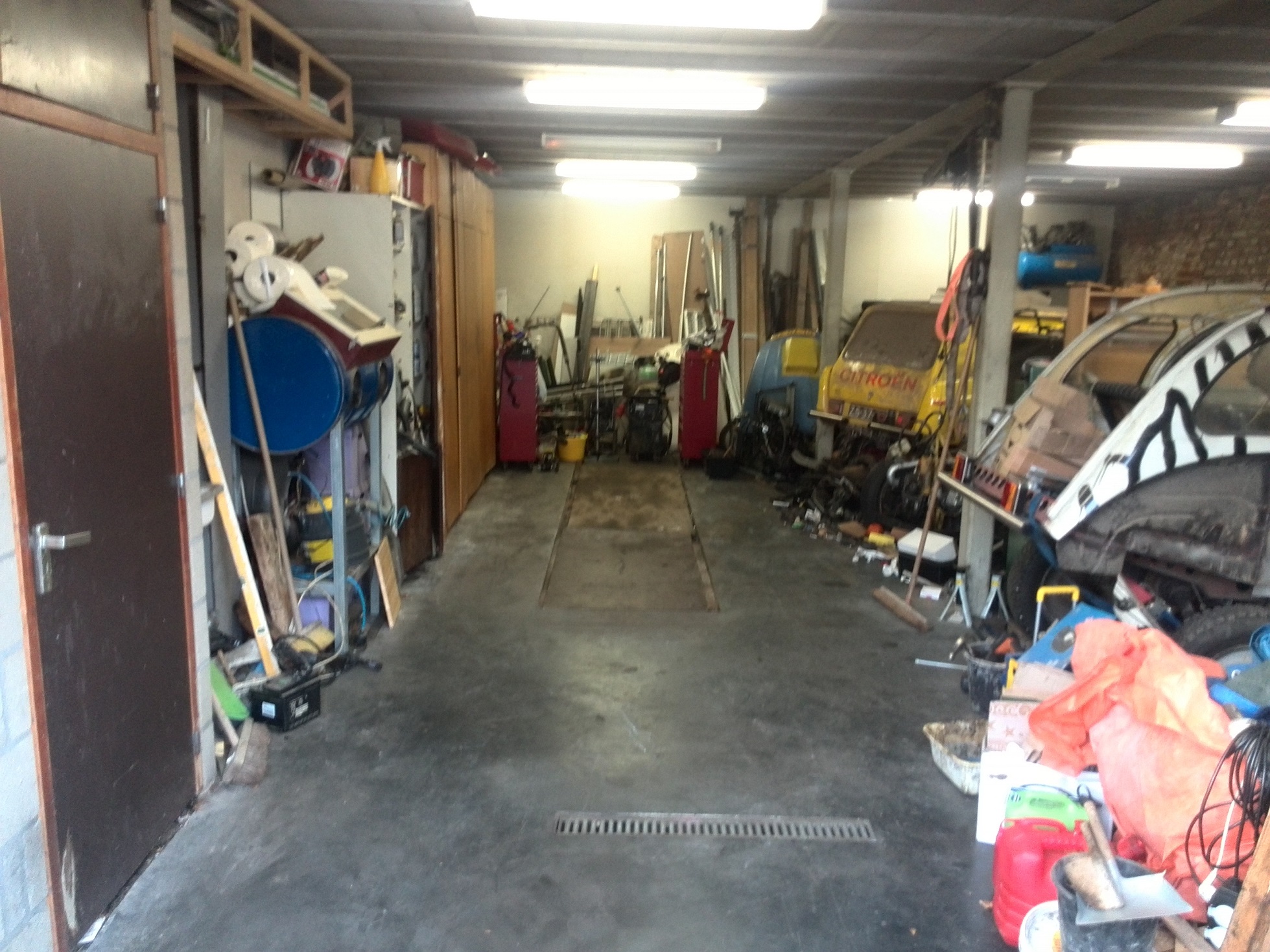

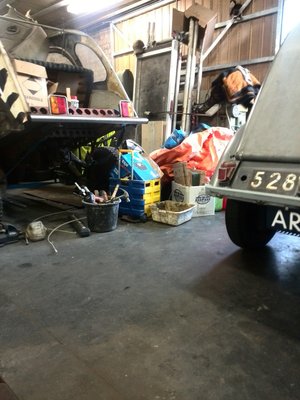

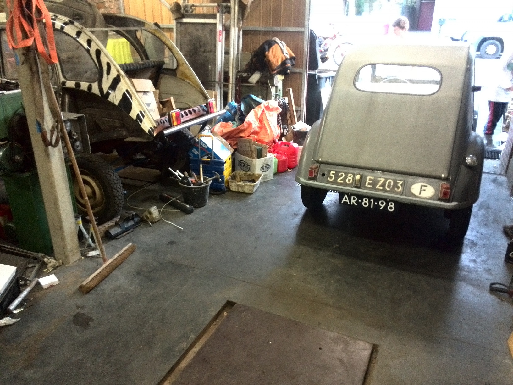

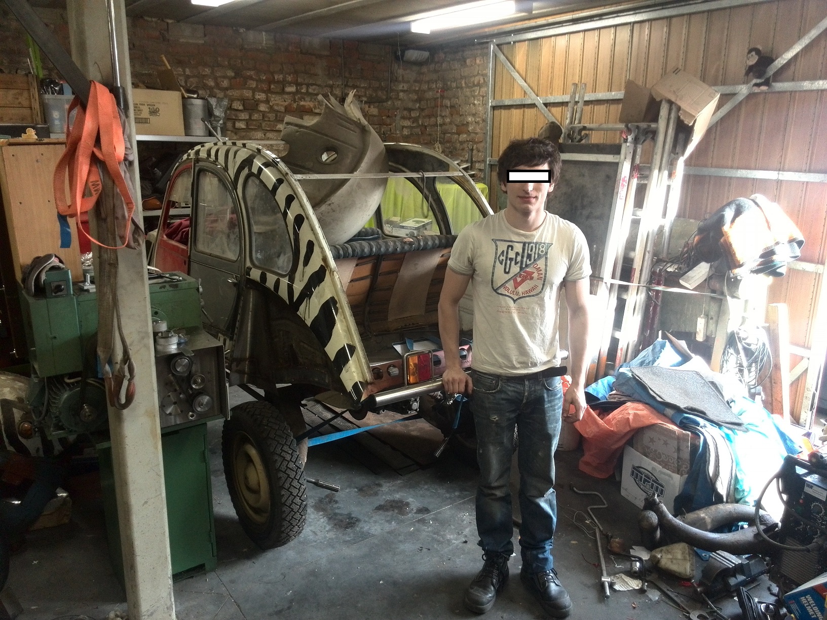

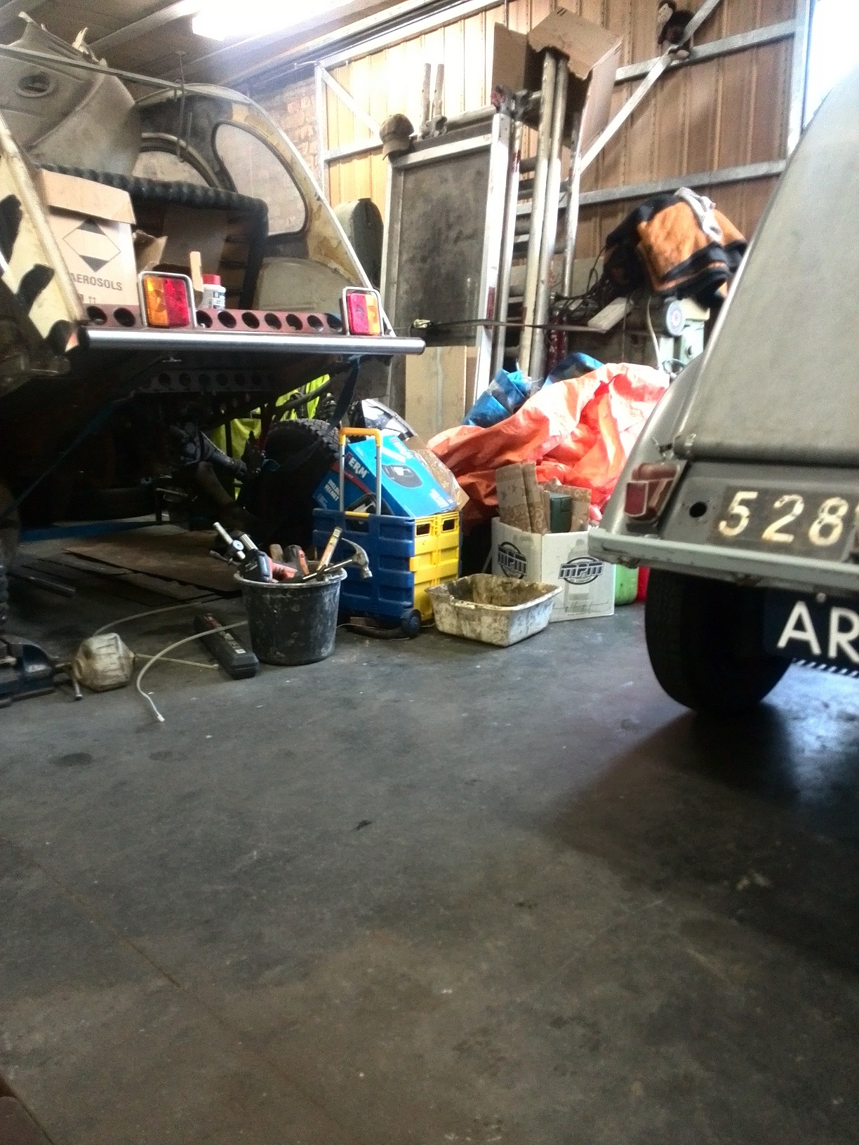

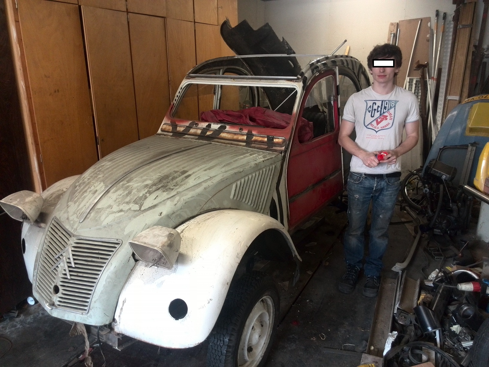

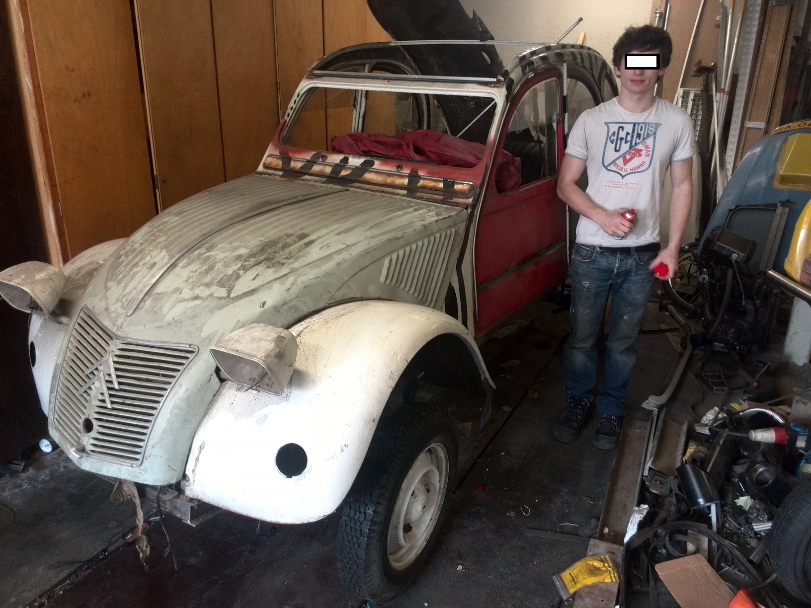

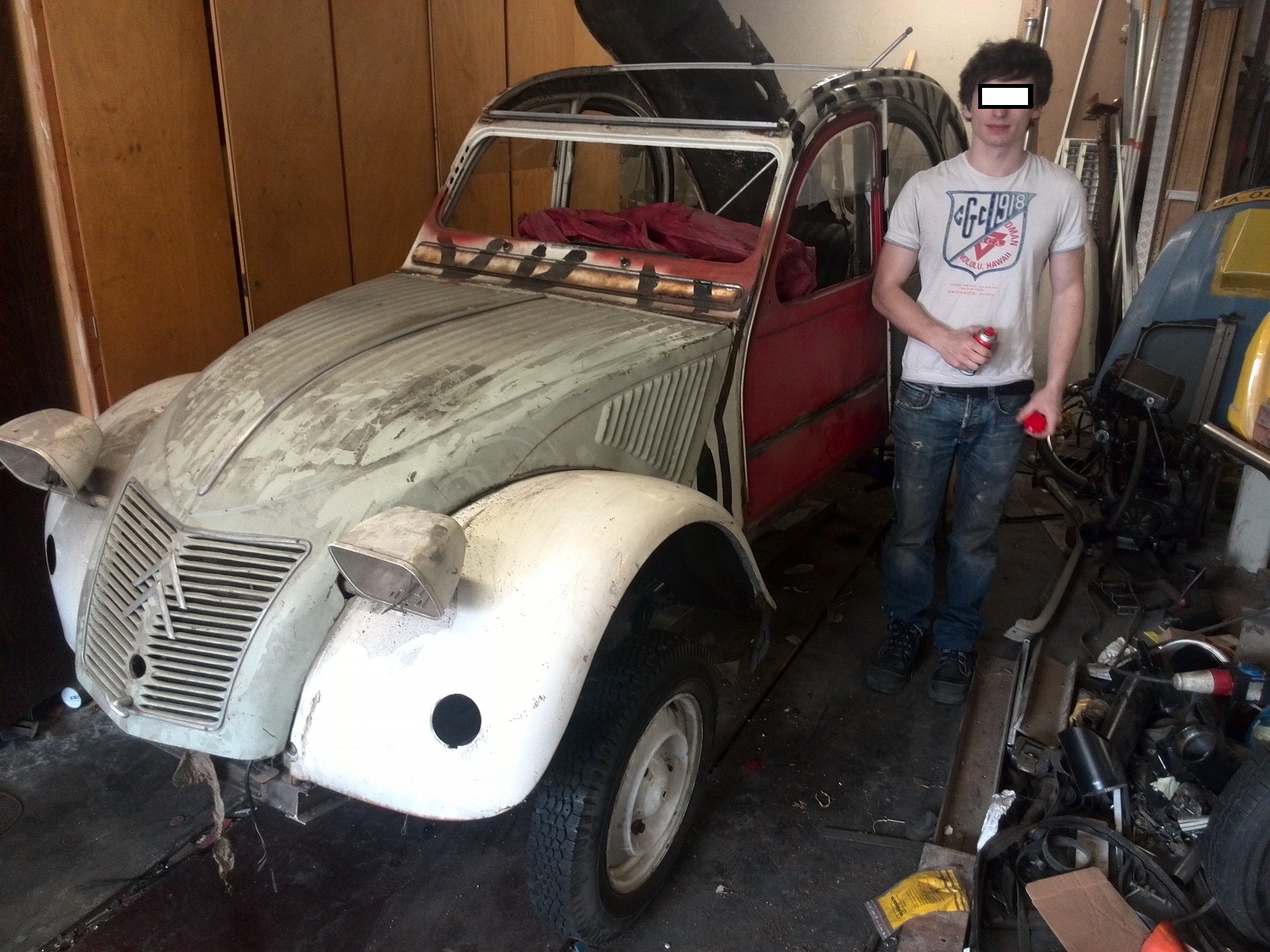

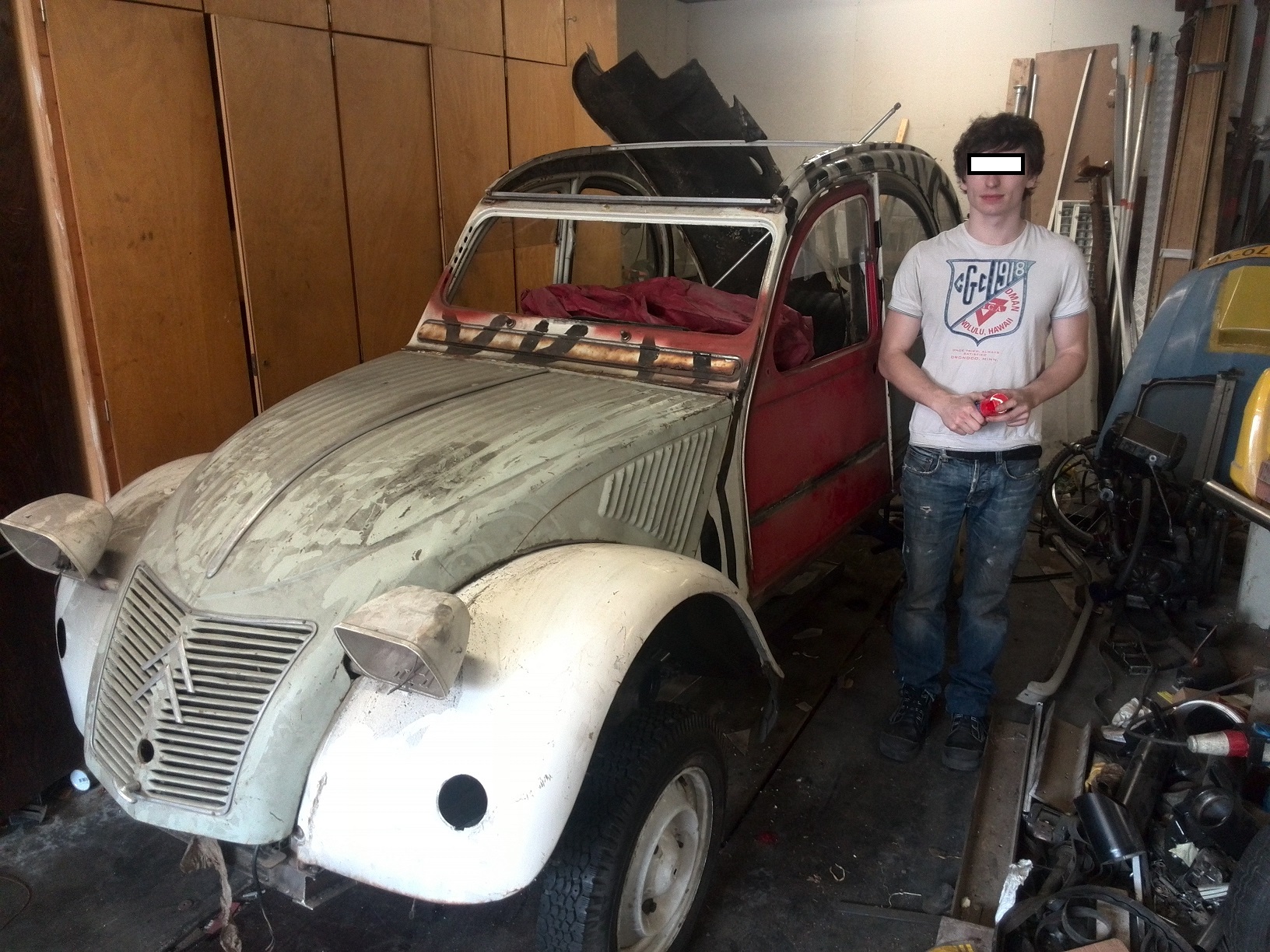

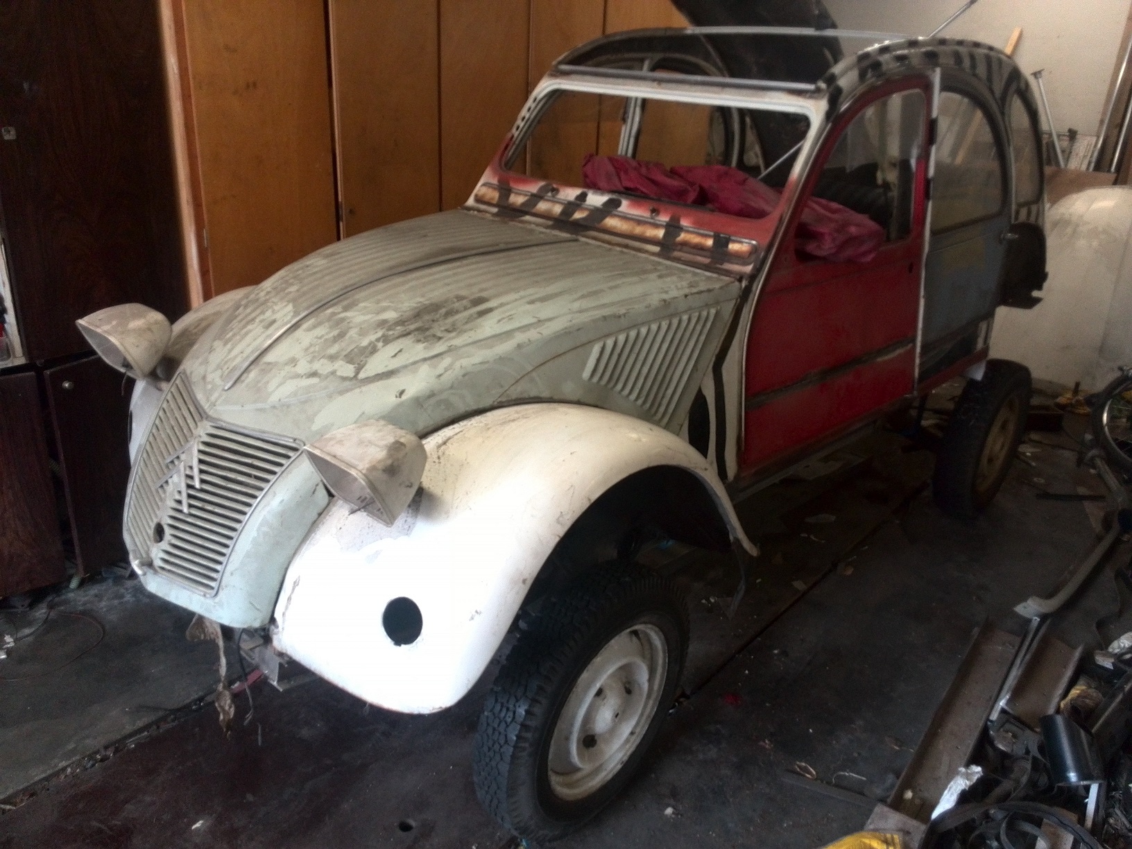

Had a little clean-up in my garage today...
Putting my 4x4 on it's own wheels by 2 pieces of square tubes connected to the knife edges.. Put it in the highest position.. Well I think it is a little frightning... especcialy the rear-end
Standard 2cv versus 4x4..
My stepson; 6 foot tall for comparrence
Welcome to the high-bumpered garage :lol: :lol: If you take a good look you can see the beamer engine on a standard hight chassis in the middle.

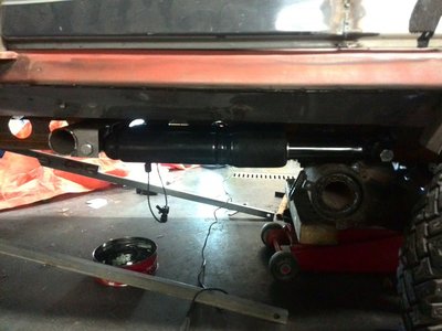

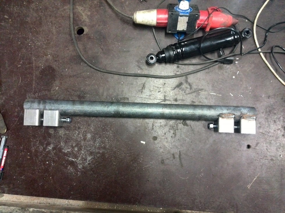

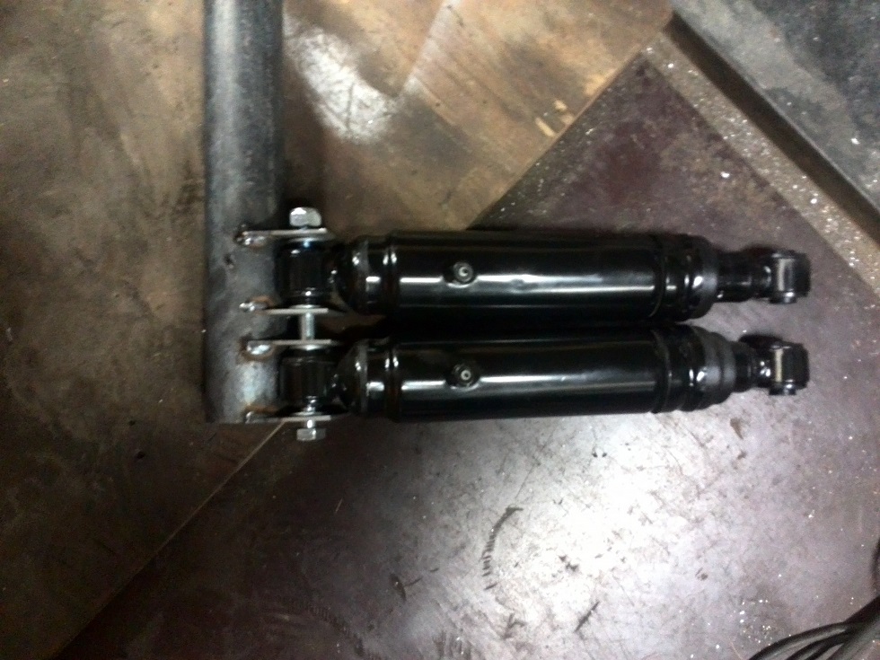

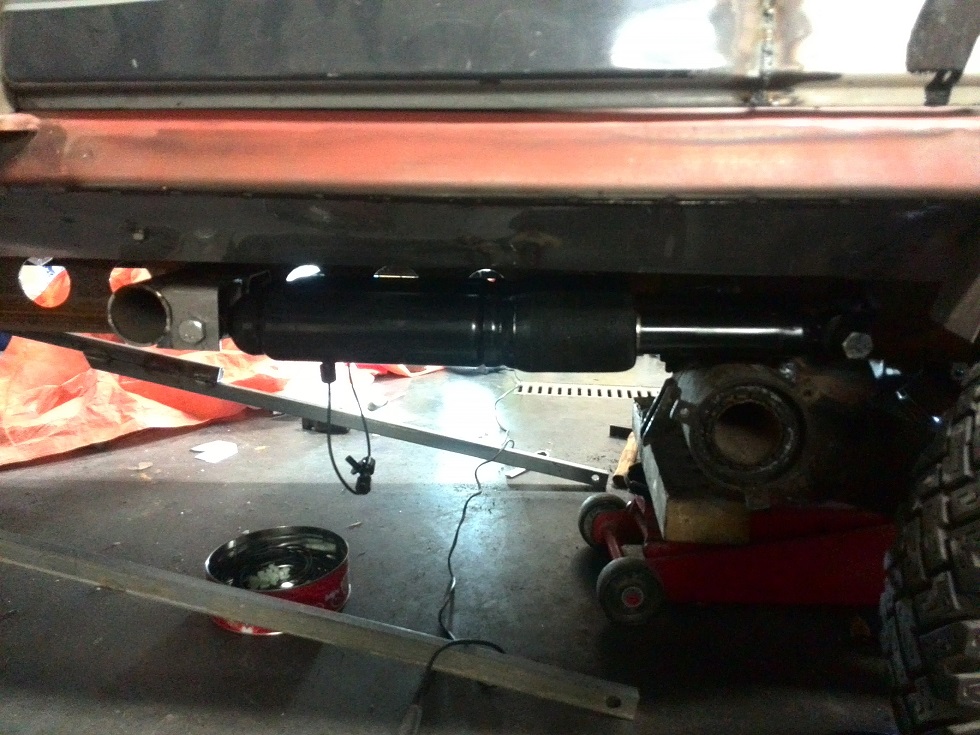

Last year around this time I bought some airshocks and today the time has come to put them under my car.....
So here we go....
First I bought some steel tube 60mmx3mm to make a cross-tube through the chassis..
Then I attached some U profil 60x60mm to host the airshocks..
Some sawing and welding and dryfitiing the shocks

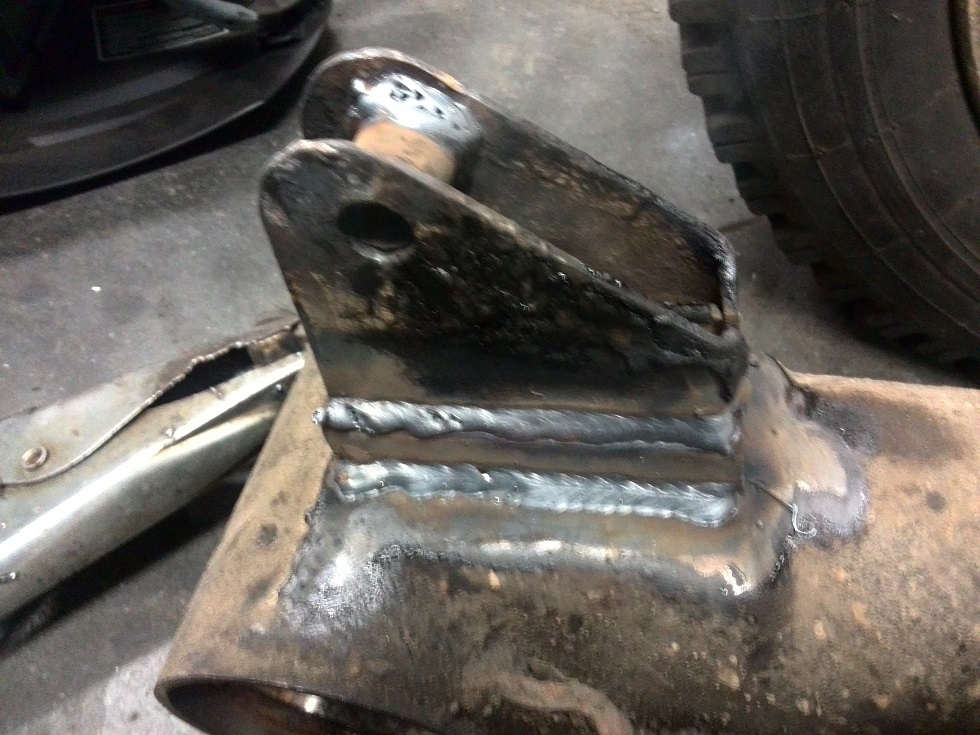

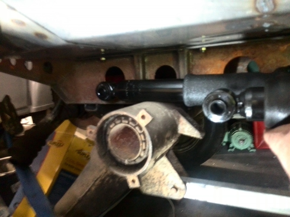

Next is to put the tube through the chassis and mount the other two 60x60 U-profile..
As you can see the mounting eyes at the wheelarm needs to be on top of the axle, so lets modify the arms..

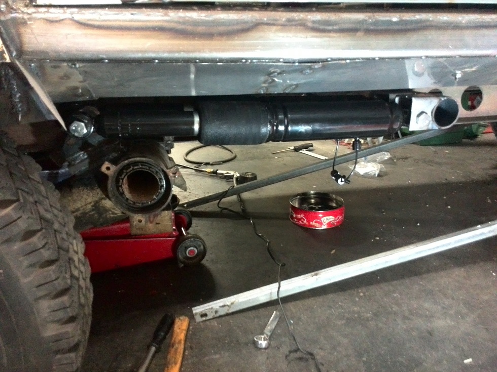

At last the shocks can be mounted..
So heres a little video, of the shocks... Theres only a little travel because the rearwheels
are hitting the body, next I need to modify the Louis Barbour reararms.. so then I have full suspension travel...
Full of air the suspension is very soft.. maybee to soft for raid but ok for trail-driving as I'm planning to do with it...
Maybee theres the need for 2 more schocks we will see...
