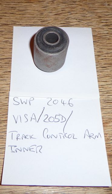

The design is more work than the the bolt thru, but I reckon its far easier to line up when refitting the engine.
@Joolz
Bush is from Cit - C15 & Visa or Pug - 205 ......Track control arm, inner bush and others i'm sure
Dims 28mm OD - Length - 35mm - Bolt 10mm.

see http://www.southwalesprops.co.uk/propsh ... n_visa.htm
April 27th, 2012, 8:50 am
Ah okay. I went with the biggest diameter I could find in the hope it would transmit the least vibration, I just wanted to check you hadn't found anything better.

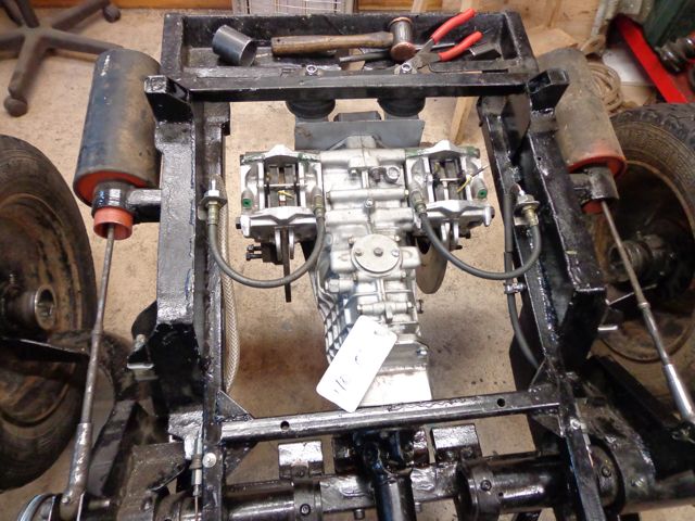

Rear Brakes.
Two lines the rear calipers. Can do fiddle brakes or (ambitious) traction control

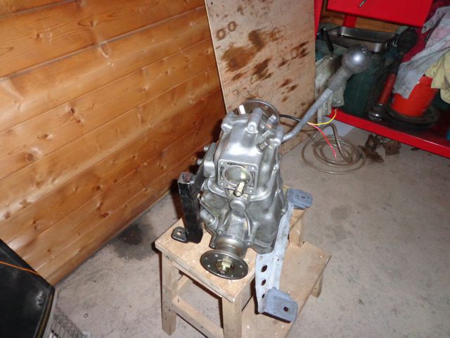

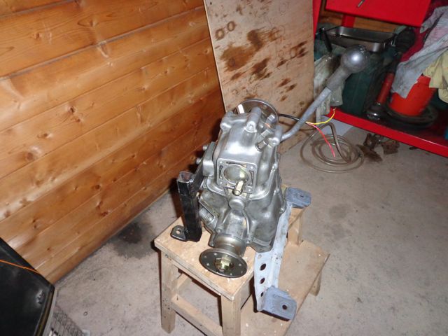

Reassembled Transfer Box.

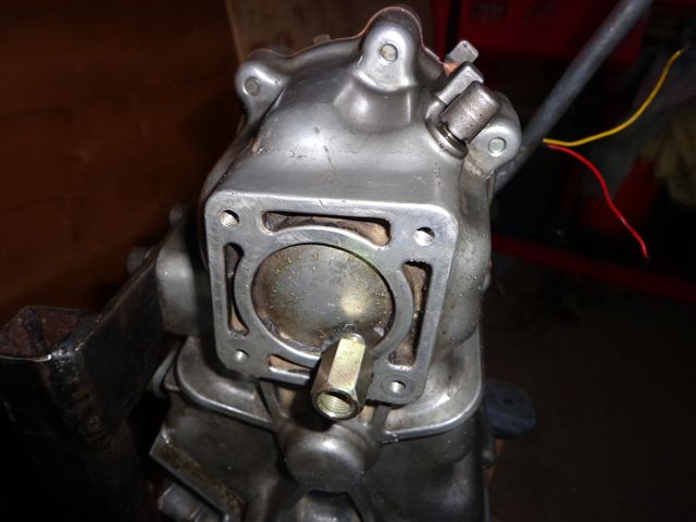

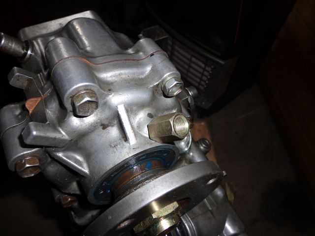

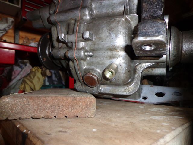

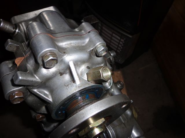

Oil Feed for top bearings
Oil supply
Solution for oil pump yet to found.

Part that bolts to engine would be tidier but ££.
Now ....3 parts + 2 nuts + 2 bolts + bush
CNC ...1 part + 2 studs + 2 nuts + bush
Fitted the new mounts to the engine, MORE vibration and noise, not ideal for a road car.
Can it be that the mounts are oversized for a small 2cv engine and therefor not
flexible enough?????? (no deflection under the little weight and movement of a 2cv engine)
Try original mounts with nut and bolt....... as said before
