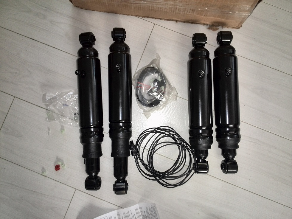

Post Re: A 4x4 is (re)born
Xmass is early this year......

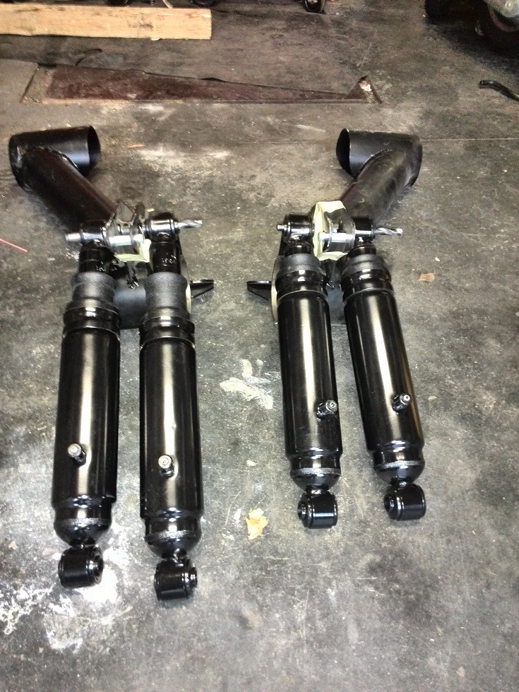

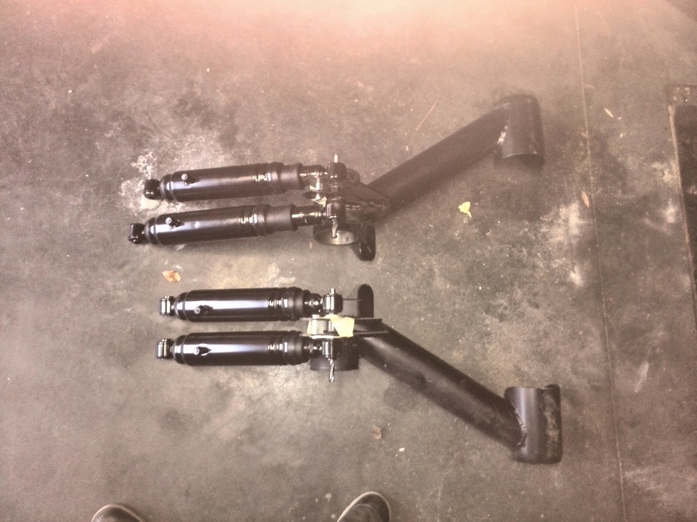

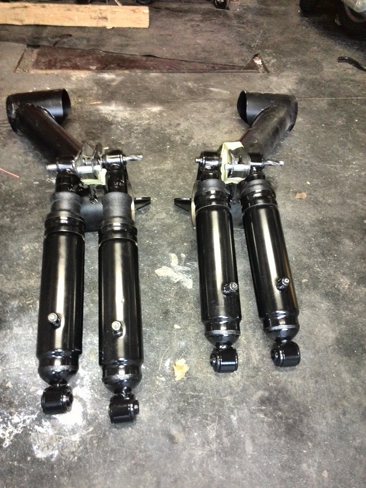

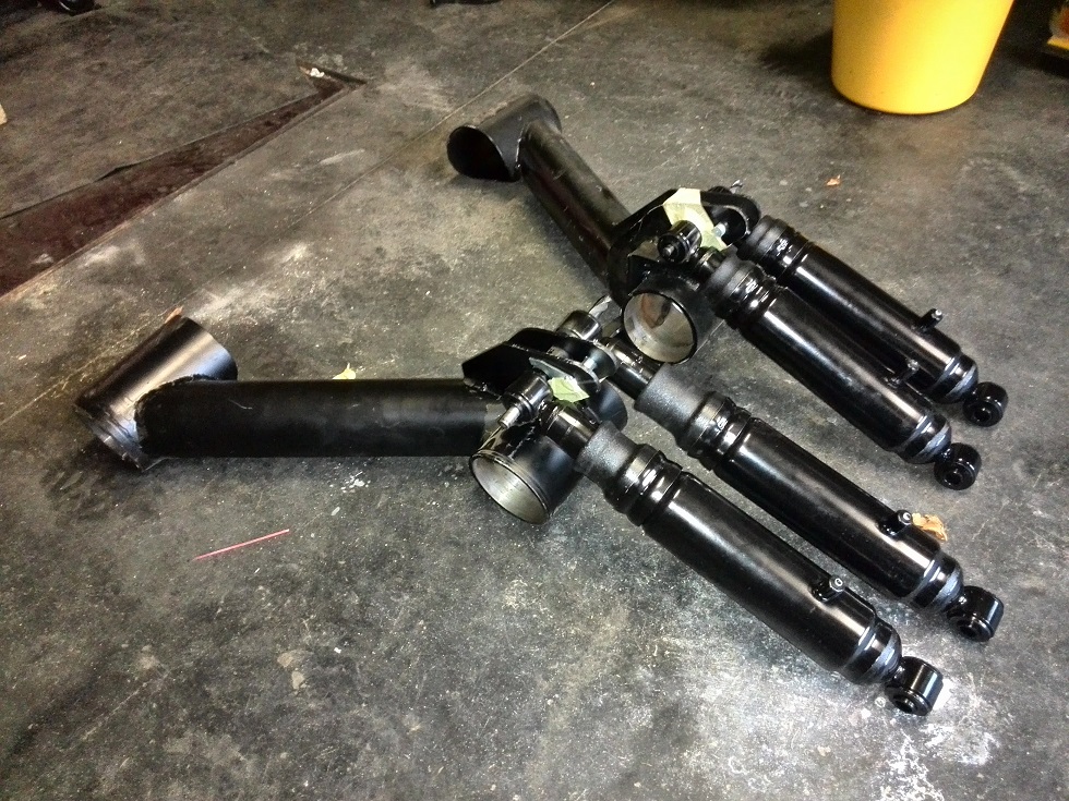

Now this rocks doesn't it.....
Barbour 4x4 rear-arms with 2 airshocks each. This is what I had in my head for over 2 years (luckely no voices) :roll: :roll: :roll:
Walking around with a bo*er looking at this... sorry....... Can't wait to see my car going up and down on air....
April 17th, 2014, 8:03 pm
Posts: 300
Location: Netherlands
Nice!
Something like 15 cm from arm pivot center to shock pivot center?
April 17th, 2014, 8:16 pm
AZS wrote:
Nice!
Spot on...... 15cm armlength 45cm, so ratio 1 to 3. Fingers crossed it will work...
I sure do help you hope it works.
It would be great to have a well working suspension/damper combination in one unit, well a bit more units in your case ;)
What's the diameter of the "bag" and the piston rod?

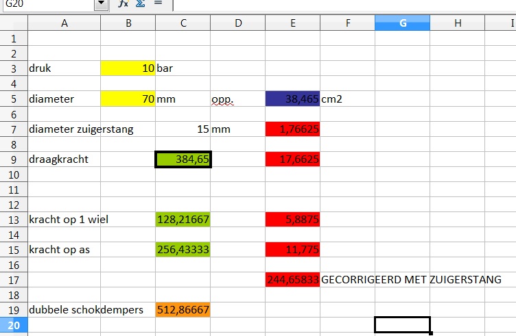

Something around 70mm for the piston.... I did some calculations in Excel and I come to the conclusion that 2 times 70mm pistons equal 1 100mm piston...
Here is the Excell sheet it is in Dutch but that will be no problem for you....
Map1.zip [1.95 KiB]
Downloaded 621 times
You can een substract the diameter of the pistonrod....
Not sure if i completely understand your sheet, but i'm sure you'll get it working.
It looks like there is enough room on the suspension ears to move the Monroes even more out, in case the needed air pressure is to high with the current position.
What compressor will you be using?
