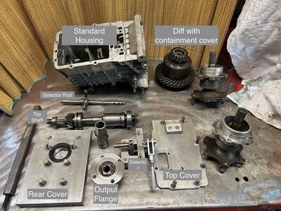

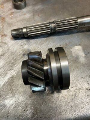

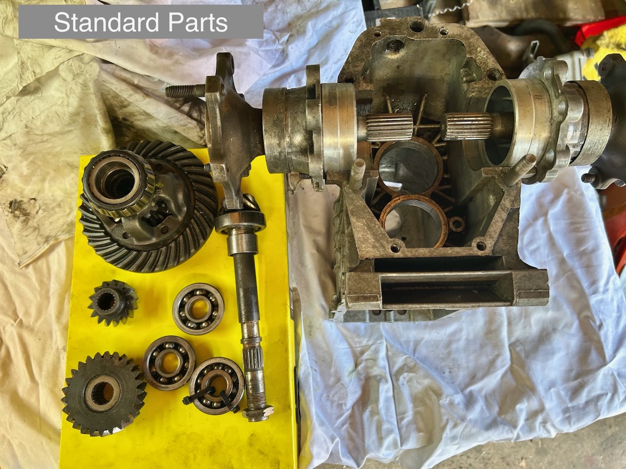

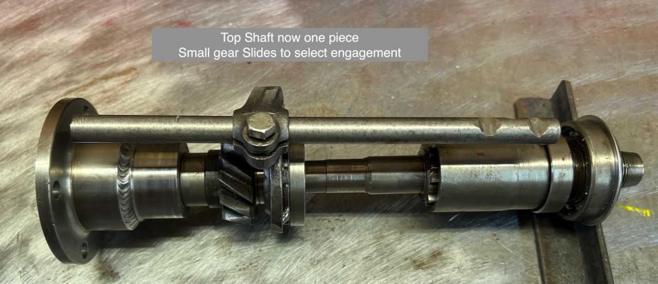

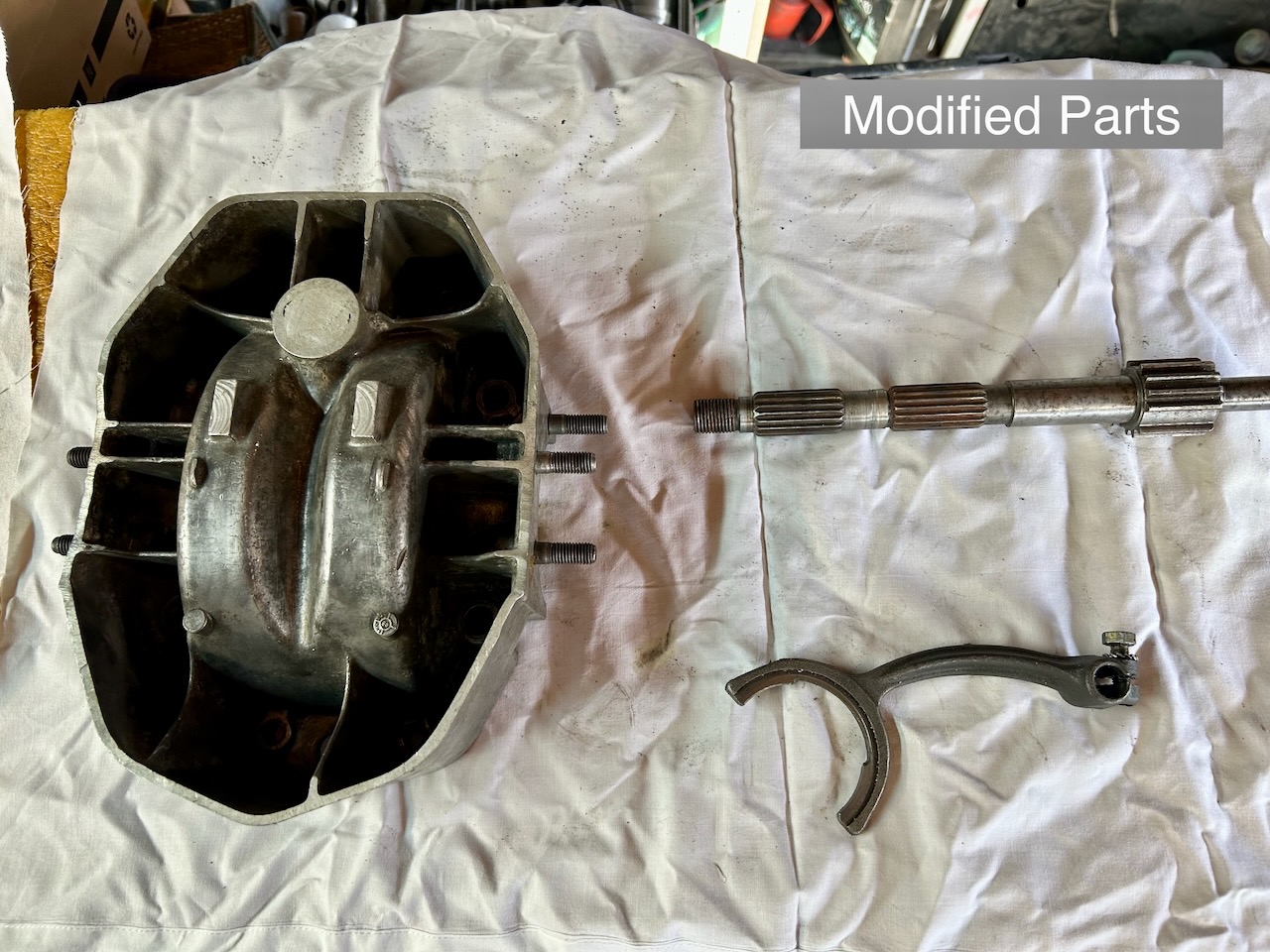

Progressing with building a light-weight Rear Diff with Reduction Gear and Selector.
The prop shaft will run through the cabin.
