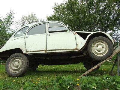

Chassis
To reinforce or not. Big question for many but not for me. My answer is no, why? If the 2cv has a good condition chassis and is not rotten on the inside, it can cope with at times the tuff treatment it’s given. Common sense is that an old rotten chassis can’t handle the stress during the raid and is most likely to collapse. Some raiders are of the opinion that ‘’if I reinforce the chassis, I can get through the raid no worries’’ yes and no. the combination or driving too heavy and fast is a sure recipe for disaster. All you need to do, is to make sure that the chassis is in good condition and that everything is bolted on to the chassis correctly. Make a ‘’bash-plate’’ and fit it under the engine from the front muffler to the front bumper. This will protect your engine and clutch for sand, stones etc. This one was made of aluminium and worked very well.

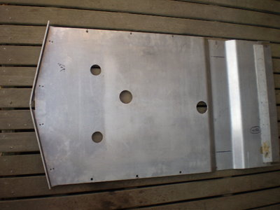

Fuel tank protection
Seen a few different designs. The bad ones touched the bottom of the tank only giving protection from dirt and sticks settling around the tank. If an object on solid ground (stones wood etc) hits right underneath the tank sender, the chock will just transfer straight through the cover plate and force the sender unit upwards. The important part is to have some space between the bottom of the tank and the cover plate. Problem is that small stones have a bad habit of jamming them self in that particular place. One way of overcoming that is to pack the space with foam keeping the stones away. Best is of cause not fitting any plate at all and drive accordingly to the terrain. Plastic tanks are much better than metal + have more fuel in them.
My choice is no plate but you need to take real care when crawling through the landscape.

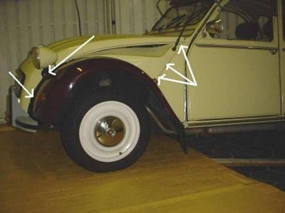

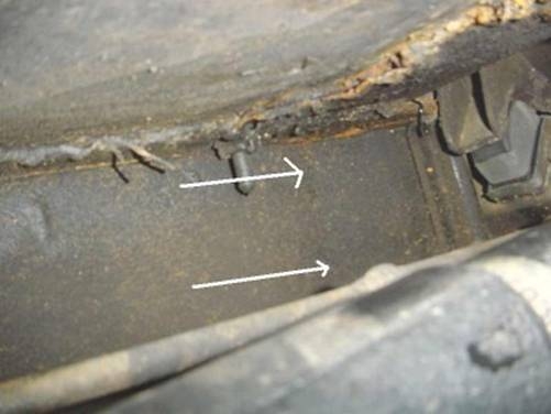

How to inspect the chassis.
2CV chassis are very good at hiding the rust. They are rusting from the inside and out, sometimes with no visible signs.
It can be very stressful to bend a chassis in the middle of nowhere and think that the car will be abandon. That is not going to happen. Check the chassis all over in particular here for a ripple. The side rail should be straight flat running your fingers along side the chassis. If you find a ripple don’t reinforce the side section. It simply can’t cope and is very likely to collapse during the raid. Fit a new good quality chassis and all your worries are gone.
If you see a gap here, the chassis is ''KAPUT''

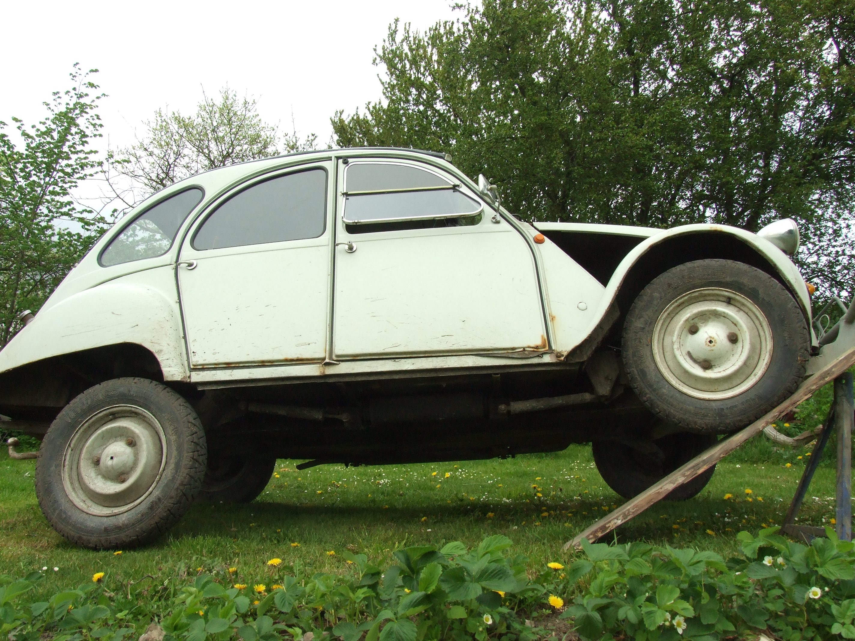

When planing this raid it is our aim, that we should find some of the most difficult roads to travel along.
Roads in the Sahara might start up as a quite OK unsurfaced track, but after a shorter or longer time you may find it difficult to find the track at all, you will find yourself crossing dried out rivers and that can be a task including quite difficult off road driving, sometimes you might have to give up and go further up hill searching for a place with less steep banks.
A 2cv has thanks to its: low weight, low ratio 1. gear and the interaction-system, that allows big independent wheel travel, and (compared to the weight) big wheels, very good off road capabilities.
Meaning that you can pass difficult places rather slowly meaning less risk for damage.
You can improve this by raising the ground-clearance to maximum allowed for a Méhari. Remember to adjust the bump-stops at the same time.
Bigger ground clearance and raised bump-stops also reduces the risk of hitting stones and bending the chassis, if you go to fast-
But you are in the desert and you shouldn't go to fast.
Quitting the front and rear bumpers improves your attack and departure angel. Plus it saves weight+++
A front-buffer with a steel or ALU sheet-metal bending up to the bonnet may help you not getting to much dirt and water into the fan
Tube type bumper like the old P.O. type front bumper are god even though some of the latest were made with a tube that was a bit to weak to use for lifting the car. Be sure to fit it at as high as posible.
This bumper is lighter and much better (stiffer) bolted to the chassis than the standard ones.
Those bumpers sold in the 80. as safari-bumpers are in my opinion to heavy and not proper bolted to the chassis + it reduces your attack-angle,
Don't use to heavy materials if you decide to build and use bumpers.
The interaction should always be kept since it takes a lot of twisting away from the chassis. It is important that there is the right space to the rubber for the interaction-system. This is also very important for off-road driving capabilities - specially when loaded.
Knife-edges and tie-rod ends are important parts of the suspension. They should be checked care-fully for cracks and wear. It is a knife edge- not a plain bearing, if they are worn so that the knife-edge has a saddle to rest in it gives a constant bending of the tie-rods- and one of the parts might brake down, greasing them wont help if they are worn.
The use of bigger (145 and +) tyres does give even more ground clearance. But except for that, and perhaps a better M+S pattern that at some surfaces improves the grip, it won't improve your off road capabilities.
Though bigger tyres allows you to go with at lower pressure without heating and damaging the tyre.Bigger tyres protects your rims better specially when driving with low pressure in areas with both sand and rocks.
But bigger tyres can't guaranty you from damaging a rim.
Heavier wheels adds more stress to the shock absorbers.
The low pressure is a must in sandy condition and it helps a bit on corrugations.
But you can lower the pressure to almost the same level if using 135 tyres. You will just have to be more care full not hitting rocks and to keep your speed low.
Remember You are in the desert so you should drive care full anyway.

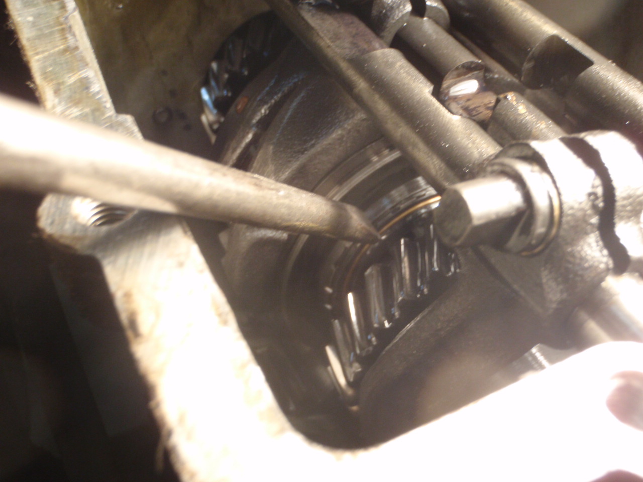

Post Gear box

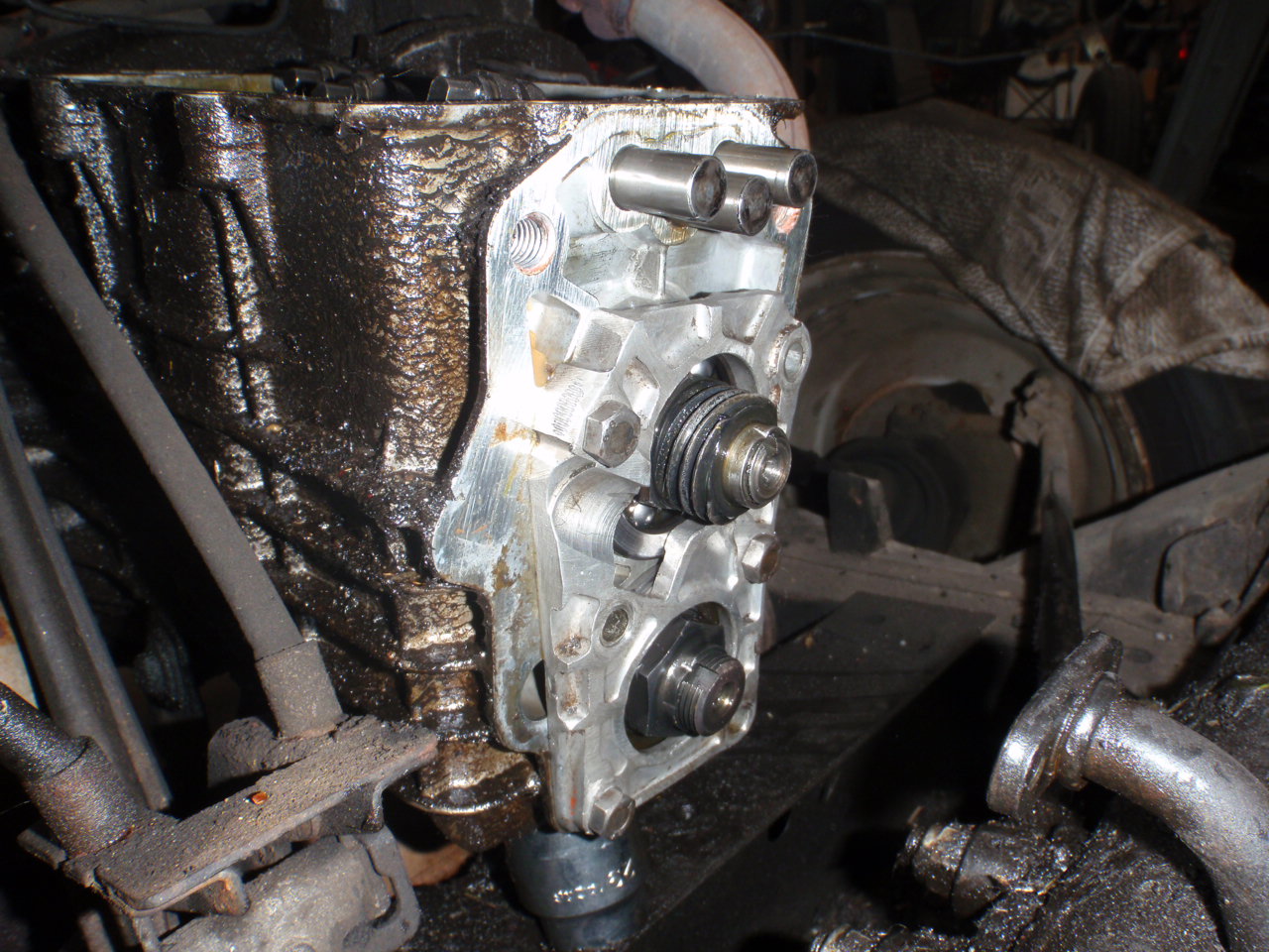

What to do on the gear box. Being bogged in sand is a potential recipe for disaster. It is very important to lock the selector ring on 2nd/3rd sliding pinion and to tie the 2 rear nuts behind the rear cover. If you don’t know how to, have it done by someone in the know.
Apart from that, look at your gear box mount, boot on the gear lever and the 2 rubbers on the lever joint.
Sand is a perfect killer of all metal, best kept away from the gear box. Make sure that the bash plate underneath doesn’t allow sand reaching the gear box and in particular the clutch.
Add fresh gear oil and bring same oil just in case you need to drop the oil.
