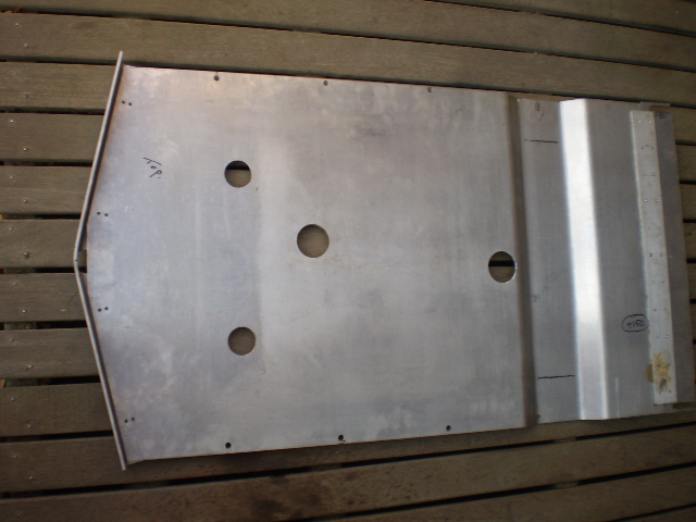

Post Re: Car preparation
this one's we make for some tourag trail drivers
front and back protects.
they look nearly :D

What to do on the gear box. Being bogged in sand is a potential recipe for disaster. It is very important to lock the selector ring on 2nd/3rd sliding pinion and to tie the 2 rear nuts behind the rear cover. If you don’t know how to, have it done by someone in the know.
Apart from that, look at your gear box mount, boot on the gear lever and the 2 rubbers on the lever joint.
Sand is a perfect killer of all metal, best kept away from the gear box. Make sure that the bash plate underneath doesn’t allow sand reaching the gear box and in particular the clutch.
Add fresh gear oil and bring same oil just in case you need to drop the oil.
