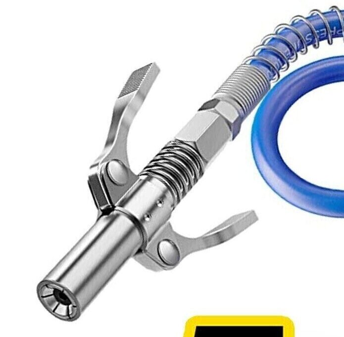

Bought this mouthpiece for my grease gun. It clicks on and there is no leaking grease at the nipple. Works well. only the blue tube is a bit stiff. I used my old one in rubber.

Post Re: AZL 1957
How about a link! :D

https://www.ebay.de/itm/134977048851
this is only one you have to check out the lowest price. I payed 8,50. There are dozens of offers.
