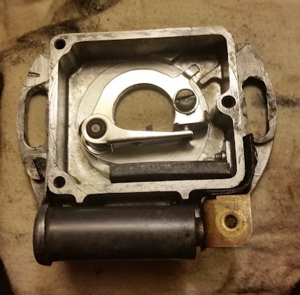

Well that was only once....Yesterday it didn't want to start at all. This morning i did put a sparkplug in the cable to see if there was a spark. When i turned the engine by hand there was a spark. But when i started it with the starter motor the spark was very weak and it missed some. So i took the ignition out and to my surprise both contact points had a coat of oxydation on it... So all out to clean. And with the fan out i did also find my non detectable oil leak i think. Both bolts that hold the oil cooler were wet with oil....So i think there is something wrong there. Let's see if can repair that too.

I did put in the points and clipped the wires that secure the banjo bolts of the oil cooler. I put the socketspanner on to undo them as i just tried to see if they could be thightend.....Of course stupid me, i just forgot to torque them up.....
So gave that a try end put new wires in....
But the car didn't start. The battery was to empty of all that trying en the cold added some more decharge. So i put it on charge....we will see tomorrow.

Recharged battery in the car divers tries...no luck. Changed coil, nothing. I did put the choke back to zero and a little splutter...no start. Took the idle jet out, cleaned. An other try and 1/4 turn and it sprung to life... super. Cleaned out the heating tunnels. So hope the oily smell is gone now too...
