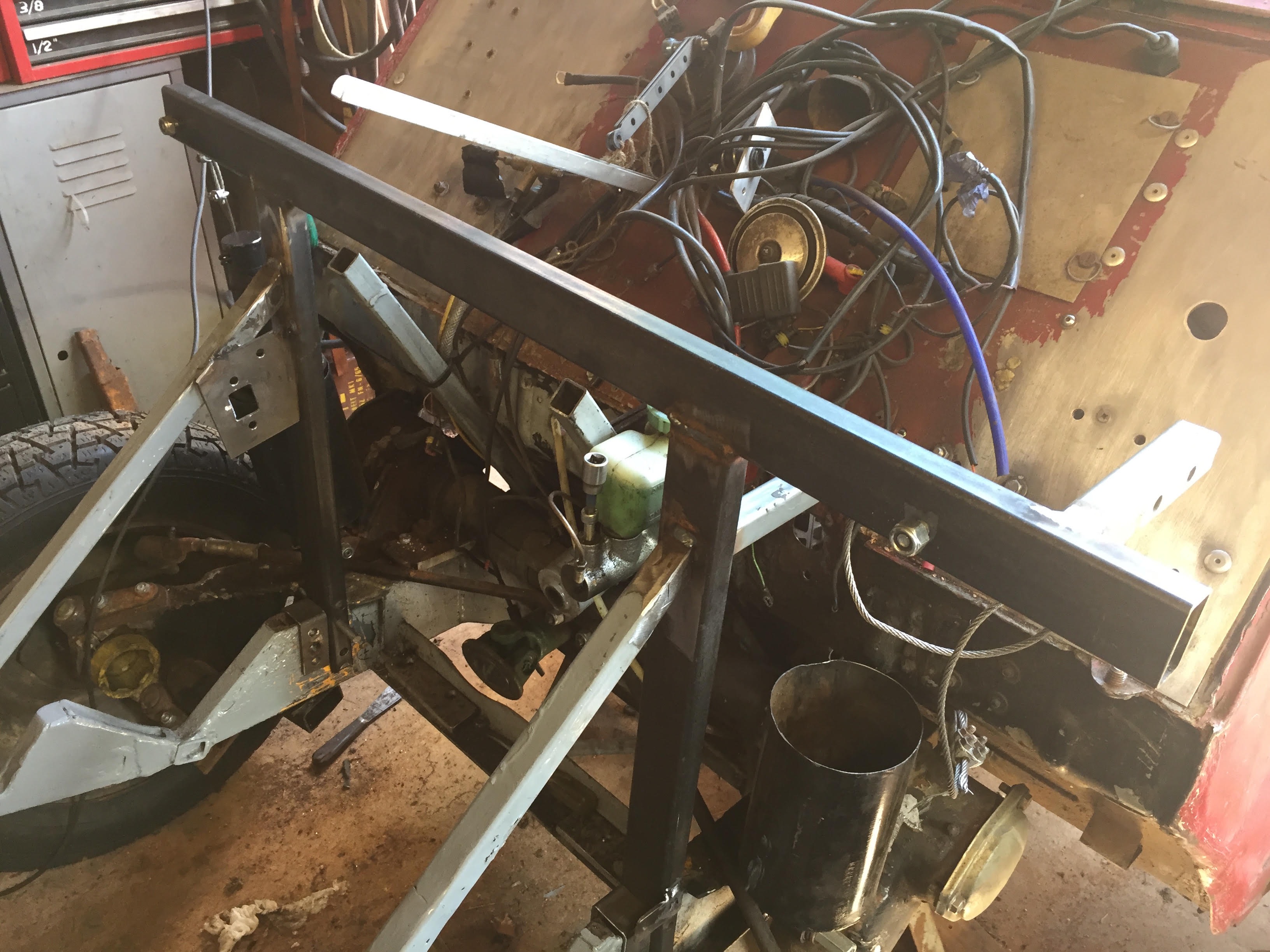

The sub-frame that I fabricated was not upto the job.
The top rail was bending when under full load.
Under examination the strange result is the the rail is now bent Upwards?
Revised Frame Build...
Steel 50x25x2.5 previous was 25x25x2.5
With a plan to add some corner gussets
