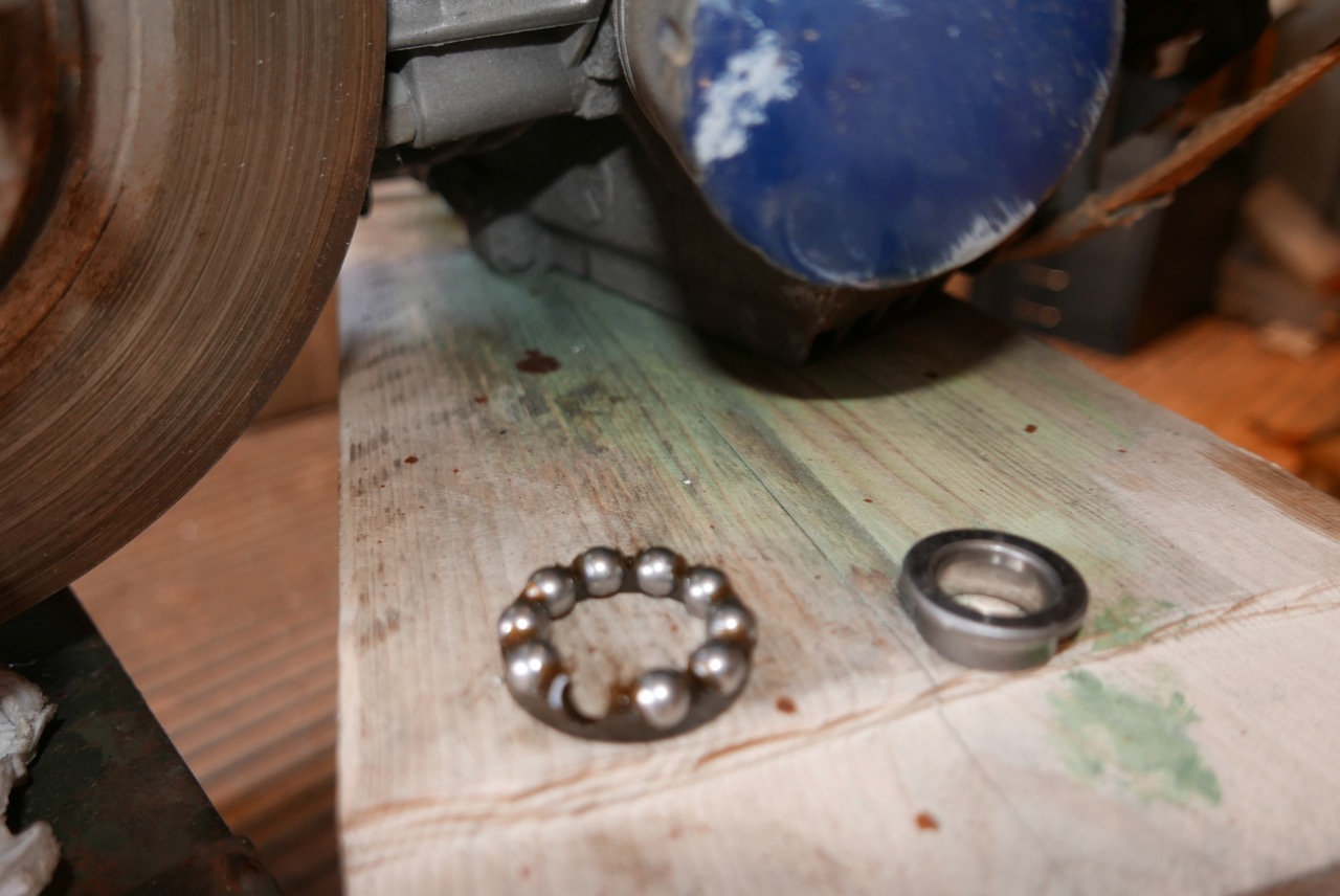

Re-assembled the rear cover with Loctite gasket and then saw the bearing, missing one ball bearing!!!
Dismantled it all to check, all the other bearings are OK :D
The last bearing fits from the outside and is held in place by the oil seal cover. :D
Balls up!

So let me get this right Pete,
you're one ball bearing short of a 2cv 4x4 :?: :)
May 21st, 2019, 7:31 pm
:lol: :lol:
ps
I found it on the floor!
