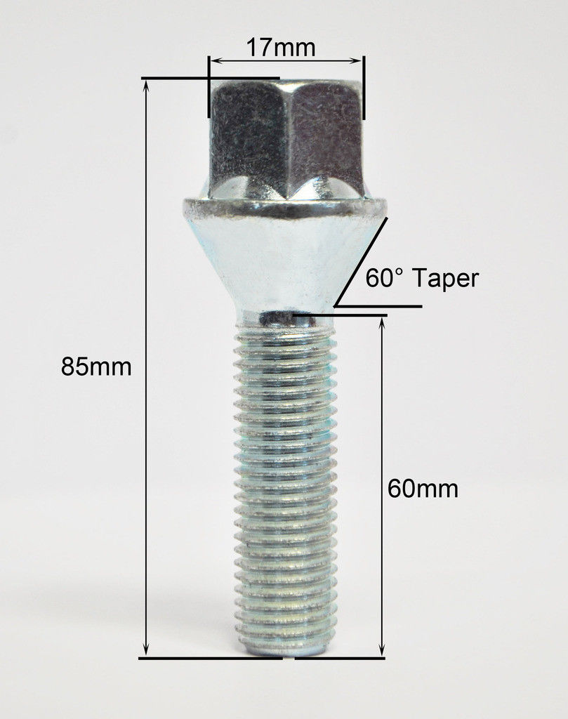

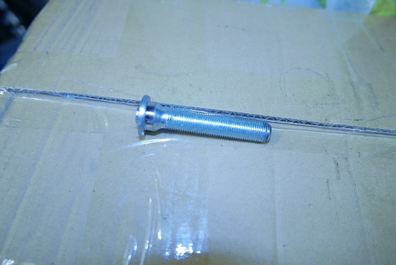

Having larger tyres, reduces the turning circle, so I thought, longer studs and a 10mm spacer would improve things.
Now 2cv wheels studs are different (!) they have a 16mm shoulder, so tried to find some with a 16mm shoulder, no luck.
But an enquiry to a firm that makes studs, came back with a Quote of
£11.25p Each! excluding shipping and vat .
Peugeot wheel bolts are the same thread as the 2cv, so bit of work in the lathe and there we go
£2.05p delivered.
some pics...
Bolt Before.
Bolt After
Fitted (Not yet welded)
