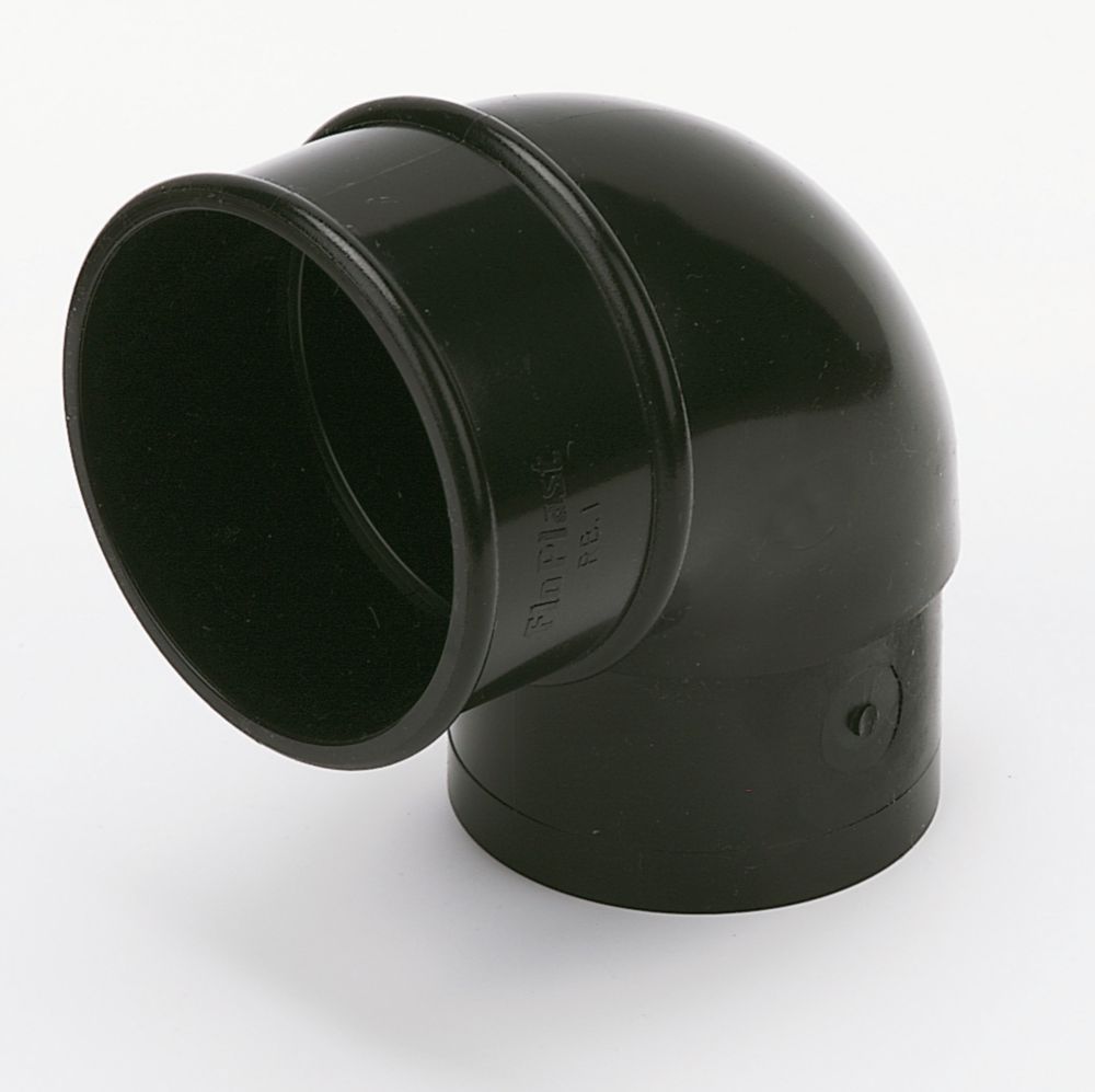

Joolz,
I use these all the time, 2 of them plus a shorter section of the original carboard tube for the driver's side demist run... ;)
Just need a couple of notches cut into them for a better fit onto the bulkhead stub.
http://www.screwfix.com/p/92-5-offset-b ... 68mm/53298
October 22nd, 2014, 11:31 pm
Post Re: Heater pipes/ducts
Ah yes gutter down pipes, why did I think they were the wrong size??

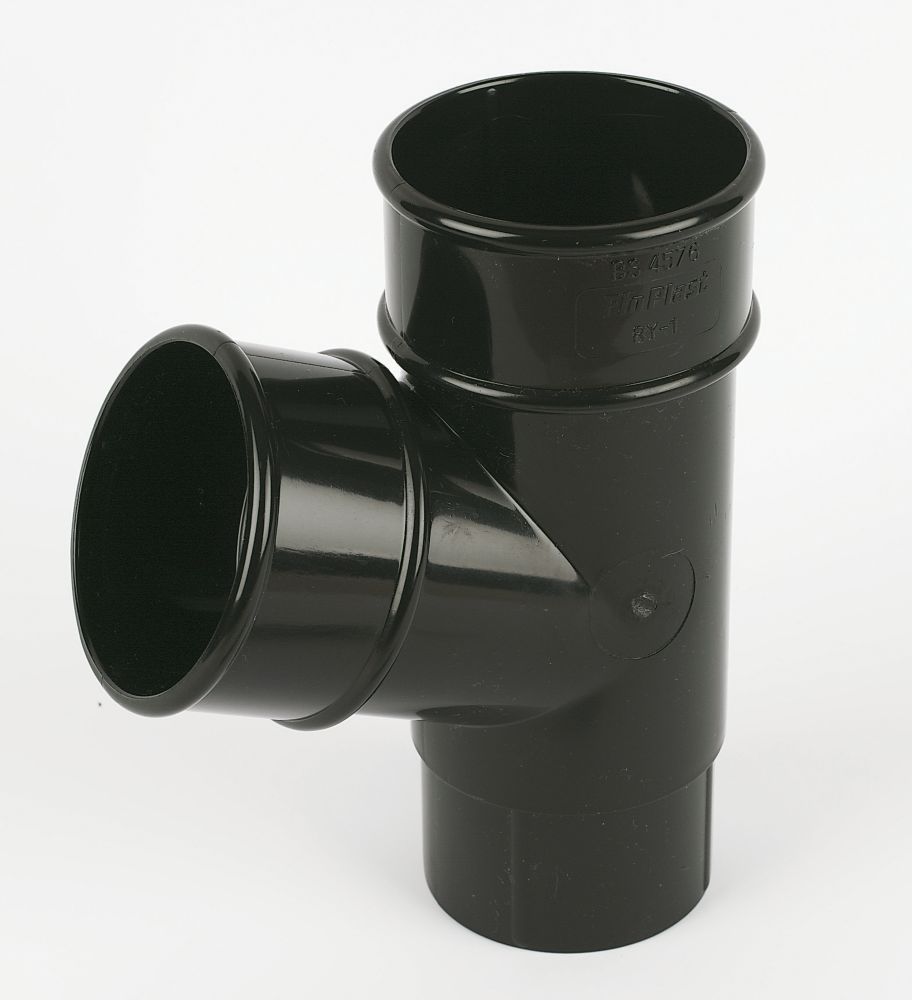

Are the couple of notches to fit them over the seems, have you got a picture of them in situe? Do they glue together with that polystyrene cement used for waste pipes? I'm wondering if I could cut them and join them together to make a junction.

Ha!
See you've already stumbled across the 2 into 1 connection.
That glue is serious stuff, not to be sniffed at... ;)
