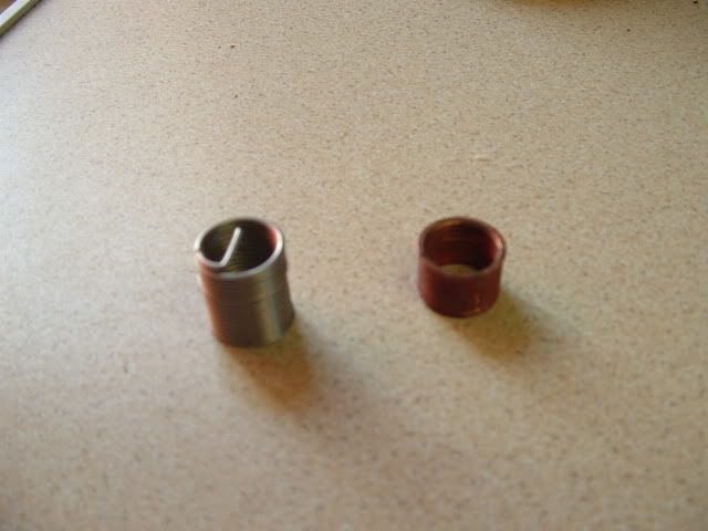

I've had both helicoils & time-serts [sp?] fitted with the head in situ without any probs.
Plenty of grease around the plug hole should stop any swarf from getting into the cylinder bores.
Just for the record ......
.....Time-sert [right] & Helicoil [left].
hth
T.
