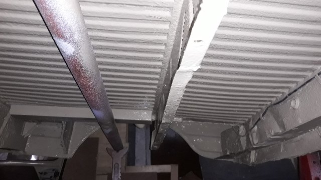

OK, so past week or so, mostly spent lying on my back grinding, wire brushing and chipping the muck and filth off of the underside of the van. Its had some protection in the past and this is 90% intact and where it does chip off its clean, original paint !
The rearmost box member under the back doors needed a wee bit of work to replace a rusted out section, and it will probably need replacing at some point, but, I'm not doing any outside bodywork at the mo so it will do fine for the mo.......(I'm told the "used"look is trendy just now...)

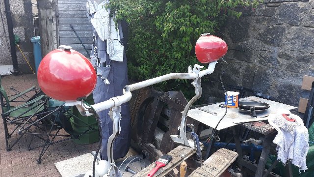

Today, tackled headlamp bar., - 45mm each side..narrow and round, (square and wide safely stored for next custodian alongside 435 and box)...
And hood catch...

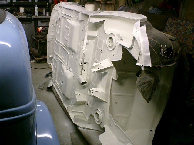

Imageop de kop 2 by geert1953, on Flickr
I did not lie on my back, the van did ;)

Fekity Fek.....on further research, turns out I cut and welded a RHD lamp bar :roll:
So, do I strip it all again, grind out the welds, find my LHD lampbar, and cut and weld it all again.........
OR...
Make a wee tiny L bracket and mount it on the right side of the car for that odd occasion I need to adjust the headlamp aim ???????????

:shock:
I would weld that L bracket .
Who cares.
