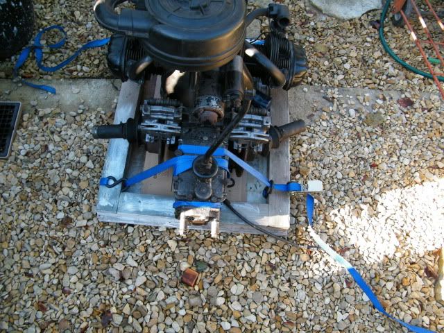

im going to use your idea and strap the hole lot to an upside down palet, so it doesnt jump off and run away!
I copied it from Ken, but it's a great idea! :)
