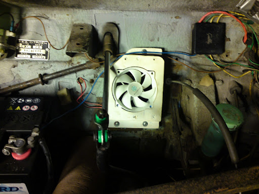

Well the link doesn't work, so here is that I wrote:
"In Denmark, where I live, it is cold in the winter time.
Those of you living in northern France, knows the problem.
I the past, many has used a cabin blower from a GS.
GS is very rare in Denmark today, so I found an alternative.
I have adapted the CPU fan from a computer, and here is some pictures ....
The dim. of the fan is 92x92mm
The housing i made of wood and painted

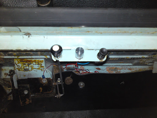

Here is the control buttons. From left: The defroster handle, the speed button of the fan and last, the on/off switch
The only thing you should be aware of, is the capacity of the fan. The Capacity must be more than 120 cubic meters pr hour if it should have any effect.
You can get them up till 250 cubic meters pr hour in size 92x92x35mm, 12 volt!!"
The President of the French Dyane Club asked this question
"Hello,
Can you show us a global pict of your engine place please and more details about your housing. I'm looking for similar solutions but there's not a big place in dyane for a housing like your's. The gear lever may be blocked by this system.
I intend at the moment to place a fan in every tube of heating but it is necessary to me to search how fix them correctly.
escuse me for my english.
Bye"
I replied.....

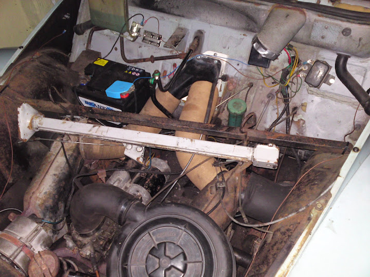

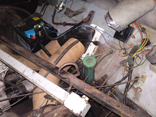

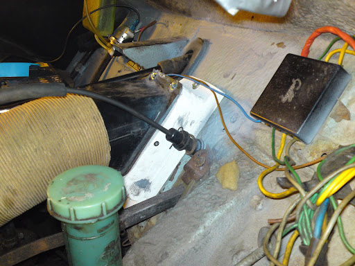

" Yes I can. The space between the gear lever and the speeder cabel, is not big. The hole wood frame is 12x19x5cm (WxHxD) in size
The fan size is 92x92x25mm. If you use a 92x92x35mm fan, you may have to cut a little bit (approx. 0,5mm) of the defroster regulator "lid" to make room for the fan. The wood frame, I have made of 22mm plywood. I used the plastic intake, as a template and then I cut 3 pieces of 22mm plywood and glued and screwed them together.
PS: Don´t be sorry for your English ;O)
Mine is not that good either and my French is worse!! ;O)"
As you all can see, my Dyane has a extra air intake.
That is because the body shell originally comes from Sweden where Dyanes was equipped with petrol heater, located where the spare wheel normally is. All connections to the normal heating system was disconnected and only petrol was used for heating. In the firewall there was cut out two holes aswell, to get as much heat in the cabin as possible to. In a Dyane opposite a 2cv, you only has one inlet to the cabin, which means that less air can pass through.
I've closed these two holes with a metal plate, which I have welded on, but consider opening one up again and then connect it separately via one of the heat exchanger so that air blows directly into the cabin.

I made this on our AMI8... Heat fan is from old GS and I made a new housing for it. Switch is on the dashboard . It helps down to 0 degrees Celsius , at lover temps only for demist of front windsheald.
Up to 80 km/h is ok but when we drive faster engine is cooler and there is not so much heat . But fan is helping anyway.
