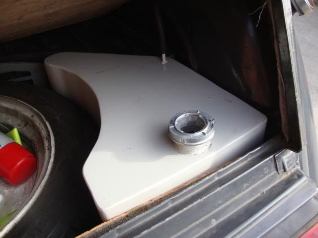

After seeing a pic of an old french can that fits in the corner of the boot I came up with this:

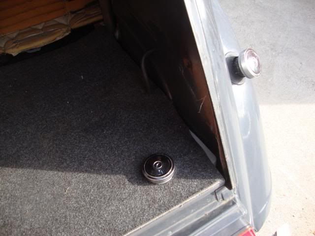

I managed to get a matching pair of locking fuel caps and this is pretty much all you can normally see.
The tank fits around the spare wheel pretty well and holds just over 12 litres.

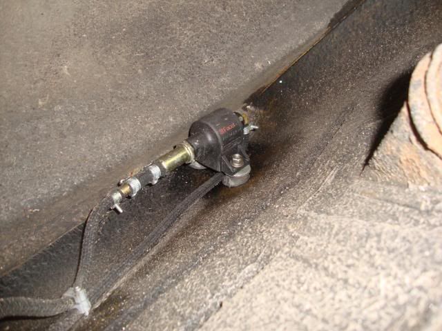

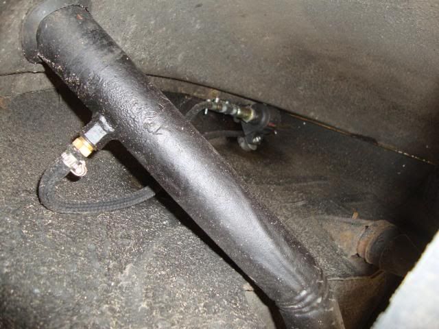

Rigged up a Facet low pressure electric fuel pump right up in the wheel arch to suck the fuel out of the extra tank when the fuel gauge is getting low...
...and pump it straight into the filler tube.

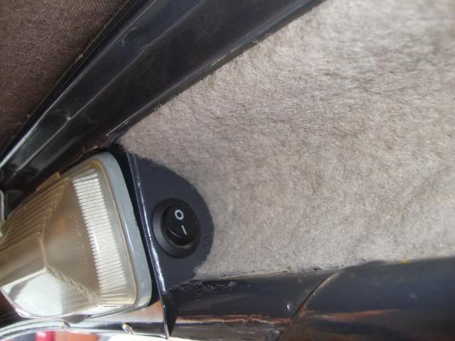

I just flick the switch up by the interior light.
(I can't take any credit for welding the tank by the way. I tried and failed to make one that was watertight so gave the measurements to a friend of a friend who is a somewhat better at such things.)
