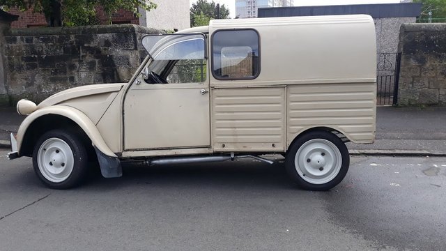

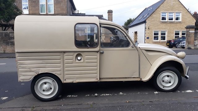

Some lowering......

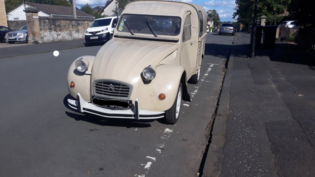

And today........I took it out on the open roads for the first time !!
Went down to my mates place, about 2 miles, to show him the van . Flushed with success and since I was out anyway, I ventured further to pick up the new grease gun I had ordered, (about 5 miles and some motorway ! )
Van ran well, performance is so much better and I can keep up with traffic. Brakes much quieter after the chamfer. Forgot how small the van is when compared to the modern stuff !!
Although its not blowing, exhaust is quite "boomy" when flooring it, quite unlike my recollection of my last 2CV saloon sounded.
