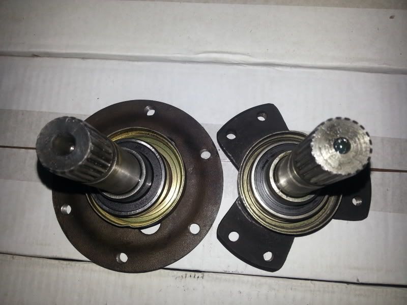

Here are the pics my mate sent me.
Joolz, I like your idea of swapping out the flanges, but how do they come out... are they simply pressed?

:D We like pictures! Yes, the flanges come out easily, They're held in by a locking ring with 2 small angled flats on it. You might be able to undo it with a chain wrench, but I knocked it round with a hammer and chisel. It took a little time, they're quite tight. Once undone it just pulls out, but you'll probably need to hit the back of it with a mallet, or lever it out with a piece of timber.
Citroen quote a torque setting for doing them back up, but what tool you're supposed to use I've no idea. I used the chisel again to 'quite tight' Nm.

You are right Joolz, my mate confirmed that the LN flange would need to be machined down to fit the GS disc.
I plan on fitting the GS output shafts on the LN gearbox, i'll check it out when I am with the gearbox again in a couple of weeks.

I learn't something today...
The Ln and GS gearbox drive shafts are not interchangeable :(
There is the slightest difference in the diameter of the spline...
As I already have the spacers made to suit the GS bolt pattern I will get the Ln flange reduced and drilled to take the GS bolt pattern and adaptor... I just realised if I did drill the actual disc brake, like in the photo, I could then use the the adaptors I have as a simple spacer, 1 bolt through Flange > Spacer/Adaptor > Drive-shaft...
Can you see any advantage/disadvantage one way or the other?
Harley
