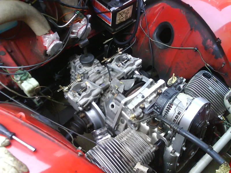

Joolz, thats fabulous, i bought a R1100 engine about 12 years ago with the idea of doing the same, never did it though. What gearbox are you using? the 2CV one? if so you think it will last?

You mentioned it over on 2cvgb about 18 months ago, I did ask how far you'd got and if you had any tips. Gearbox is an LNA but it could do with a 5 speed.

Matt,
place your bets now... ;)
652cc = 33 bhp @ 5,250 & 35 ft.lb @ 3,500
R1150 = 85 bhp @ 6,750 & 72 ft.lb @ 5,250
Considering how many gearboxes the Africar venture went through, using GS engines with about 60 bhp & 64 ft.lb mated to a 2CV box, my guess would be a short but merry life.
Unless Joolz holds back on the loud pedal a little. :roll:

The LNA is a 'G-type' box, I'm hoping it's as strong as those found attached to 4-pots, which is what the belgian racers use. http://i686.photobucket.com/albums/vv22 ... C00236.jpg

Joolz,
a friend of mine, over near Beverley, got one of those gearboxes as well as a Visa engine from France last year for his Pembleton 3-wheeler.
As far as I'm aware, they'd only have been designed to cope with the 652's output, which is why the Belgian racers use GS boxes on the BMW engined racers.
On the bright side, isn't exceeding the 'design torque' the real problem, so as long as you're not doing those rather awesome 0 to 60 times too often... 8-)

Ah yes, you did, memory fails me yet again. dOH!!!
I think you're on the nail there ken, keep torque and really hard starts doen, feed the power in and things should be hunky dory :)

Amazing! i want it!

Joolz you're the man!
i think a "how too" is in order... this could be the new breed of 'sidewinder' we have all been looking for lol... will never sound as ace as a flat 4 but might be more reliable...maybe!
nice work mate!
